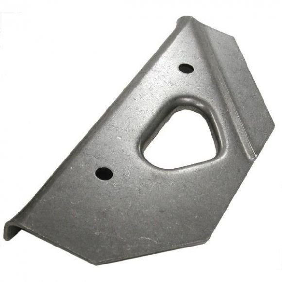

The triangle shaped gussets that went between the frame side rails and the differential front crossmember were added in 64. 64's are easy to identify by the small round hole in the center of the plate. In 65 the gusset plates were changed and the small round hole was replaced by a larger triangle shaped hole. The 64 plates were interchangeable, while the 65-74 plates are different left and right.
The trailing arm bumper brackets and location are different on 63-64 frames from those used from 65 onward.
The "keyholes" were added to the 65 frame side rails, as was the indent in the front crossmember to clear the big block crank pulley.
In 1969 a pair of gussets were added to the frame extending upward from the differential front crossmember to the frame kick ups on each side,
The 68-72 frames are very similar to 63-67 frames and are easy to convert, resulting in quite a few modified 68-72 frames under midyears. 73-74 frames are close too and are fairly easy to convert. 75-79 frames take a little more work to convert, but are far from impossible to convert. 80-82 frames are the most different mainly because of the way the differential mounts, and take far more work to convert making them the least desirable candidate.

Each year from 1963 till 1967 every frame had differences they were all unique. 64 is the only year that changed the design, a frame gusset midway through the year, those Gussets turned out not to be such a great idea the way they were designed with the flanges looking up. They caught dirt and debris, which laid there and didn’t drain out through the holes and ended up rotting out the frames. What I think is funny is people still say that 64 to 67 cars ride better than 63 because of the rubber mounts. Not possible because all 63 to 67 were bolted solid at the radiator support and all the bumper brackets through the body in the front. The Firewall body mounts were aluminum pucks in 64 to 67 bolted solid to the frame. There’s another body mount in the convertibles right under the door that is bolted directly to the frame in all 64 to 67 convertibles. they added the rubber mount to the next body mount in front of the rear tire. The next body mount also is rubber, but the rear bumper brackets are bolted so to the frame solid to the body so there is no movement even with the rubber mounts. In 68 they decided that the rubber mounts were creating cracks in the bodies so they eliminated them and went with aluminum pucks on all locations.

Early 64 frames lacked the corner gussets. My late Jan car for instance does not have them.. There were also inboard body mounts on the rear crossmember beside the drive shaft.. They disappeared by 65. Body never off the frame.. Still original paint.

You are correct, I believe they were first used during April 1964. Even though I think I reread my post a couple times, I probably should have read it once more, because I had intended for it to say "...were added in late 64".
Below is a picture of the 64 only gusset, and the 65-74 gusset.
1964
1965-1974
