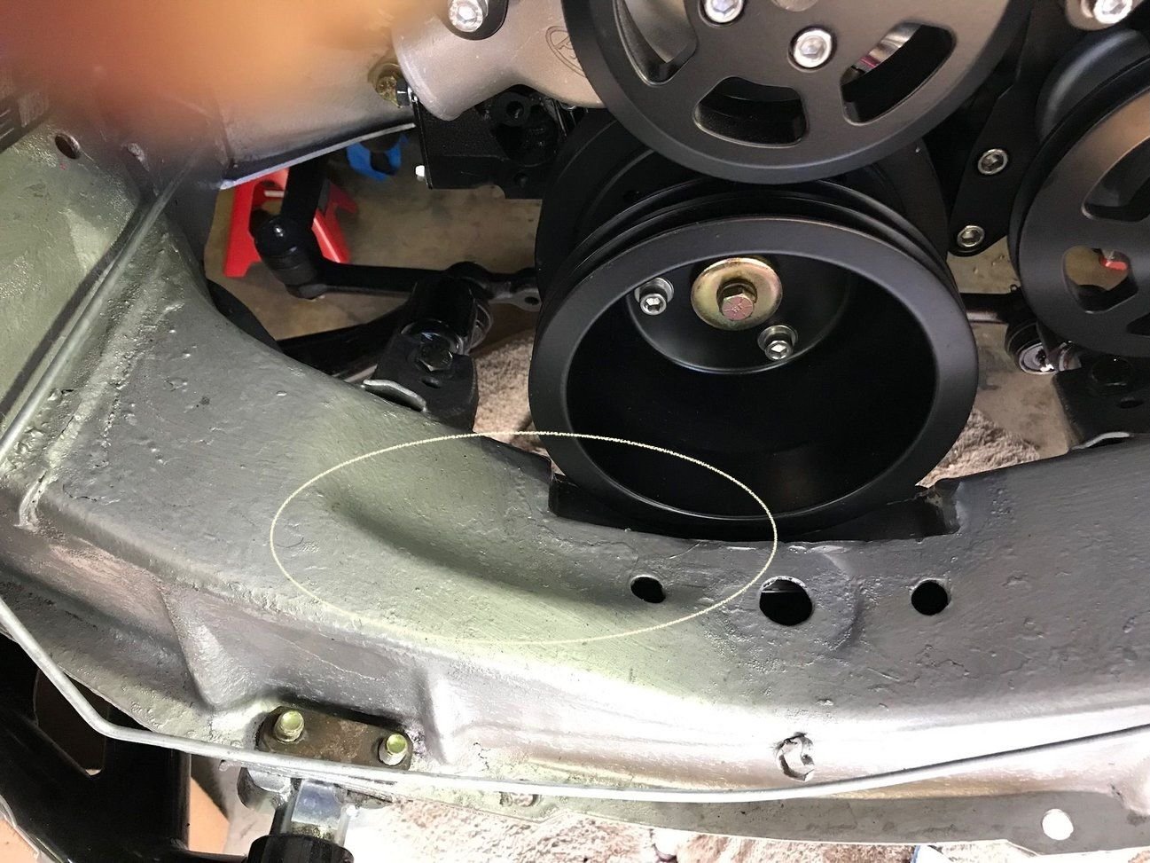

EarIy '64 frames didn't have the triangular gussets at the crossmember where the frame kick-ups are. If yours doesn't have those gussets I would buy and weld them in. You'll already be welding the convertible body mounts, so might as well take another hour and weld in the gussets.
Ted
