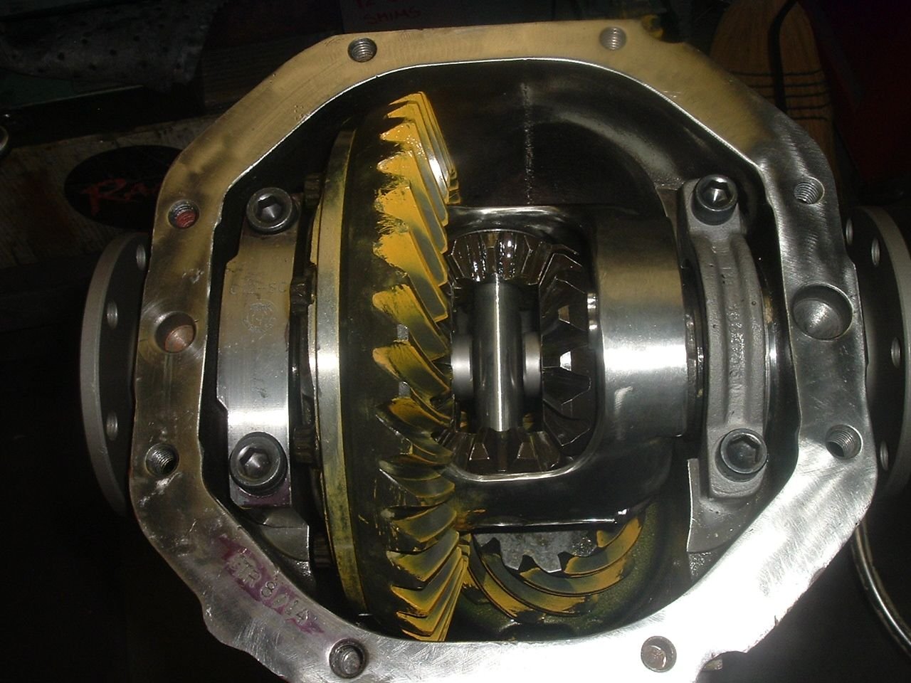

The differential in my 66 is a 3.36 non posi. Rather than having it repaired and upgraded to a posi, I was wondering if it would make more sense to just buy a rebuilt differential outright. There are many places that sell rebuilt differentials, but has anyone bought one and had no problems with it... Where would be a good reputable place to buy one from?

Bob, is the diff broken or you just want posi? Posi is cool but I have built plenty of 63-69 open vette diff's. For a street car, driven on warm, dry days, it won't make a difference unless you want to lite up the tires.
There a many places selling differentials, my advice is to do your homework well in advance of opening your wallet. I often mention the question I used to get at my seminars in Carlisle or CT. At the end I would have a Q&A time, and someone would always ask me, "who would I use if I retire". They were all expecting me to name a few places, but my answer today is the same as it was 20 years ago, "I wouldn't use any of them. I have repaired the work of many of them, why would use them?"
I am not saying you cannot get a rebuilt, exchange differential, but they are not all the same. When the main driver is profit vs time, it can turn ugly fast. The diff should be built to application, not a one size fits all approach as many offer. There are some honest places out there and there are some slick conmen.
Good luck.

It has way to much end play on the side yokes. especially the drivers side. Doesn't make noise or leak.

Just giving you an update on my experience. I got a good deal on a rebuilt 3.55 posi differential that had sat for 10 years. After opening it up to look, we put new seals in it and put it in the car. I was told that the Ford friction modifier was the best stuff to use, so 2 4 oz. bottles and then filled with GL5 gear oil. It chattered going slowly around corners, even after turning several circles and figure 8s in a parking lot. After reading several threads about this, I drained the oil and put in 2 4 oz. bottles of G.M. friction modifier and filled with GL5. End of problem! No more noises! So there is a difference in the type of friction modifiers. As fr as the ratio: I went from 3.36 to 3.55. Not very much difference. Just thought I would pass this information on.

Maybe there is a different way at looking at this problem? I use to recommend this approach when it came to carburetors, 7 circuits are in your typical carburetors do you know how many carbs were replaced back in the day just for a choke problem? So you replace your fine running carb (other than your choke issue) with a rebuilt out of the box unit & now it may not have the choke issue (1 of the 7) any more/hopefully, but now it has issues with the other circuits your original carb didn’t have,\., bogging, running rich, run on when turning key off etc etc.
Same issue could develop with the diff “replacement unit” & maybe look at in the same light as replacing a carb?
If you just want to eliminate the issue with the side yokes & I would deal with that problem ASAP before they start digging into the housing & create bigger repair issue's
send the unit out to Gary he will address repair your current issue & go thru it 100% for any other concerns & you will get it back like new with all the “Circuits” gone over.
I had the same end play issue in my 65 (C2 unit), got unit to Gary & we addressed that & other unknown potential issues with differential, Gary will send you pics/updates & when done it will be better than new..
