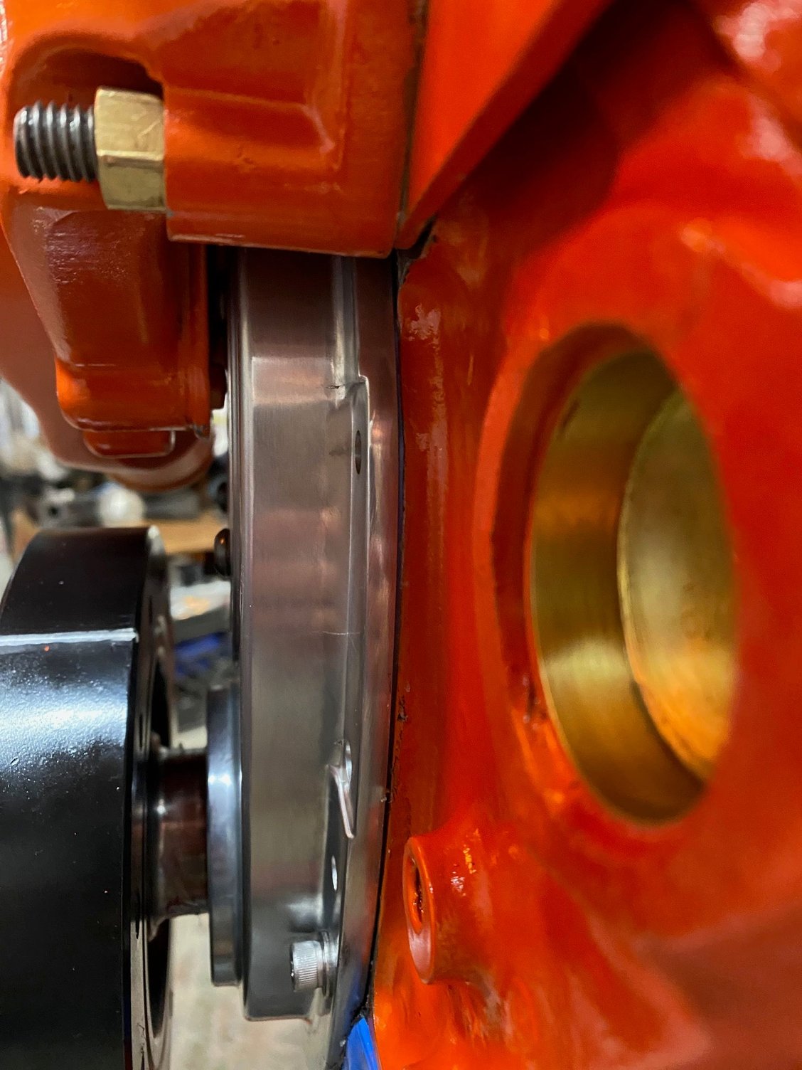

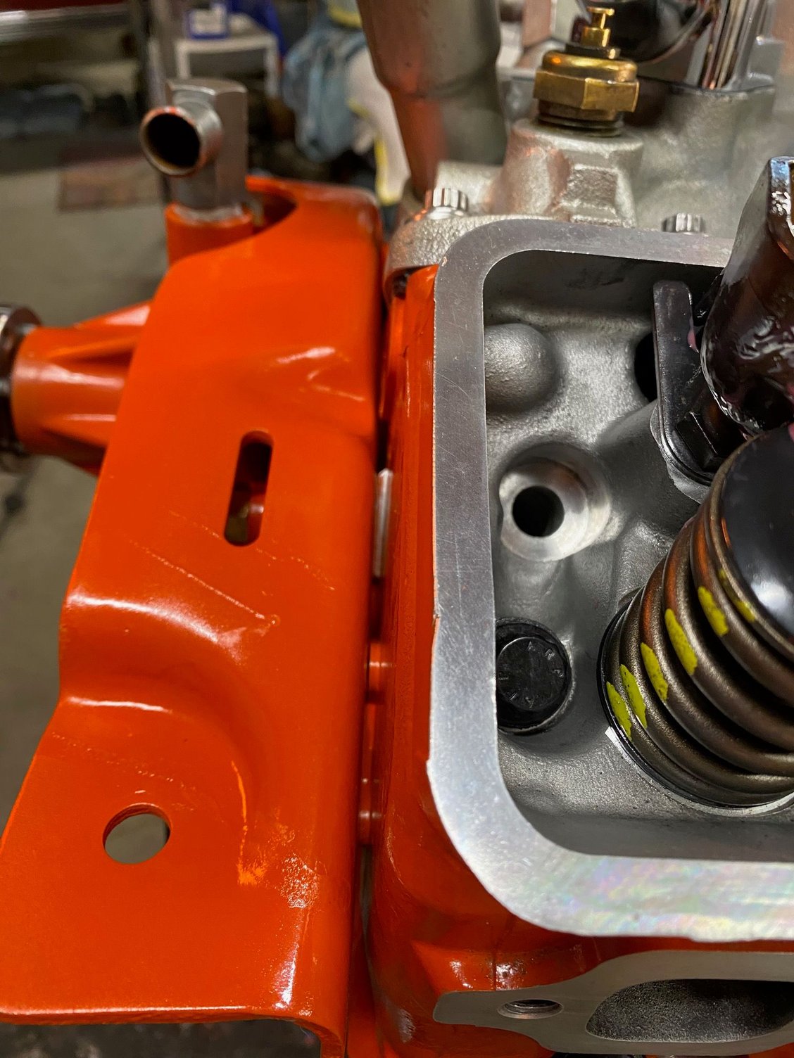

Maybe pictures will help to explain the problem. The comp cam 3 bolt kit with retainer will rub. Now, with the short water pump not so much as a problem because of the front motor mount. I ditched the stamp steel cover and went with a Cloyes 2 piece timing cover with an adjustable integrated cam button. I discovered that the center round plate was rubbing against the retainer as it did previously with the stamp steel cover.
You can see the retainers which go past the bolts which prevented the center cover to sit flush (aluminum and does not flex)
Temporarily, I bought some round head allen bolts to test this and found that the round cover would sit flush properly. I am going to change the three round head allen bolts with ARP 12 point thin bolts with red loctite.
As you can see it clears with the allen bolts and without the retainer.

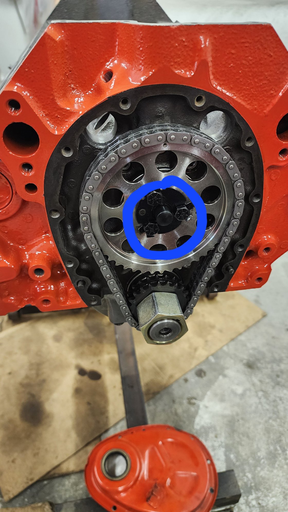

Please show us your cam button. Does it stick out like Scott Marzahl asked? I am following but don't understand your original setup. Here is a pic of my last short water pump build cam button with retainer. JP

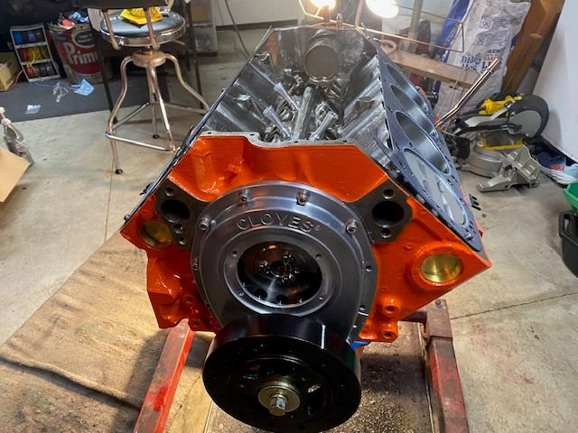

Cam button is integrated in the cover.
I have to say one good benefit of running a front motor mount with a short water pump will clear the timing cover. Right now, just testing the fitment without the water pump gaskets.

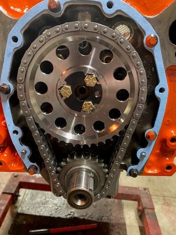

The cover was hitting the retainers. I could see the marks on the back round center cover. It would not set flush too. Now, it does with retainer removed and thinner head bolts. I have a set of ARP thin profile 12 point bolts on order. Now, the cam button instructions says to go counter clockwise until the cam button is fully seated into the cover, install the cover then turn the cam clockwise until it stops using a screwdriver. Then turn 1/8 off of that point to allow the cover to expend when it heats up. Install the set screw on the outer cover.

Thanks. I found the pictures of your original cam thrust bearing setups in your other threads. Was the nylon setup the one that rubbed? JP
Old Feb 6, 2025 | 03:41 PM
jimh_1962's Avatar
jimh_1962
Joined: Feb 2004
Posts: 7,359
Likes: 871
From: Norcal CA
2018 C1 of Year Finalist
The nylon cam button was rubbing but the retainers were hitting the previous cover. Both rubbed... I just did not find the problem when I used the old cover so the engine got pulled.
