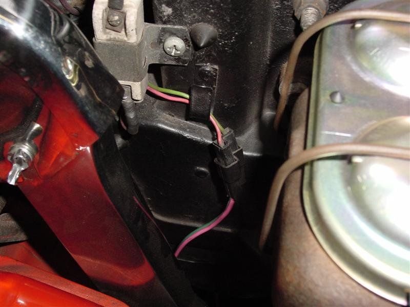

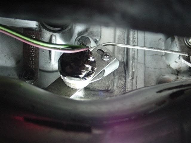

There are a lot of variables depending on your current configuration. If you already have a 4 speed Muncie, it wouldn't be too bad. Let's assume for now that you do. You don't necessarily need a whole harness anywhere. Every 65 I have owned had the two wire connector (unused with no back up lights) with a light green wire and a pink wire beside the master cylinder on the firewall. If you have that, you only need the two wire connector and wires that run back to the reverse lever on the transmission, where the back up switch is mounted. If your car doesn't have that two wire connector by the master cylinder, you'll have to add wires to operate the lights. Either way it goes, you'll need to purchase a back up switch to mount on the transmission, either drill a hole or replace the reverse lever on the shifter to connect the short rod between the reverse lever and the back up switch arm. One way or the other you'll have to get wired from a switched source to the transmission and another wire that runs to the rear of the car to where your current tail lights are. You'll need either a new socket to replace the one you currently have, or you'll have to rewire the current socket by removing the connection from the tail light and connect the wire from the back up switch. You'll also need a clear lens for each side to replace the red ones you have now. (If your planning on adding a third socket in addition to the two on each side, you'll need to cut holes and add the sockets. Single contact sockets instead of dual like the tail/brake lights)
If you decide after reading this that you still want to do it, check to see if you have the connector I spoke of and if you do I can help you with the wiring. All this depends on whether you have the connector, have a stock Muncie, and are adding a backup or replacing two of the red tail lights with back up lights.
