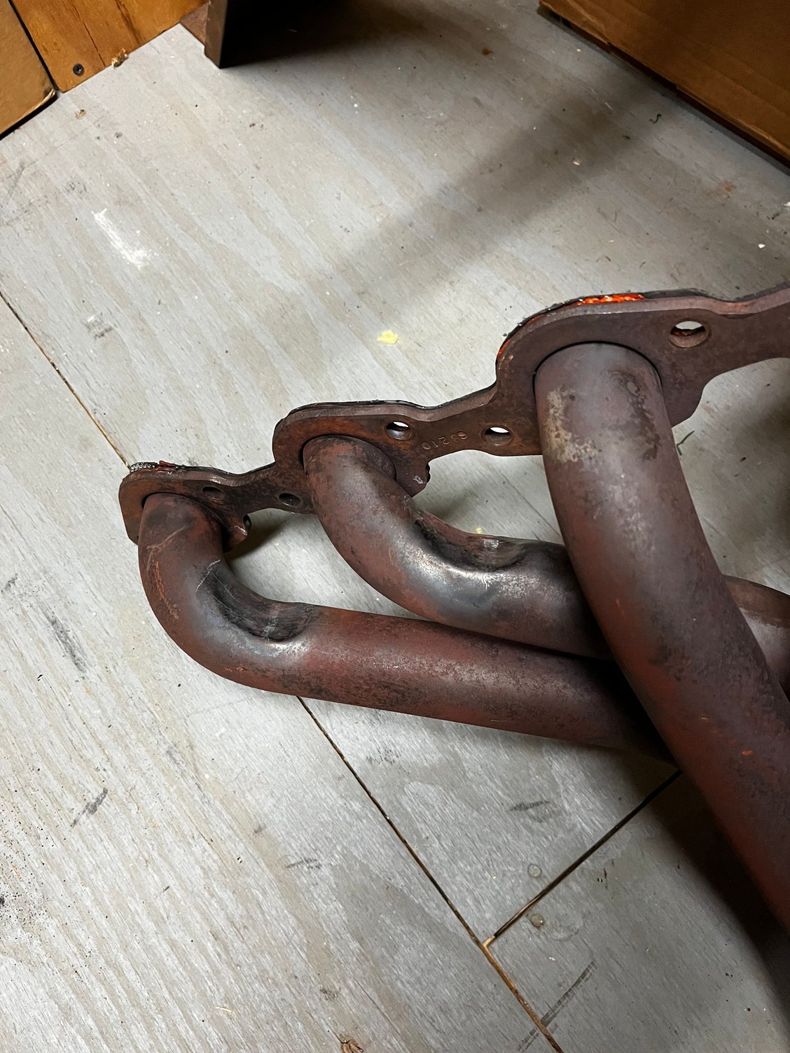

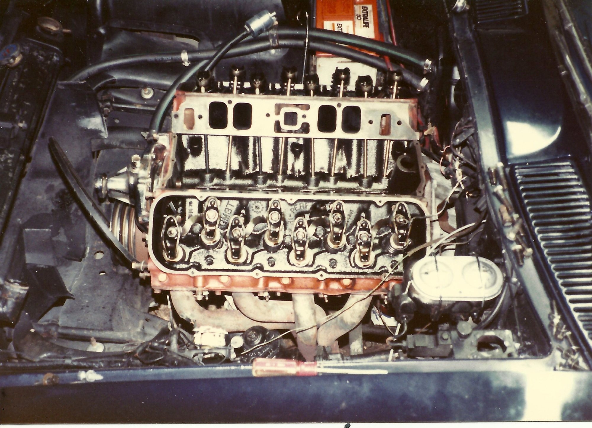

I only had one historical picture of my Hedman's installed.
The others show areas that were dented to clear other parts.
The spark plug clearances were increased when I used them on a raised port head.
The starter would have been a full size, not a mini, which should clear ok.
Hope these help.
Driver side
Driver side
Driver side
Driver side
Driver side
Driver side
Driver side spark plug clearance
Pass side starter clearance
I never thought about the plug wires but I don't use the covers. If it's too involved I won't do it.
Thanks for the pics! They help.
