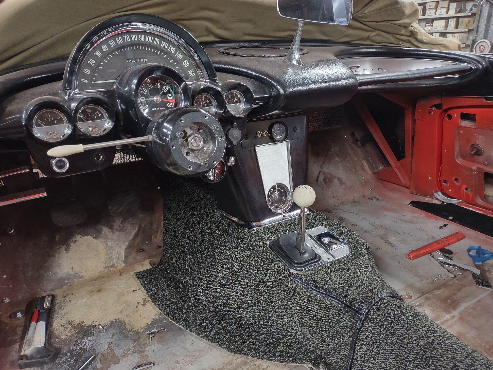

I am sure you could use the factory column but would have to do quite a bit of work to make it work. Cut the tube and install a bearing on the bottom end. Cut and machine the shaft to the correct length for the tube and to accept a U joint. I used the Steeroids kit and the Ididit column was perfect. When installed you can't tell from inside that it isn't factory, well a rivet counter can tell, but most can't. Plus you get later model turn signal switch and hazard warning switch. I left my factory gearbox and column intact as it has some value and somebody could put it back if restoring the car. Just my two cents. Below are some pictures of the Ididit column in my 60.
This shows the hazard switch coming out the right side of the column. I painted it black.
This shows my modification to their turn lever. It looked like the hazard switch, I machined it down in the lathe and painted it ivory. it looks pretty stock. The later turn signal switch is a dream come true and it cancels very nicely.
