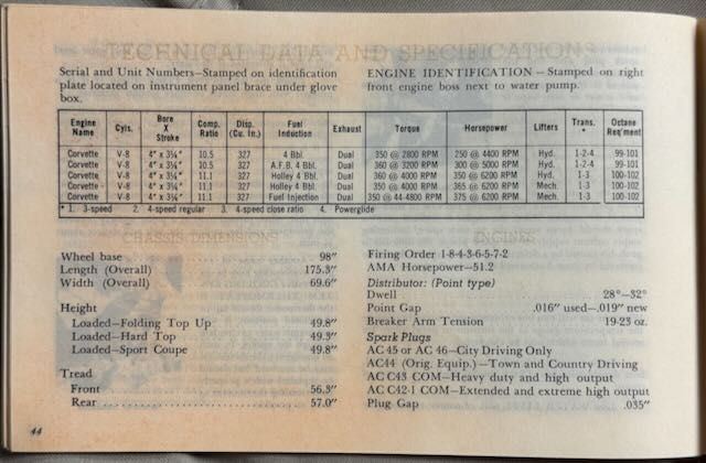

I'm in the same situation as Scooter NYY and came to ask the same question which came up because I was reading the manual and saw that the minimum suggested octane rating for any corvette engine in 1965 was 99. I have a 300HP and the suggested octane is 99-101. I don't ever recall seeing an octane rating that high. Are fuels just better than they used to be not requiring the higher octane levels?
One other question. Do you all use 10% ethanol fuels in your car? I found a Chevron about 15 minutes drive from my house which sells ethanol free fuel for about $1 more per gallon. How big of deal is it to use ethanol free fuel in a mid-year corvette?

they measured gas different back then. if you drive your car regularly ethanol gas will be fine

Today's fuel is PON rated (an average of RON and MON ratings). Back in the day, fuel was shown as RON. You can Google "difference between RON and PON" and have a wealth of reading. Bottom line 93 Octane PON 10% ethanol will make your small block purr like a kitten. You can, probably, get by with the next octane down from 93. Just be sure to drive her as often as possible
