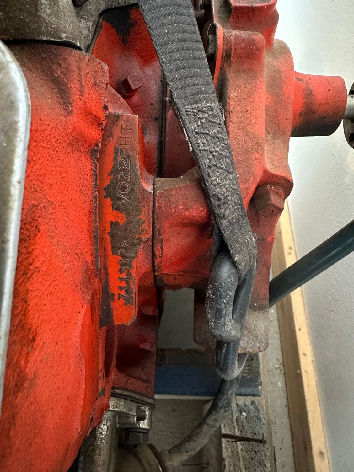

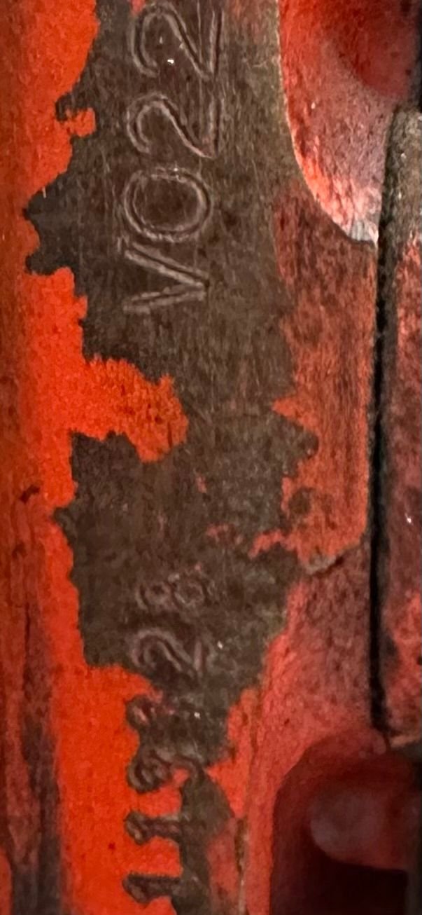

All,
Looking at a 67 convertible. Original engine is not in the car.
What I don’t know is if the original engine is any good…it could be good or it could be “hurt”, but I really have no way to know.
What I am asking for help on:
1. Opinions on the stamp pad? Does stamp pad look ok even thought it is partially covered in paint (argh).
2. Does the engine date and build sequence for the VIN correlate?
Original Engine Number are as follows:
Engine Pad: 7113128 V0228HT
Casting Date: B227
Cast #: 3892657
Thanks in advance for your help.
Pics aren’t great but here they are:

Originally Posted by Crunch527
All,
Casting Date: B227
Cast #: 3892657
Here ya go:

Originally Posted by KingRat
Here ya go:
What caught my eye was the T on the end doesn't seem aligned correctly. Is that something to be concerned about?

Pad should really be cleaned up a bit more with paint removed. USE NO ABRASIVES OR SHARP OBJECTS.
However, from what I see, it looks like original GM stampings.
Larry

Well, it is 111 engines later when the OP's engine was stamped. A tired worker, different worker on the next shift. What KingRat circled shows that the 2nd two is the same and consistent in both photos.
Actually the second 2 is the same in three stamps here. The guy just pulled the 7 out and replaced it with a 8. Also, the last letter in the engine suffix is often out of alignment with the rest of the stamp. The big thing with the stamps when they got to "711" is the alignment of the ones. It looks like an old friend when I see a "new to me" original stamp.

Appreciate the feedback and litigation is not in the cards. Given the consistency in the history and the feedback here, I am comfortable and as mentioned that is what matters.
Thank you forum friends!
However, there are very good "educated" opinions AND a library of '67 stamp pad pictures for comparison. Ultimately, people have to come to their own conclusions.
And you are not going to get access to that library unless you are the owner, and not the buyer, and you have 4 figures plus expenses ready to pay to even ask..
the many decades old patina of that stamp promotes a very strong faith that it is original from the factory. The patina argument is stronger than the stamped characters argument
IMHO
IMHO
I would say the opposite.
Broach marks and stamping are the key elements to validating a stamp.
On my 68 L89, Jon Herrick had pictures of the pad of 3 cars after mine and several before in his database. My stamping had a unique spacing between characters.
This same spacing was seen on the stampings before and after my car.
