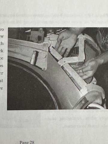

Correct replacement:
Quarters are assembled post Clip fitment. And most definitely NOT cut forward of the hood cowl & bakside vents....

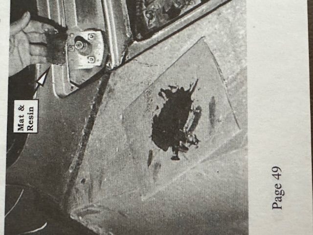

Just posting "done right" without any reveal of techniques other than the little that was posted is remiss. If you leave a panel bond with different substrates side by side, it'll show. If you glue your bond properly, then grind that down and glass over it, leaving a panel thickness of glass in all are areas, then straighten, it'll be fine. Anything less, it'll likely reveal itself. Fiberglass moves, moves with heat, moves with stress, and it's always moving......work with that.

Thats what I meant when I said "done right " Quite often you can find a factory original w/ factory paint and you will see the seams showing through. I have always advised grinding back the seams and glassing over them. I used to work in a Chevrolet body shop and I was the only one that could put up with the "Corvette itch " ! The old body guys taught me a LOT. God bless em.

When a seam shows through, you can be sure it was done improperly. The entire car body is assembled with seams and bonding or backing strips. It's nonsense to think that any seam will fail other than it was not prepped right or bonded right, especially if the joint was assembled using epoxies. They don't fail, period. It's a simple process. Failure to clean, thoroughly sand, and remove every spec of paint is usually the problem. Operator error is the root cause.

It’s no different than replacing a rear quarter panel. It’s all in how the splice/work was accomplished. I replaced a quarter panel on my 66 back around 90 or 91. Still looks perfect. Yes, that was over a factory bonding strip but there is nothing magical about a bonding strip. You can make one of those for just about any repair. It’s more about how you fiberglass in the repair than anything.
