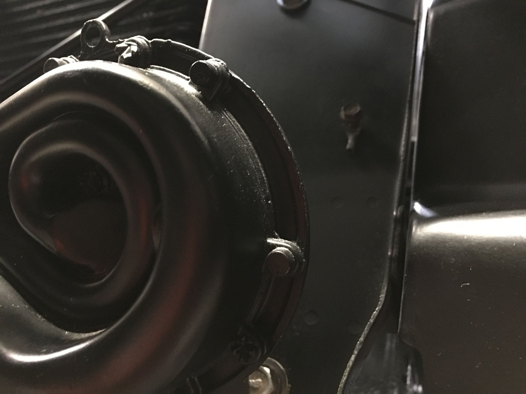

I'm reassembling my 67' convertible project and have noticed what appears to be the remainder of a ground wire (just a sheet metal screw and what is left of a broken wire), attached to the front of the core support just above and to the side of the drivers side horn. Does anyone know where this wire attaches?? Do the horns need to be grounded??

The grounds for the horns are included in the forward lamp harness. Appears a former owner wanted/needed additional ground. I've seen horns grounded that way using one of the screws holding the horn halves together. Again, not necessary if the forward wiring harness is hooked up correctly.

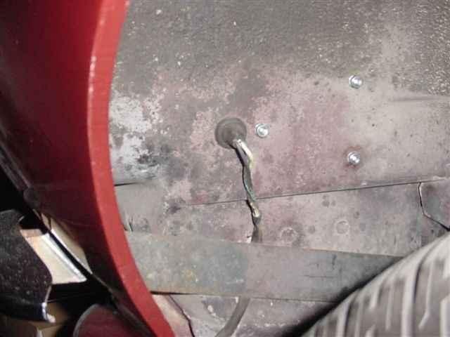

That location may have been for the TI(Transistor Ignition) ground wire from the AMP case, if it originally was equipped.
Are there 3 holes in the DS inner skirt forward area? Where the bolts are shown below.
Below you can see the TI AMP case ground near the same area. The factory had to drill the hole manually so location can vary.
