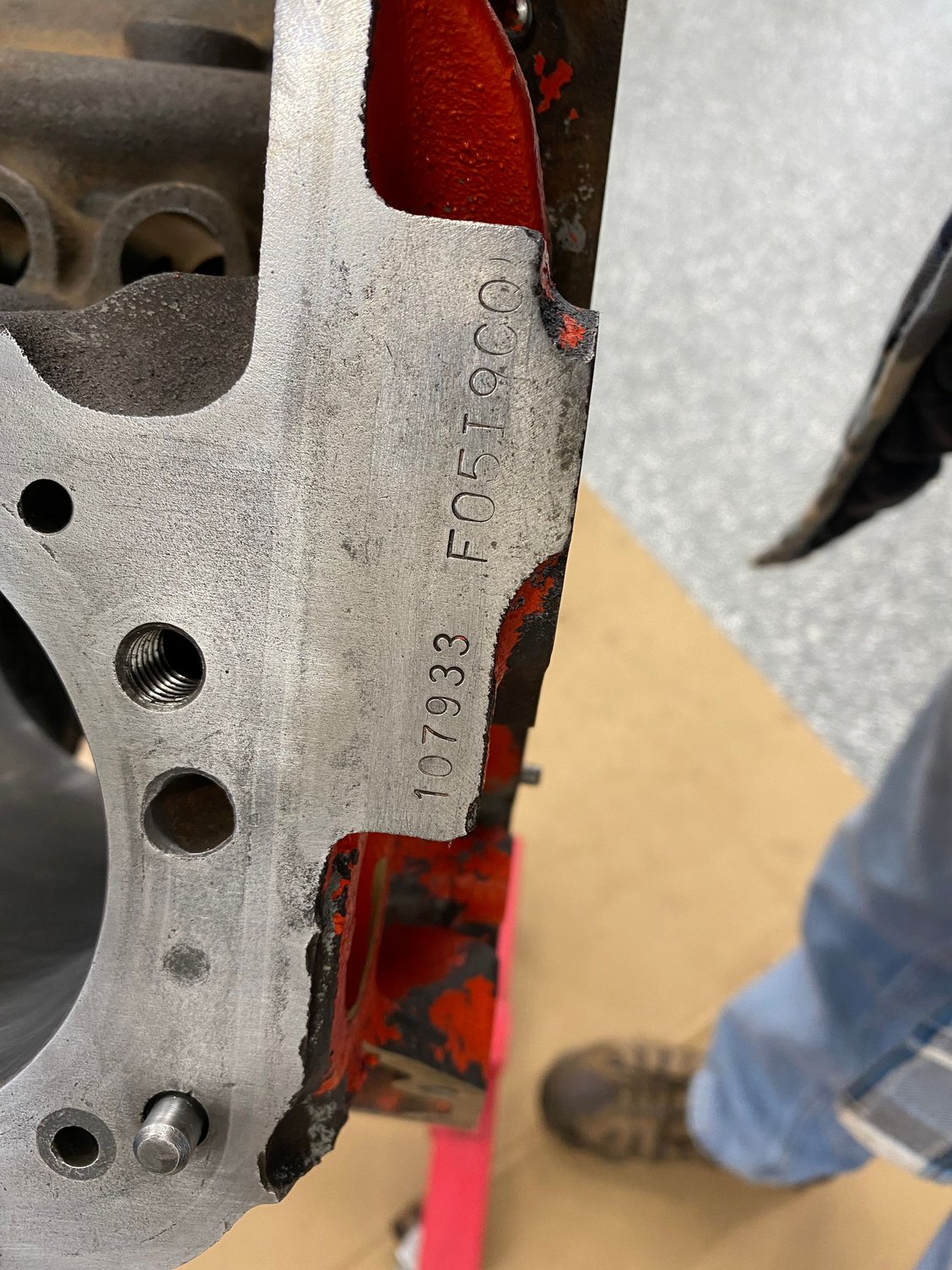

I purchased a 1960 Corvette. I am trying to verify the block's age. The left rear of the block numbers is 3756519. The suffix on the clock is F0I0800 and has the right assy# as the vin with is 00867S103033. The broch marks on the stamp plate on the right front look genuine.
Any help would be appreciated, Dave

I don't see any suffixes that start with O. CQ is a 1960 230 horse with manual trans
Ray
Old Apr 23, 2025 | 04:09 PM
65GGvert's Avatar
65GGvert
Joined: Jul 2006
Posts: 22,141
Likes: 4,156
From: Kannapolis NC
It would be a CQ. 283–230 hp built January 8, 1960.

The "519" is the correct block for 1958 to 1961 283's.

Can't read the Vin, does it match the title?

Would you think that the block has been restamped? I have been told that this car had a full body-off about 15 years ago. The broch marks are there. I'm just trying to find out about the car.
As near as I can tell from the photo, it appears to be legitimate.
Is the engine in it a 283/230 base motor with the correct intake, WCFB carb, etc, as a "CQ" suffix code would indicate? I won't say it hasn't been done, but it's pretty rare for someone to go to the trouble of restamping a block to make a base motor. If someone's restamping a block they usually stamp it as a higher horse power version to improve it's value and desirability.
If it's any help a 1960 283/230 should have intake casting 3746828, WCFB carb # 2818S or 3059S, head casting 3774692, exhaust manifold casting 3749965 (LH) and 3750556 (RH), and the tach should have 5500 RPM redline.

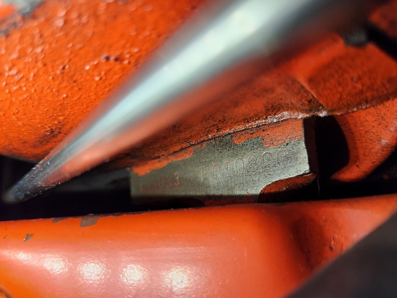

For reference, known 100% original pad. Note how faint the "leg" of the "Q" is.
Note
The engine stamp has the correct vin# stamp on it. Everything else looks right.
Do you have a better pic. of the VIN stamp? For that engine, each digit would have been done individually. A gang holder wasn't used until later. Also, the free hand stamped digits were approx. the same size as the assembly stamp. They were much smaller once a gang holder was used.

All other numbers are correct even the tack redline.
Old Apr 24, 2025 | 11:10 AM
blewbyu16's Avatar
blewbyu16
Joined: Dec 2002
Posts: 144
From: Austin Texas
Having trouble getting a better pic. Asked a friend to bring over his micro camera.

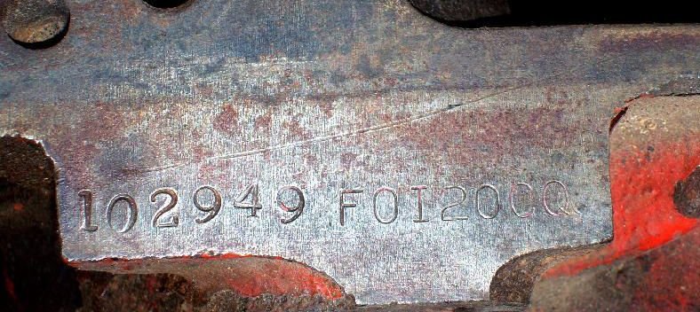

What does the F stand for Flint Michigan?
Old Apr 24, 2025 | 11:19 AM
oldboomer54's Avatar
oldboomer54
Joined: Jan 2024
Posts: 137
Likes: 142
Yes. Here's an original pad a few before the one you're looking at.

Very interesting...when did they change from individual numbers to a gang stamp for the VIN derivative?
Ray
To 1960 Decoding
Old Apr 24, 2025 | 02:22 PM
oldboomer54
Joined: Jan 2024
Posts: 137
Likes: 142
Ray
Approx. VIN #5395 was when a gang holder began being used.
