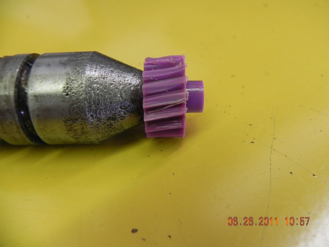

Ray - as Marshal suggested, there are some things you can check first before you pull the cluster, which is a bit involved.
Once you are under the car, remove the cable from the trans and spin the cable while someone inside the car tells you whether the needle is moving or not.
By the way, I'm pretty sure you have to spin it counterclockwise.
If that's good to go, then pull out what most of us refer to as the speedo-bullet. There's a small tab that holds these steel bullet to the tailshaft of the trans
that is secured by a single 1/4-20 short bolt. When you pull out the bullet, there is a plastic 'driven gear' inside and you want to look for wear on the teeth.
Typically that doesn't happen often but if by chance whoever was in there before did not perfectly align the steel 'driven gear' on the shaft, there is a
chance that the soft driven gear could lose some teeth and no more speedo. Happened to my 66 L79 Coupe after I had a few thousand miles on it after
having the trans done. Worked fine for quite some time but then...sheared off teeth.
One last word of caution, there is nothing but gravity holding that plastic gear inside the bullet so when you remove it to inspect the gear, try not to tip it forward
where the gear will drop into the trans.
Pic attached is what I found when my driven gear went away. They are cheap and color coded to correspond to the number of teeth.
Good luck.
