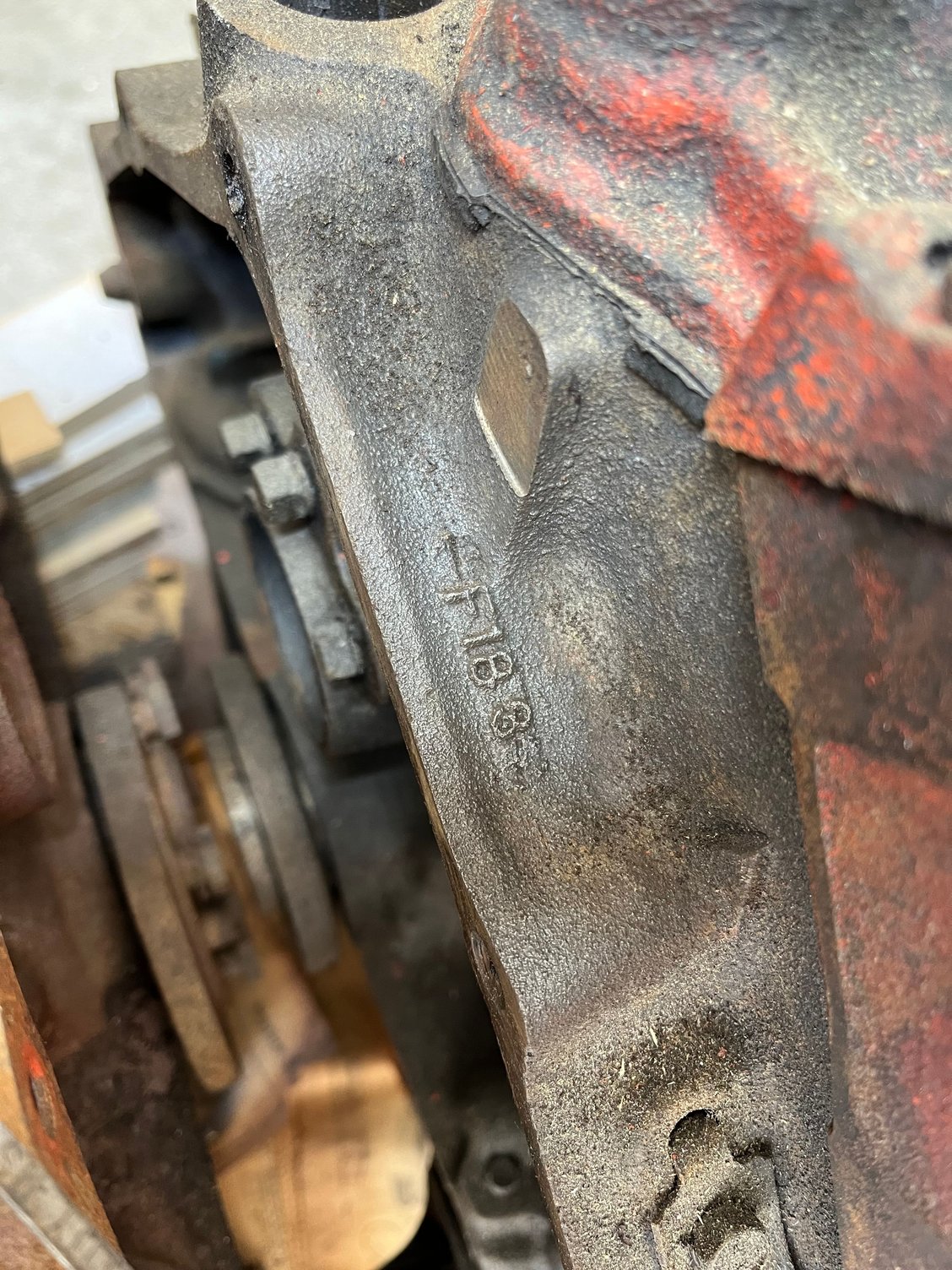

Can someone help me identify what I have here?

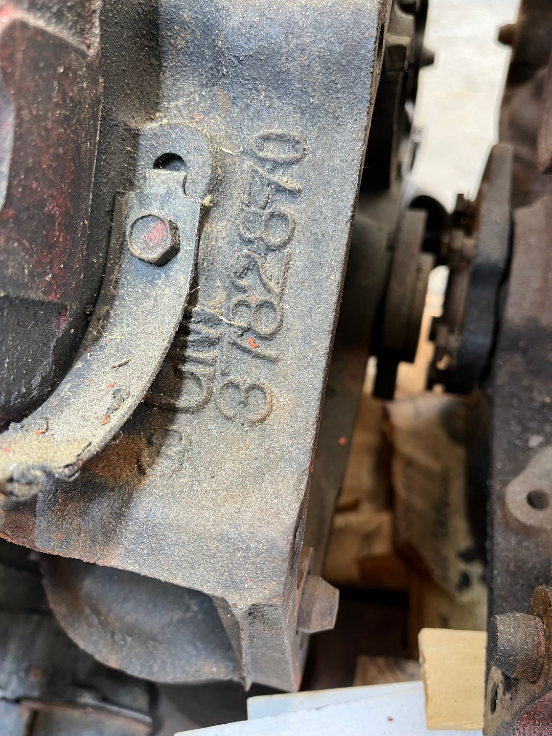

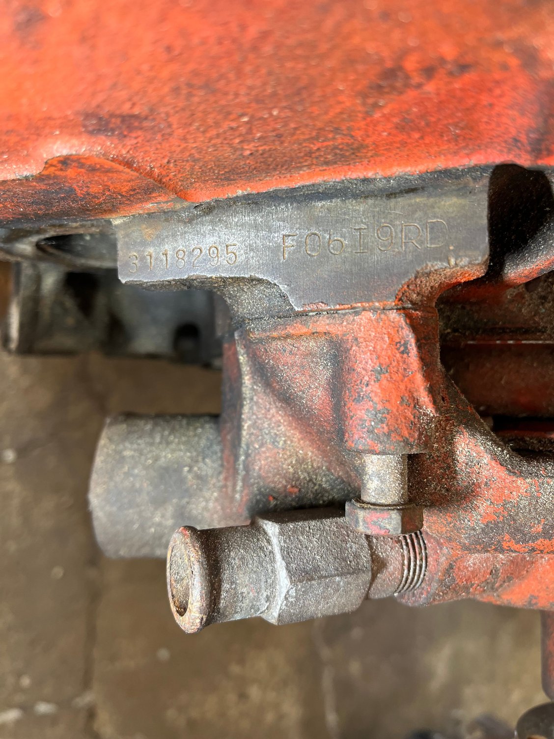

1963 VIN 18,295 built June 27, 1963
RD = 300hp w/ Manual Transmission
3782870 = 1963 casting number 327
Casting date= F 18 3= June 18, 1963
Assembly date = F 0619= June 19, 1963 F= Flint

I'm not so sure #18 295 is long gone. I have it recorded but the only information I have is that it's a coupe.

FYI- The owner/previous owner had posted VIN 30837S118295 back in 2017: CLICK HERE
Unfortunately, he hasn't been online at NCRS for several years now.
Perhaps others may know if hez still with us, and has the car.
