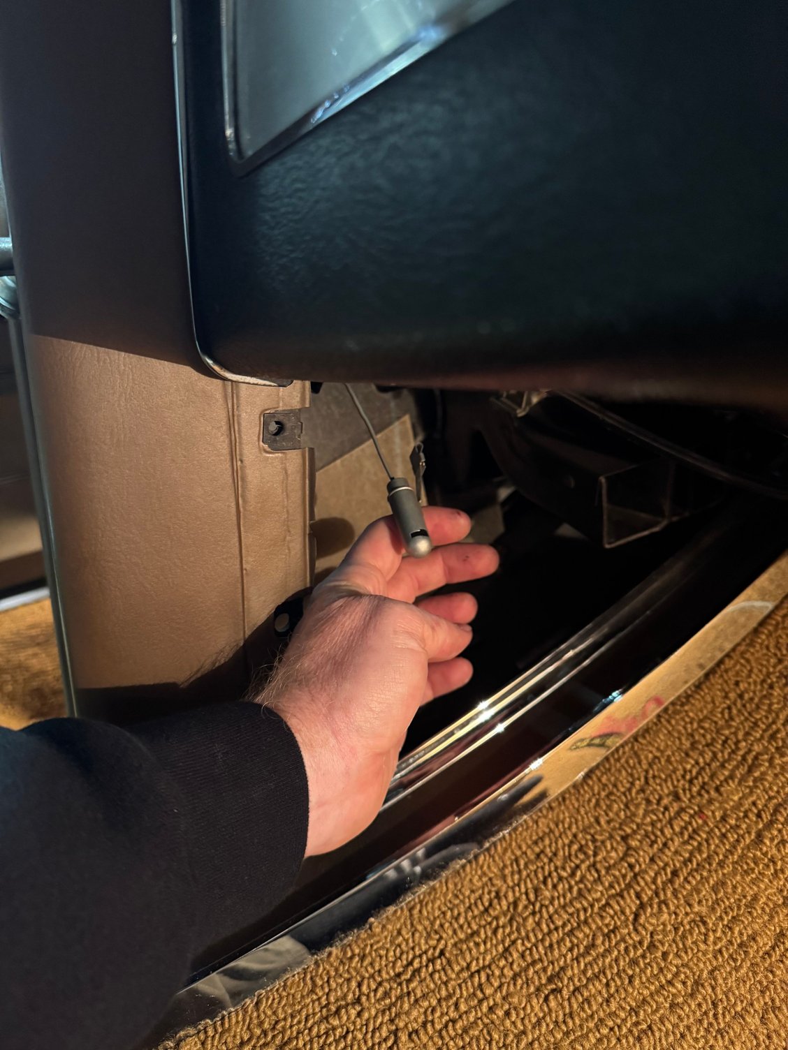

I’m doing some work on my clock, when removing the side panel, I found this dangling light in the center console. This is from a radio delete car. The clock had both lights plugged into it so it’s not from that. Any thoughts on where this light should go? Perhaps this light was meant for the radio that’s not there?

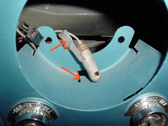

Mounts in the slot in the bottom of and BELOW the clock housing marked by the orange arrows. It's supposed to light up the bezels, but it barely does even when right.
Yes, this is the winning answer. Thank you especially for the illustrative picture, it made it very obvious where this light goes.
