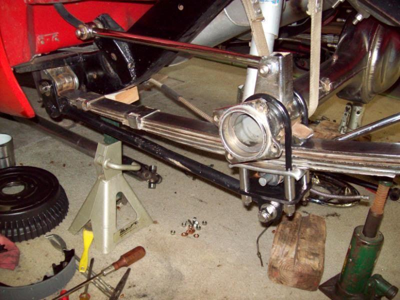

Also, 56-62 Corvette axle housings are a pure bolt-in swap-----------------sorta.
In 59, factory traction bars were added (radius rods). Thus, a bracket was welded on both sides on the top of the axle tubes, out near the brake backing plate. This was for attachment of the radius rod to the housing. The radius rods were std on ALL 59-62 Corvettes. Then, in 60-62, a rear sway bar was added. But the bare basic 56-62 axle housings are a bolt-on swap.
SOOOOOOOOOO, my question, does that axle housing have the brackets on top for the radius rods? Only 59-62 axle housings will have these brackets welded on, as seen below.
