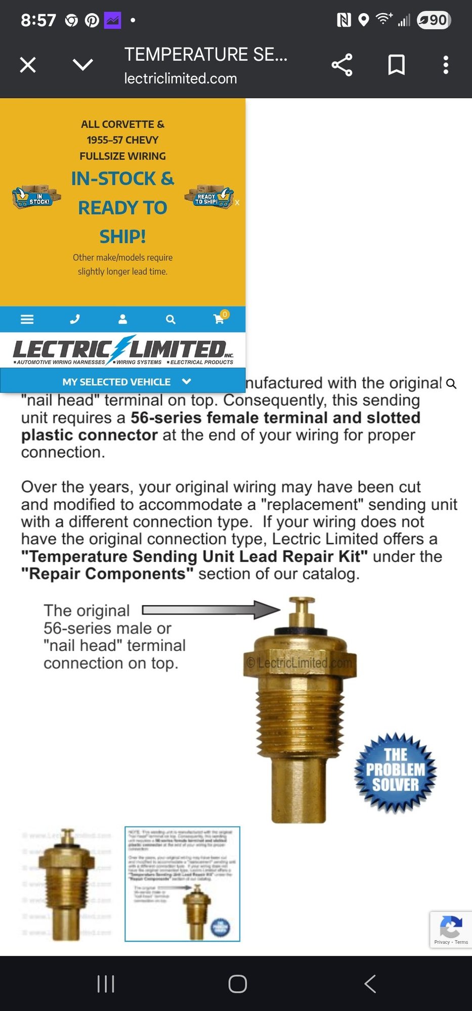

In addition to the above, Lectric Limited claims their sender is correct.

Both Dan and Scott have given you good answers. I have used, both, the Auto Zone TU5 (what Dan meant to type) and the Lectric Limited sending units with success. It is still a bit of a crap shoot.

The Lectric Limited sender is the one to get. It is accurate. I installed one on my 65 and it is correct in the reading. I tried 3 or 4 from all the parts stores and none of them were correct. And the LL was only about $28 too.
