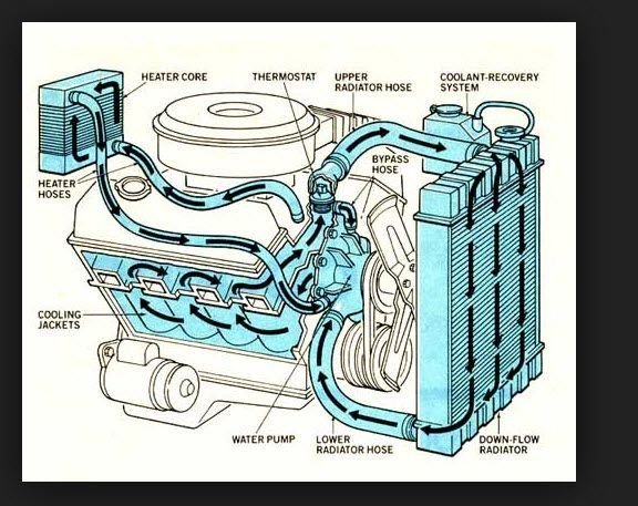

Old Jun 3, 2025 | 12:49 PM
sunflower 1972's Avatar
sunflower 1972
Joined: Sep 2016
Posts: 2,228
Likes: 981
From: Wauconda IL
This illustration should help visualizing it.
Old Jun 3, 2025 | 03:53 PM
Whatscooking's Avatar
Whatscooking
Joined: Jul 2022
Posts: 579
Likes: 210
From: Southeastern Indiana
I was worried that it might need to circulate but mine stays shut off most of the time and it holds 180.
