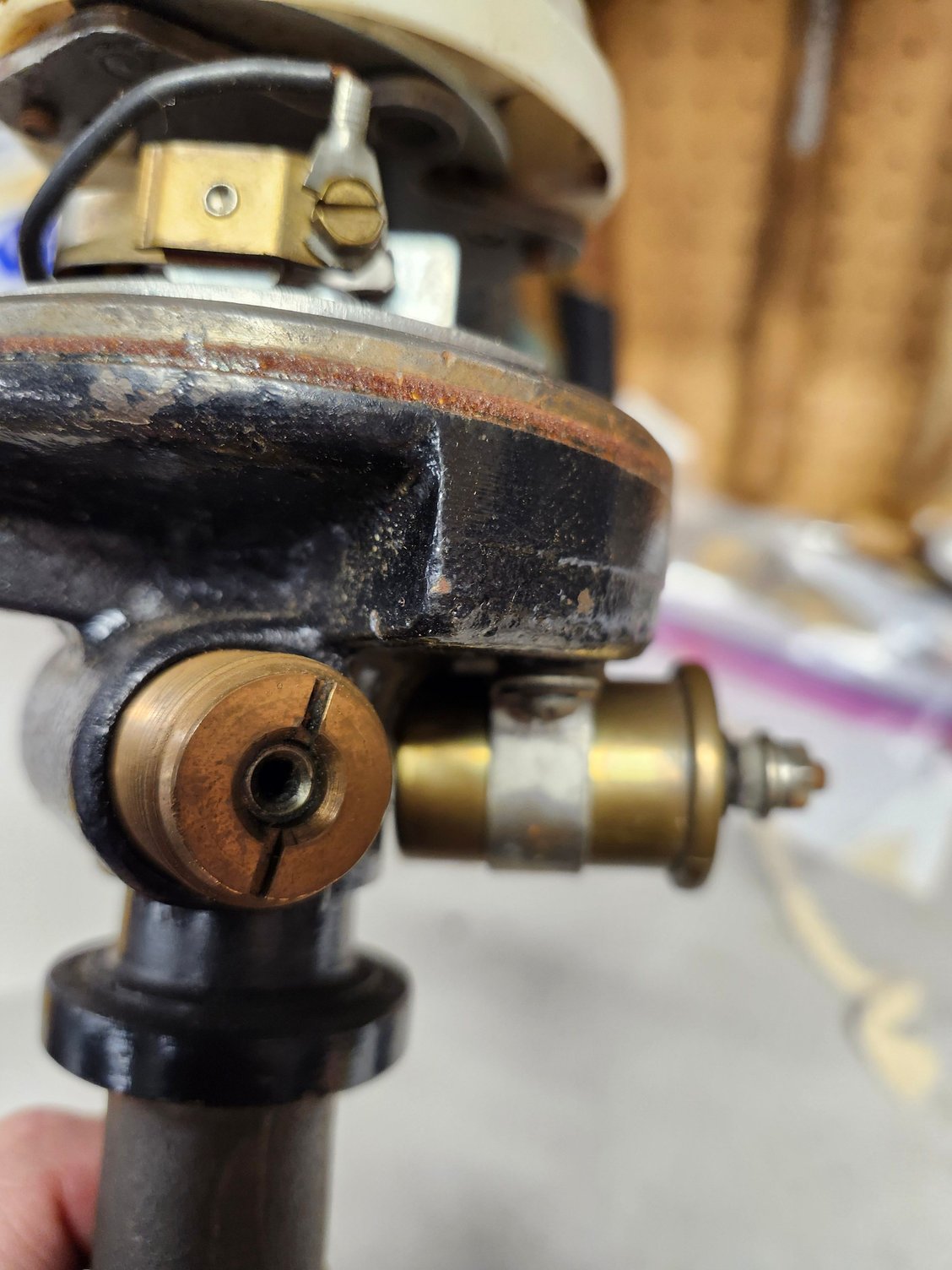

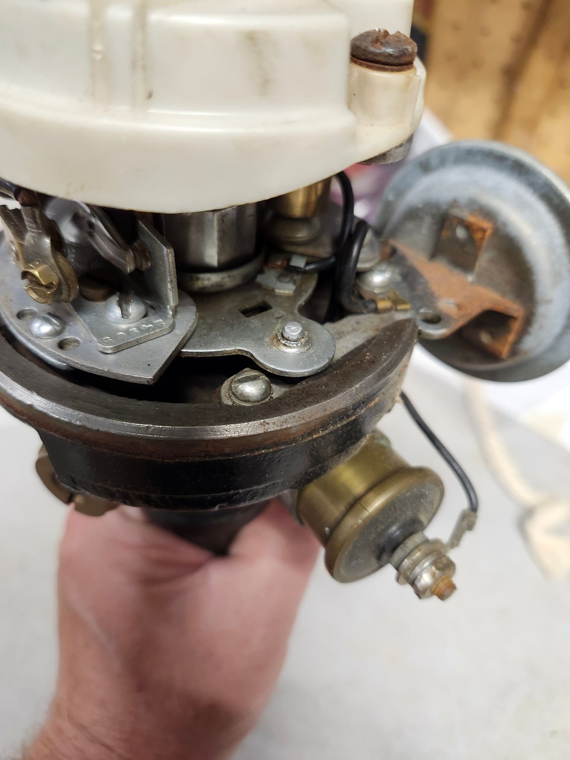

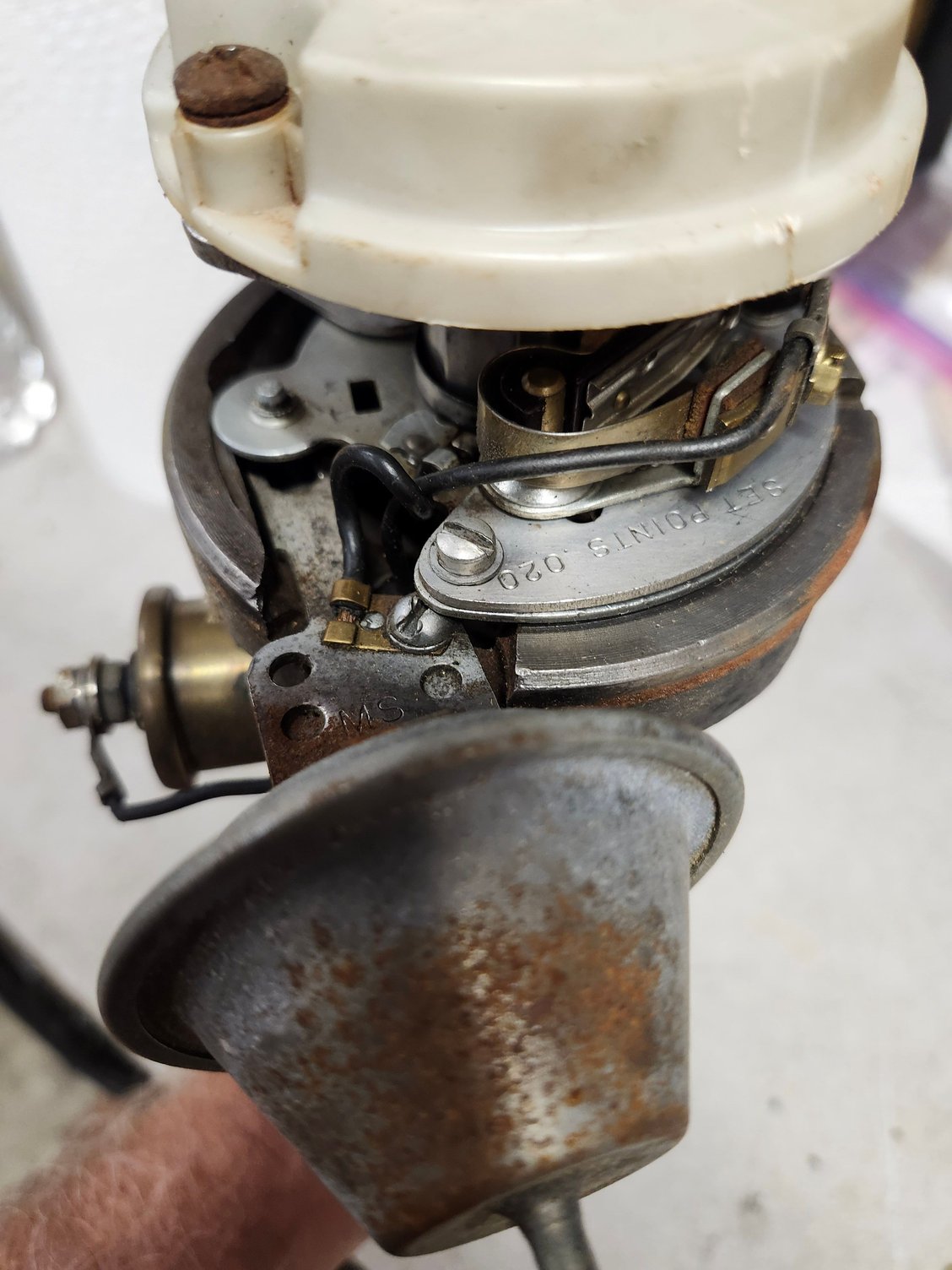

Old Jun 6, 2025 | 04:28 PM
terry82's Avatar
terry82
Joined: Jul 2000
Posts: 6,664
Likes: 162
From: columbia city in
Old Jun 6, 2025 | 07:51 PM
plaidside's Avatar
plaidside
Joined: Apr 2000
Posts: 5,103
Likes: 1,362
From: New York New York
That appears to be a single point Corvette distributor that someone installed an aftermarket dual point set-up. It could be a Mallory kit buy the looks of the large external condenser.
Those are not the standard externally adjusted GM points. They look like they are from the dual point C1 fuelie distributor.

do you think its 1961to 1962
Old Jun 6, 2025 | 11:04 PM
barkingrats's Avatar
barkingrats
1967 Pedal Car Champion
Joined: Mar 2020
Posts: 9,130
Likes: 4,242
From: US-PNW
Originally Posted by plaidside
TIt could be a Mallory kit buy the looks of the large external condenser.
It looks to me like the points are stamped 24905 which is a Mallory part number. Additionally, the 25590 plate number is a Mallory dual-point conversion kit.
Can't be a '61 as '61 distributors did not have a tach-drive connection. Can't be a '62 either because, although they had the tach-drive, '62 didn't have the machined cut-out for the vacuum advance canister. One of the things about Corvette distributor housings from '63 to '74 is that they are universal fit and appearance. The shafts, plates, weights, etc. are all interchangeable, so anything could end up inside one.

Old Jun 7, 2025 | 10:36 AM
terry82's Avatar
terry82
Joined: Jul 2000
Posts: 6,664
Likes: 162
great info . i now think i dont have any thing special.its a Mallory conversion kit .but it does fit a corvette.thanks to all for the help .the knowledge and wisdom here is amazing
