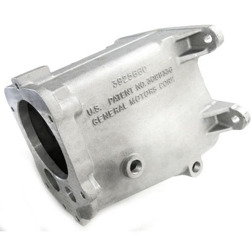

As far as a 4sp tranny in 66, ONLY, ONLY, ONLY the HD M22 got a drain plug.
The 1in cluster shaft was introduced in late 65-------------FOR THE 66 MODELS!

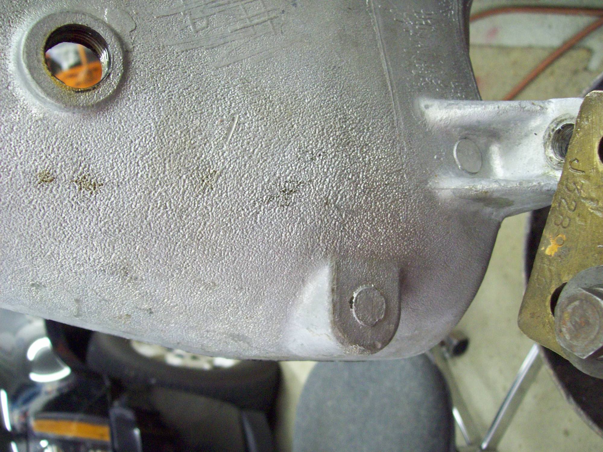

ALLLLLLLLLLLLLLLLLLLLLLLLL Muncie cases, beginning with the first one in 63, have a boss for a drain plug. But ONLY 66-69 M22s got a drain plug,
Then, in 70, ALLLLLLLLLLLLLLLLLLLLL Muncie cases got a drain plug.

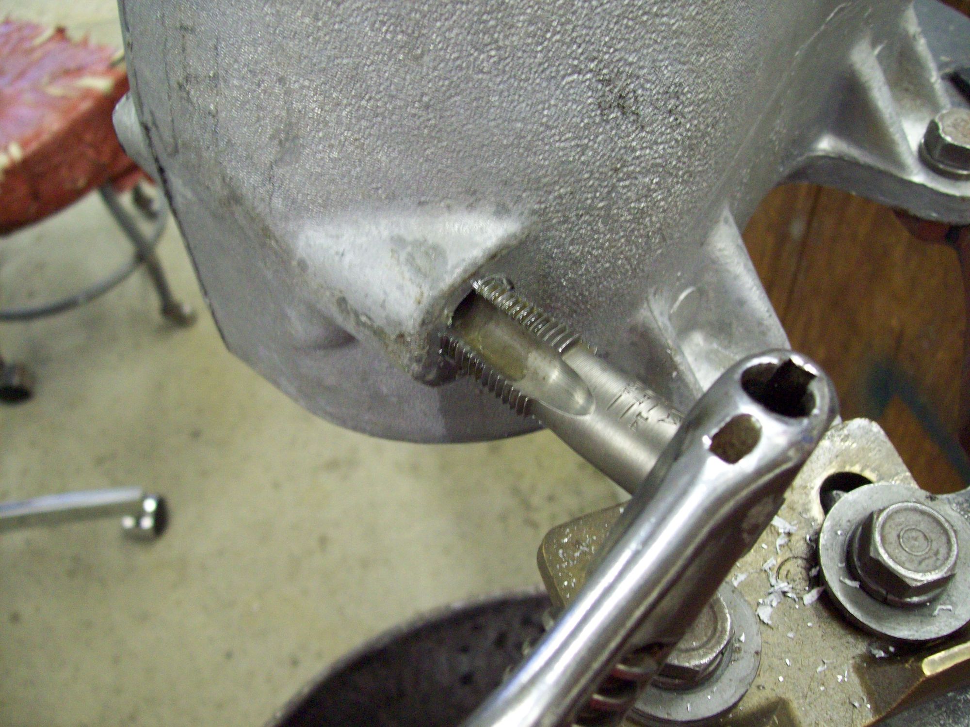

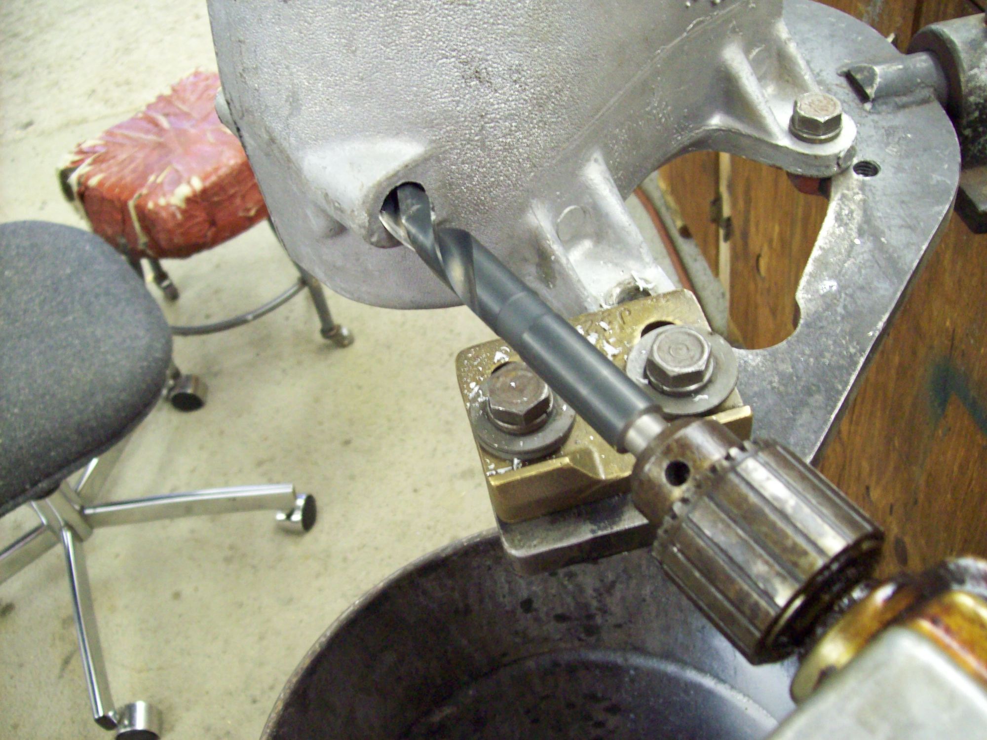

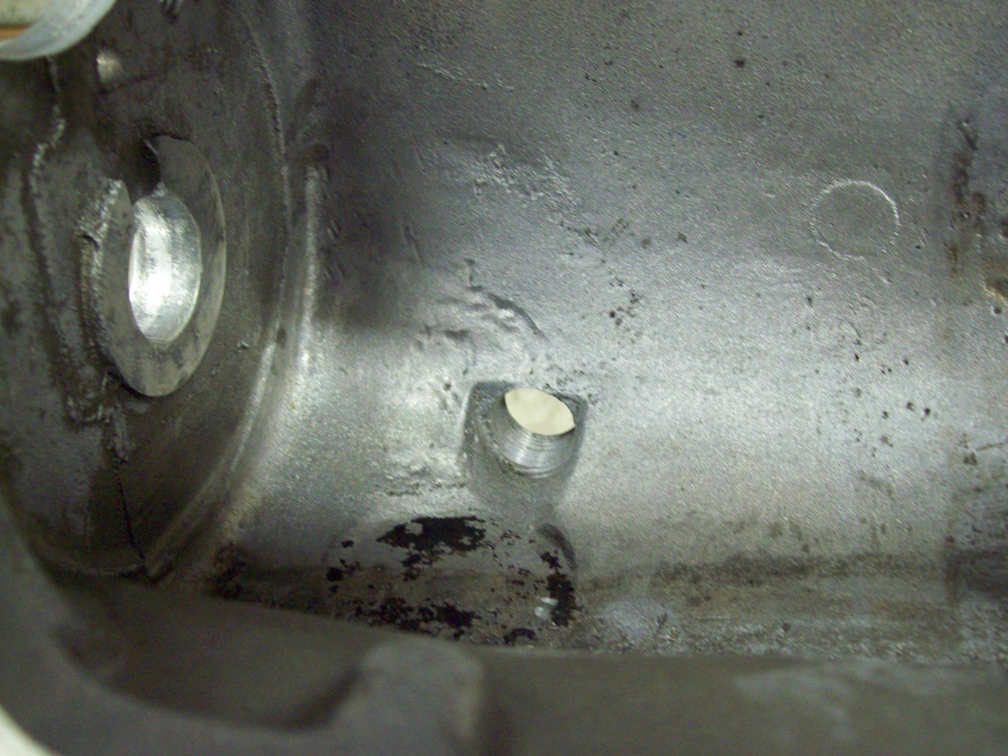

A drain plug CAN BE ADDED with the transmission in the car. I have only done 2-3 in the car------------BUT I cannot count how many I have added in the fixture in the past 50+yrs.
Here is how I do it.

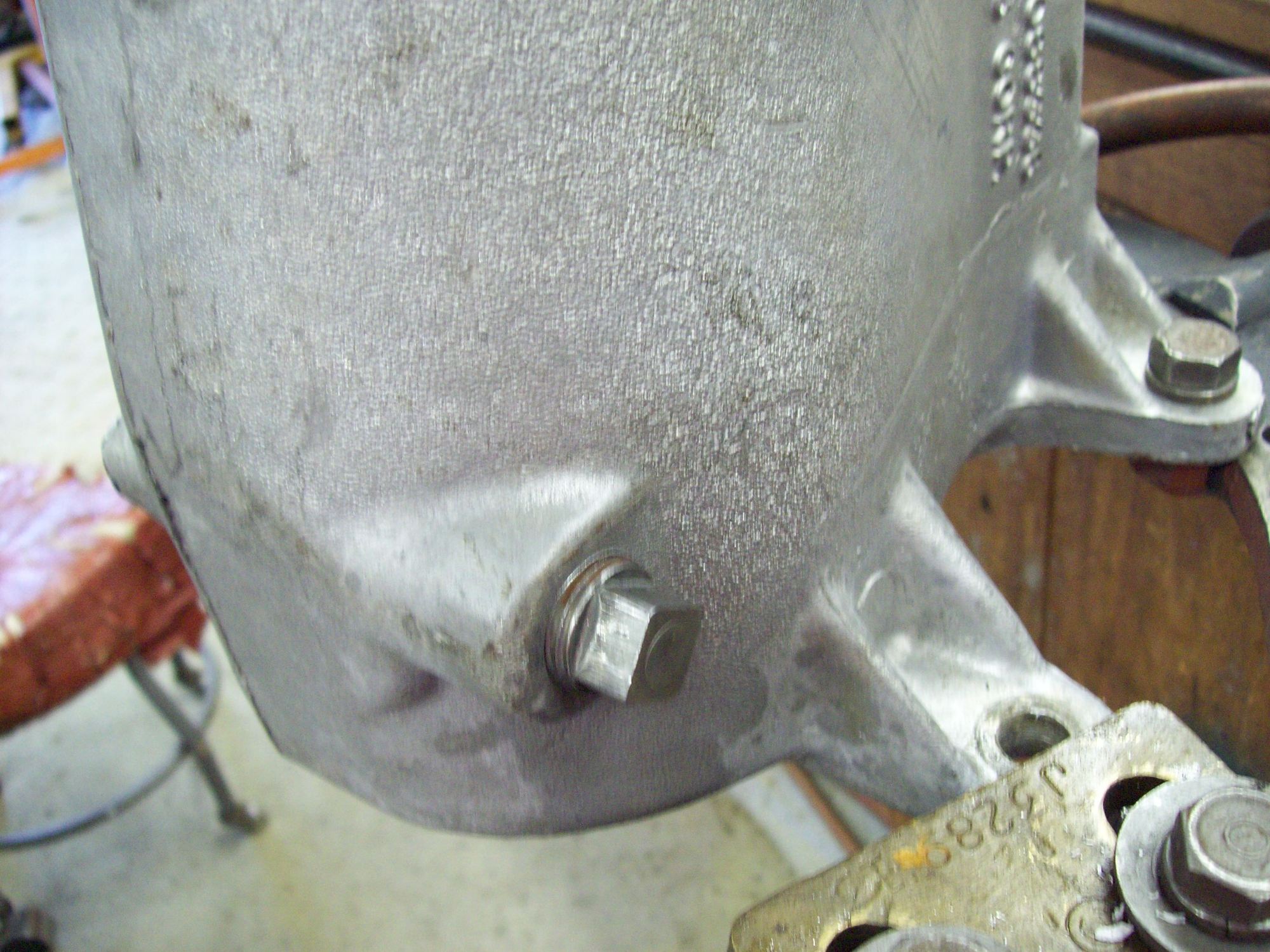

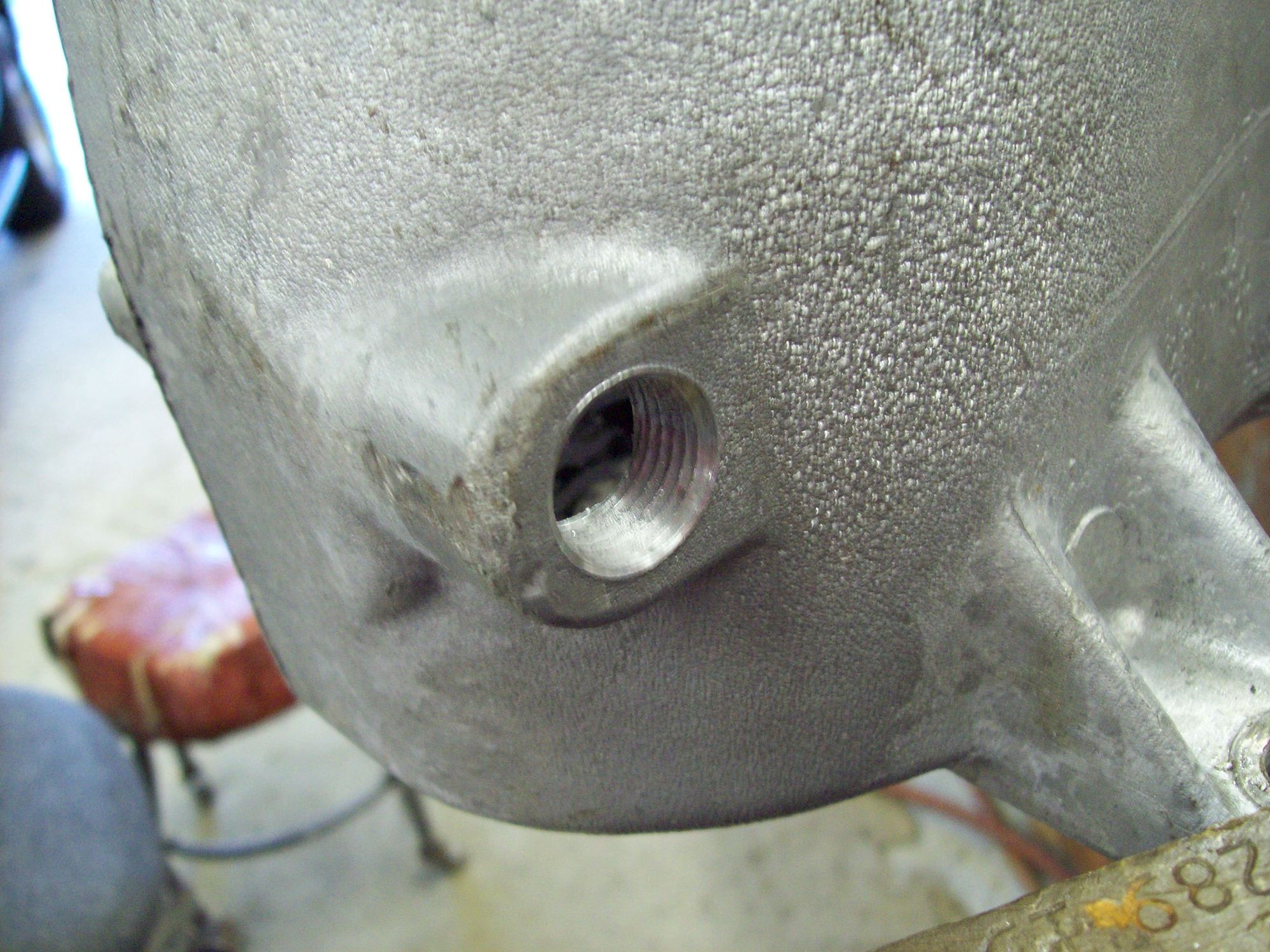

This is the case before drilling a hole in the lower boss.

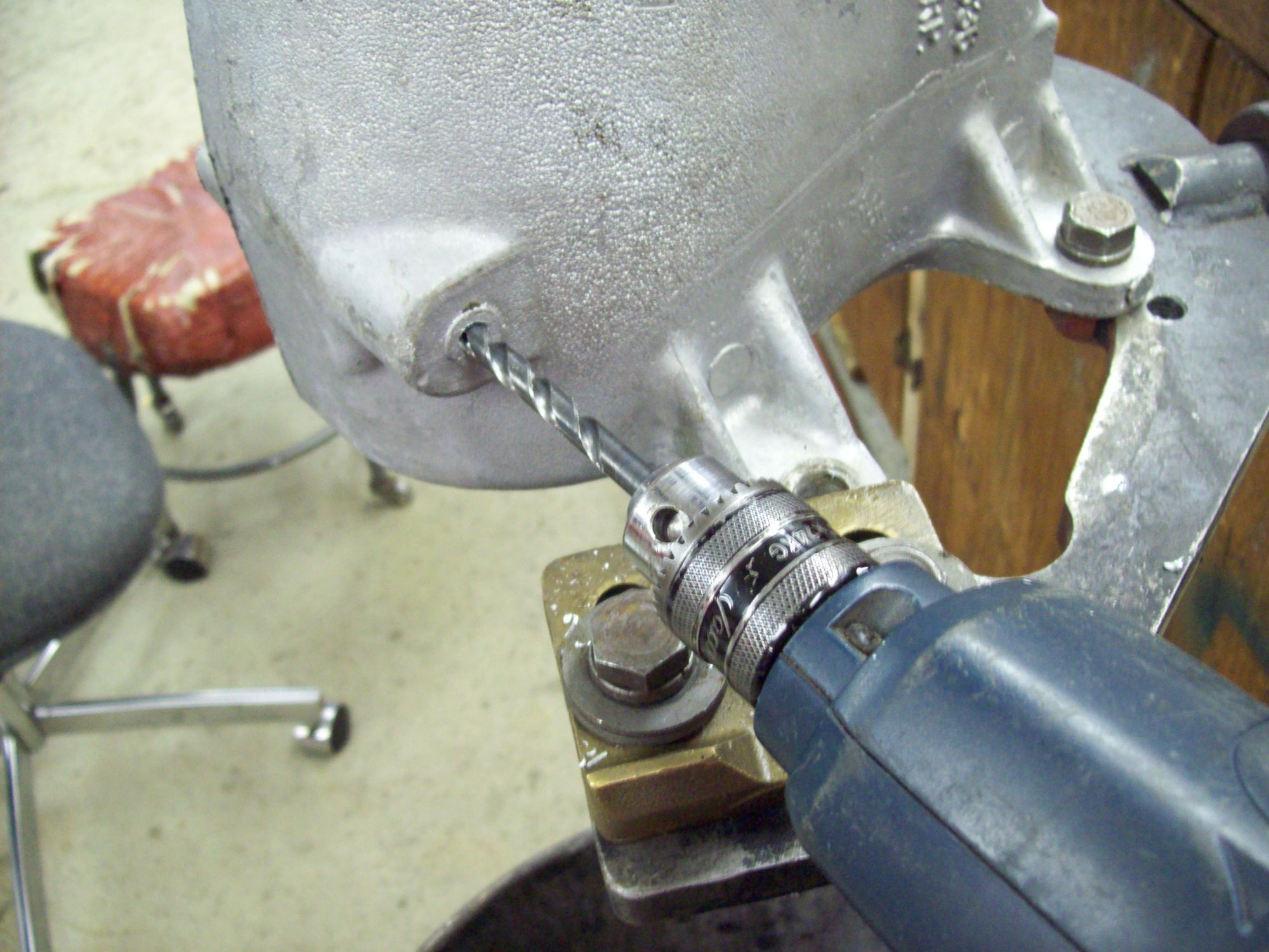

First, I drill a pilot hole.
Then I drill a big hole with an 11/16 drill bit.
The hole is threaded with a 1/2in pipe thread tap.
I ONLY use a magnetic plug in the drain hole.

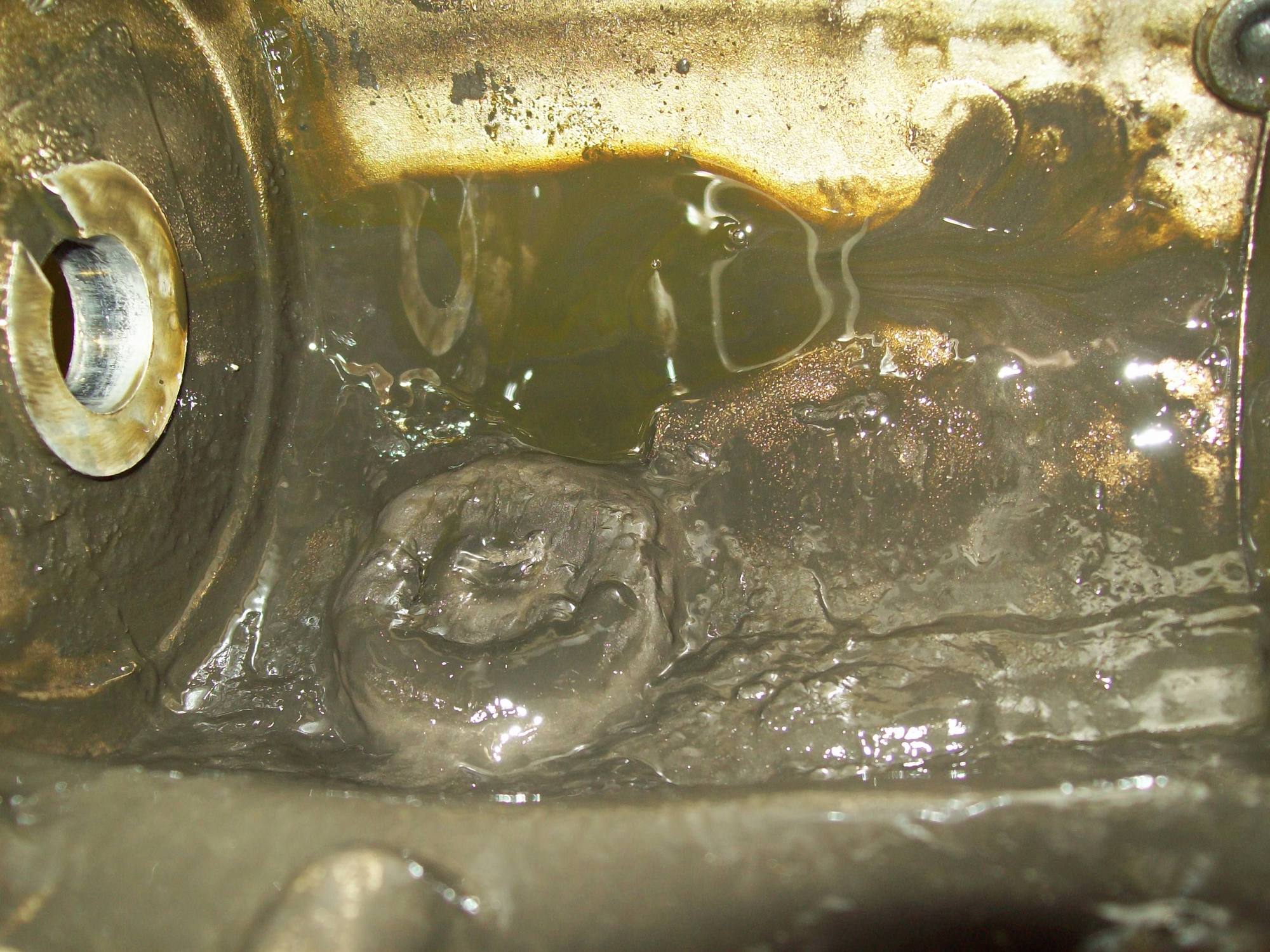

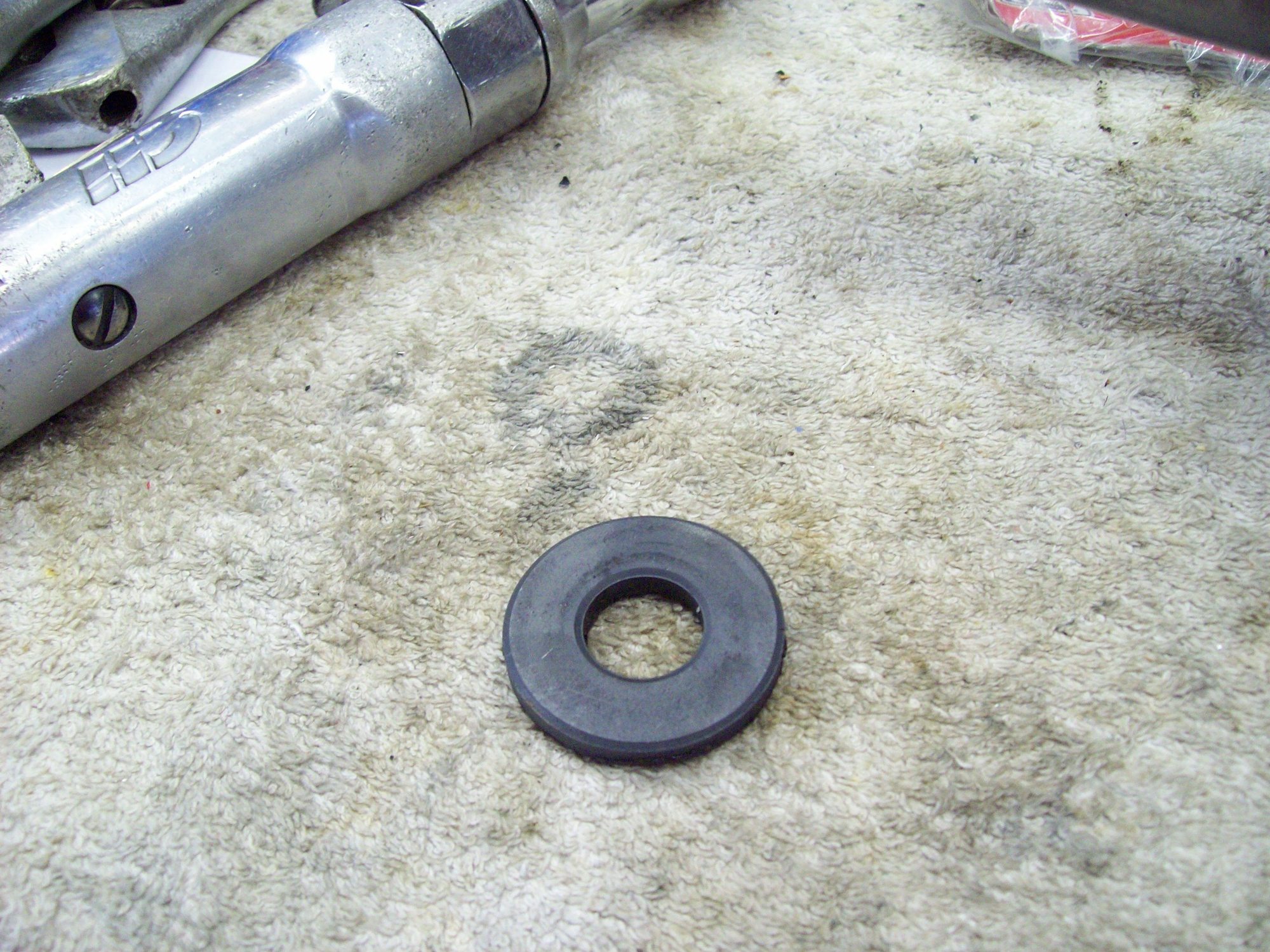

Prior to 1970, Muncies had a magnetic donut glued to the bottom of the case. It is good at removing metal particles from the oil, but there is no simple way of cleaning it off. Thus, when I add a drain plug, I always remove the magnetic donut.and toss it in the top of the tool box
And that's how I add a drain plug to 63-69 Muncie cases.
