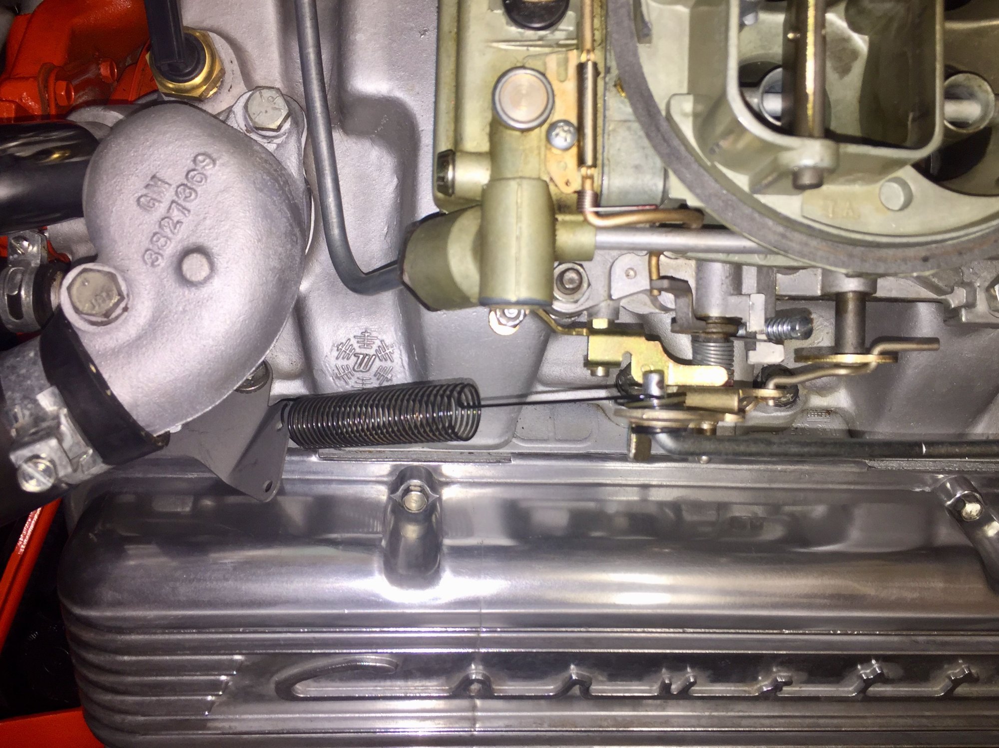

A little off topic, but once you get this issue resolved, you might want to rid yourself of that "screen door" spring you're using for a accelerator return spring. The correct spring is readily available.
https://www.zip-corvette.com/63-67-3...r-67-auto.html
63-67 327 Accelerator Return Spring (Non Fi, 340hp or 67 Auto)

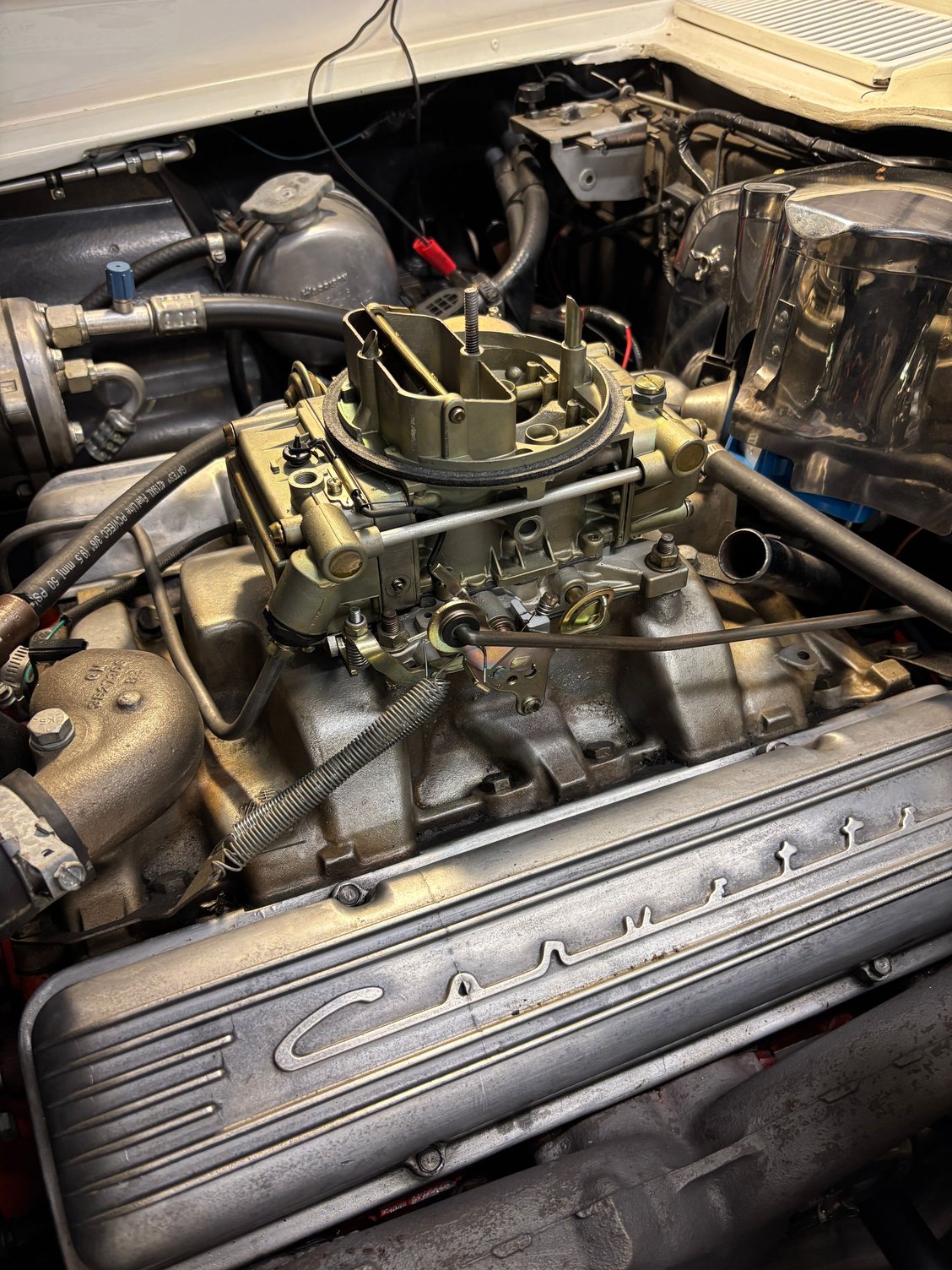

Originally Posted by Tcheairs38655
Dan, this is a 3810 carb and there's a long tube connecting the fuel supply to the secondary bowl. I'm not real sure how this tube releases the primary bowl. Yep, I need to remove the bowl and take it from that initial adjustment. Would appreciate any tips you may have for the removal of the connecting tube.
I just looked at this picture again. Those fuel bowls are not from a '67 List 3810 Holley. They're from an earlier year Holley 4160...and, may have sight windows on the passenger side of the bowls. More interesting, where is the adjustment screw and nut on the front bowl?? There's one on the rear bowl but only a hole where the screw and nut should be on the front bowl. Fuel leakage anyone??

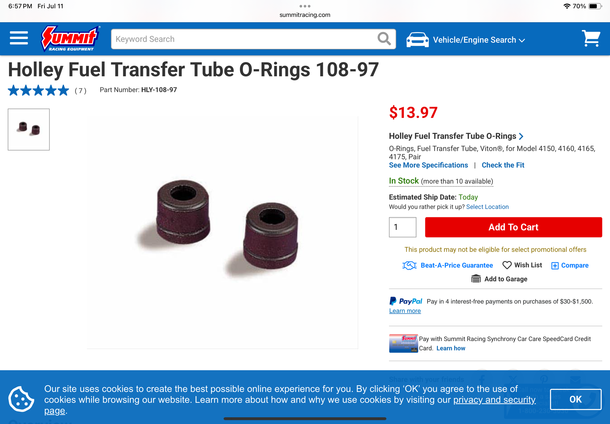

Oh, OK..I see. I'm going to pull the primary bowl this afternoon and try to get the float level and go from there. My only fear is having a leak where the transverse tube inserts at the bowl.
If the seals (o-rings or cylindrical rubber) are in good condition, just put a light coat of grease on the rubber when reinstalling the tube. The o-rings are not particularly special and your local Ace Hardware likely has them. Make sure you get Nitrile (Buna-N), Viton, or Teflon (PTFE) as these are gasoline resistant. Holley makes an
upgraded transfer tube upgraded transfer tube "o-ring"
that works quite well.
