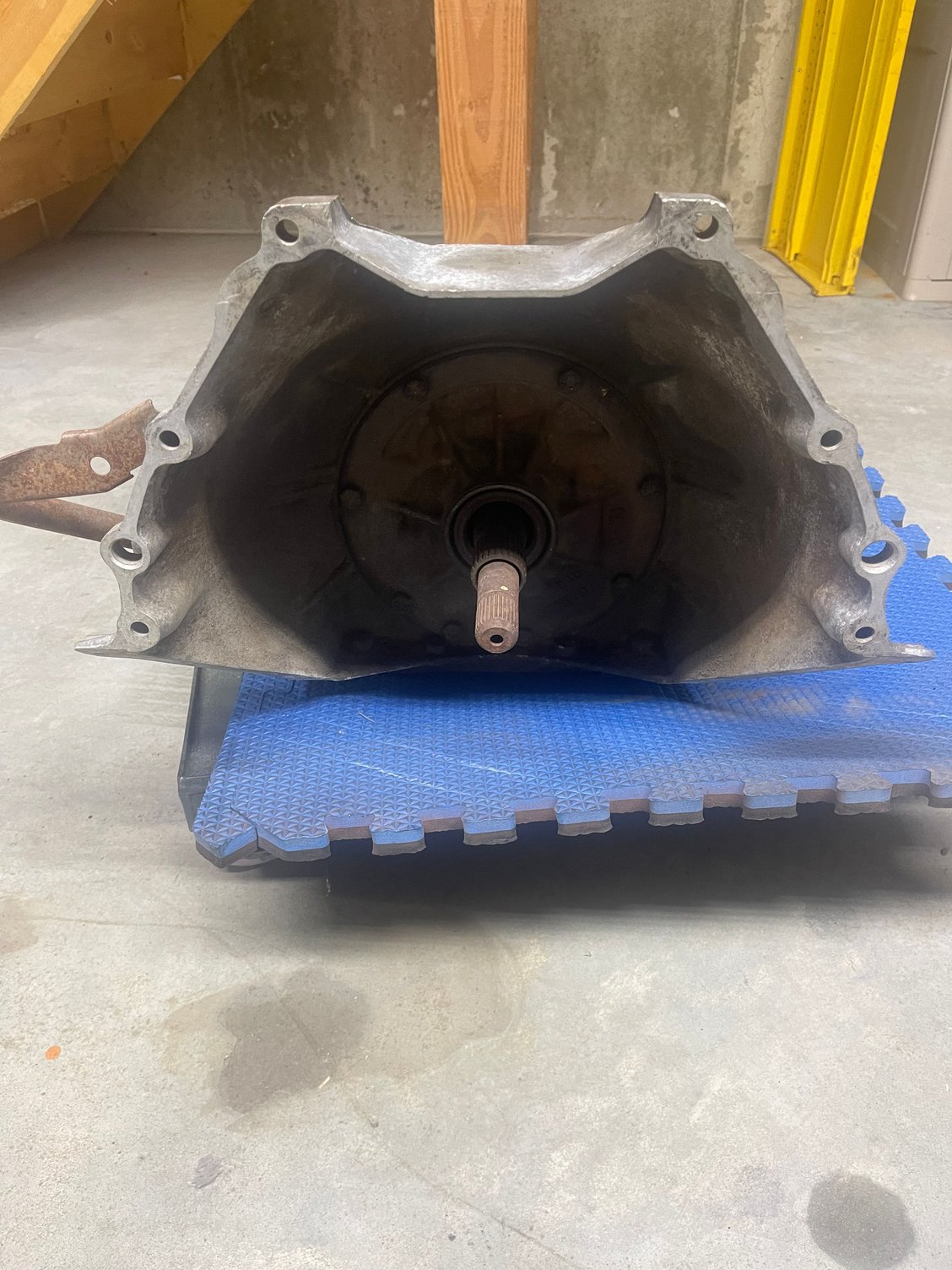

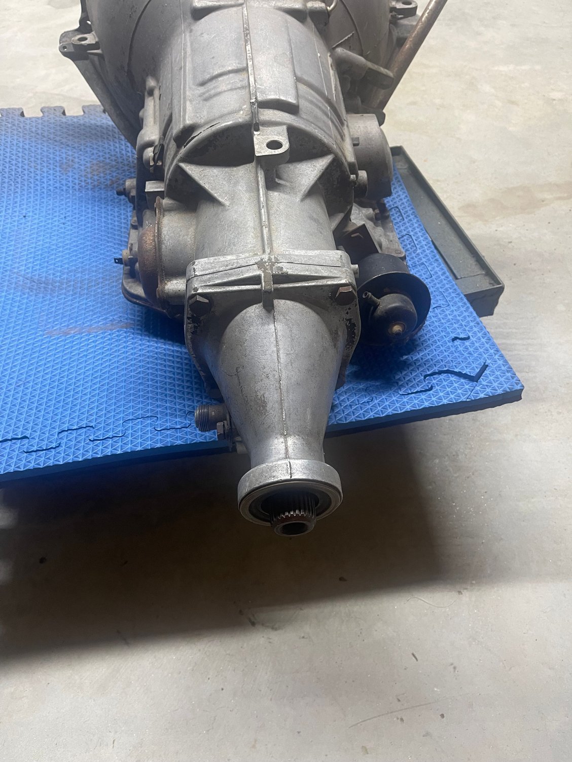

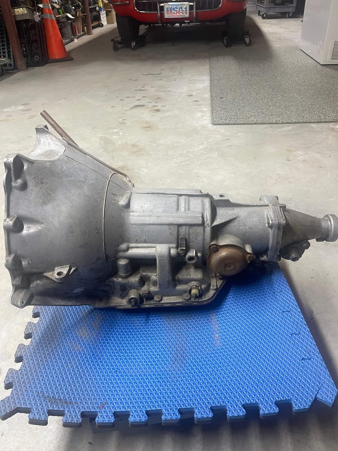

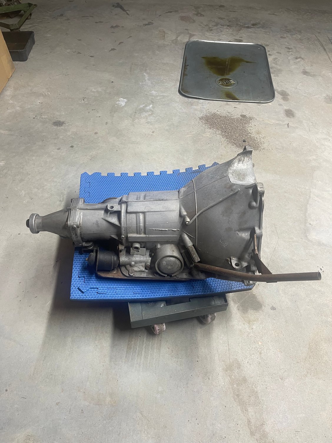

Anyone know what this is for ?

Looks to be a standard two speed powerglide that someone modified the top for a odd reason

Not a powerglide. It's a 300, used in Buick, Olds, Pontiac in the mid 60s. Earlier versions in Buicks and Oldsmobiles had the switch pitch torque converter
It's kind of a powerglide built like a TH350. Has a clutch for reverse, instead of a band.
used from 1964 till around 1969?

That is a Super Turbine 300 used in Buick, Olds, Pontiac back in the 60's. A 2 speed similar to the Alum PG. L-R Clutch, Hi-Direct Clutch and a Low band. Friction plates, Lo band and some of the bolts interchange with the PG but none of the hard parts do. And yes, early models used a VP, variable pitch torque converter activated with a switch on the front pump. They like the PG were dependable old 2 speed units.
The one in the pic is a non VP unit. You can tell by the splines on the pump stator and input shaft.
