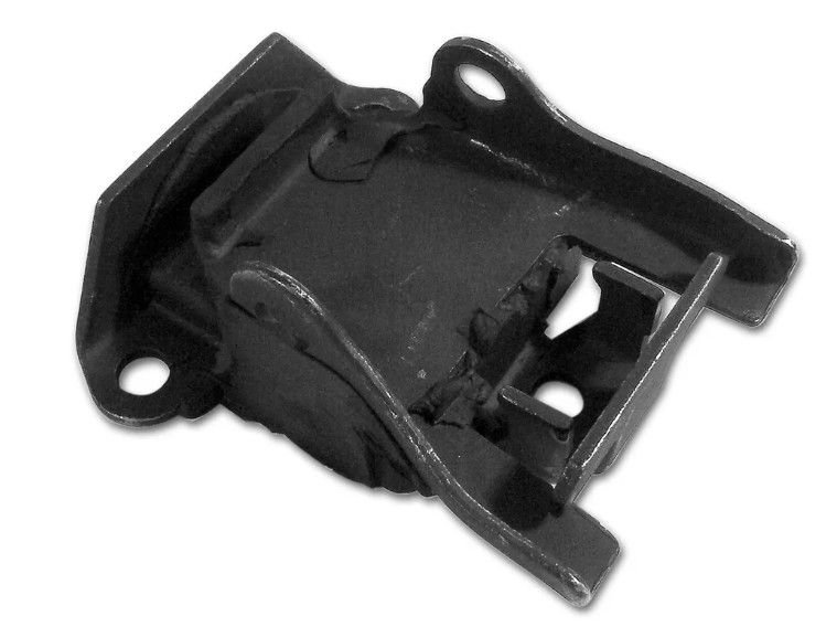

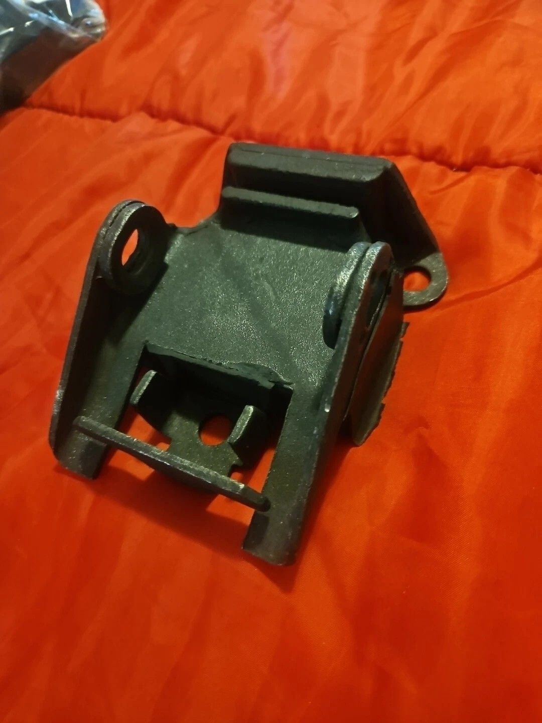

Well I definitely have two different motor mounts. Both are are locking, both measure 2-5/8 width, but they are physically different. One of each below.

Good suggestion. I did measure at different points, and could only find a difference of 5/16" at one point. I ordered new motor mounts, I suspect that having two different designs is not helping the cause.
