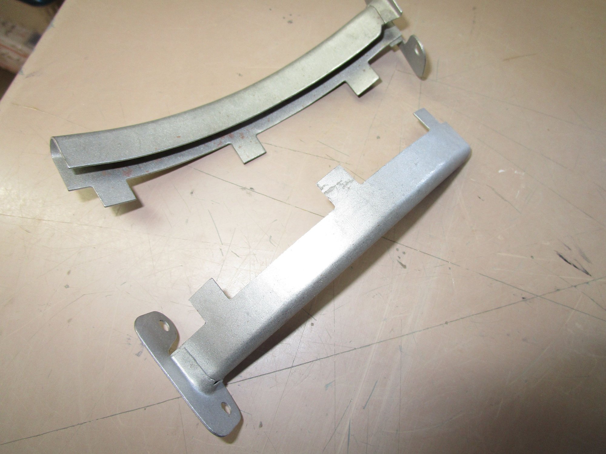

Where do the go, doors? Thanks, Lon

What year car? I don't recall seeing them on a 65 or 67.

1961 Vette, I thought I was in the C1 only, sorry!

The C1 and C2 is combined. And I was going by your picture under your name

Power windows ???

I'm going out on a limb and saying those are not Corvette parts. While they do look like window run channels, the curvature is extreme. C1 windows take straight run channels.
That's my story and I'll stick to it until proven wrong.

Those are the power window conduit on a C-1, the power window wires go threw them. They mount to the doors.

Well, I'll be......
Thanks!
https://www.corvettecentral.com/c1-5...dow%2bconduits

Have them on my '60
