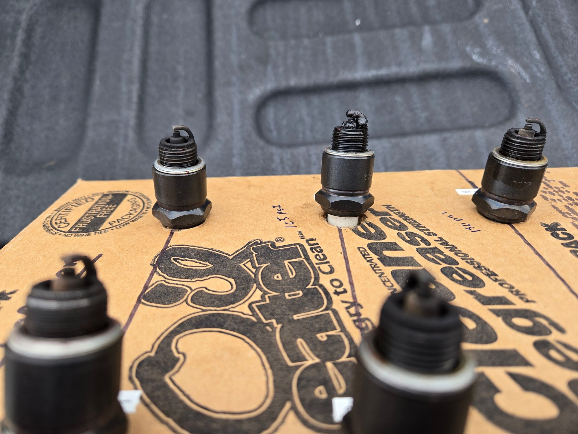

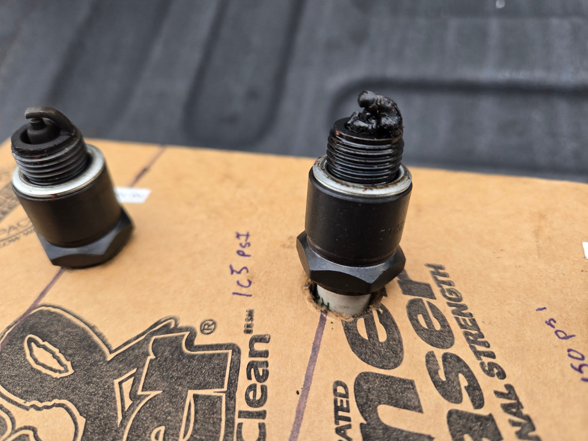

Well finally getting back to my 62, back surgeon gave me the go ahead to resume some of my bending twisting activities so I ordered a set of plug wires and thought i would start there as well as go to a warmer plug as my driving is typically around town, points, rotor and cap only have a 1,000 or so miles on them and after examining them and looking the age of the wires I thought I should replace them as part of the trouble shooting process. In doing so i found my number #4 plug was fouled completely, all other plugs were pretty much the same color. I did a compression check with my compression tester on #4 and it pulled about 165 lbs, #6 was about 150 lbs. Any thoughts on the cause? I have not driven it since i replaced the wires and plugs due to weather. Just wanted to get some feedback as to the possible reason.

I'm going to guess that there is a lot of carbon on top of #4 piston increasing compression ratio. First inclination is a bad stem seal and easy enouigh to replace to see if it improves.

Possibly bad valve stem seal or worn valve guide. Won't talk about the oil rings. But, could be a bad plug or wire too.
I would clean the plugs and install the plug from #4 in another cylinder which shows good burn. Then check the wire with an ohm meter (VOM) and flex it while checking continuity. Also check the contact in the distributor cap. I have encountered bad new plugs that exhibited weak spark and thus more build up. If you can run the engine for a few more miles, then pull the plug from #4 and check for oil buildup you are seeing.

I had a plug that looked exactly like that one a few years ago. A bad valve guide was the culprit.
Here's where I'm placing my money

I agree Dan, valve seals and or guides are the most common problem with a SBC.
However, I rebuilt the 327 mouse in R66 with 59,000 miles on it as it was using a quart in 100 miles and I had 3 plugs which looked fouled like that. The compression on all 8 cylinders were 150+ and within 10% of each other and passed the leakdown test.
I assumed valve guides and took the heads to an old machinist. We found the guides within the GM serviceable tolerances and recommended I not waste my money with new guides. The valves had up to .002" wear on the stems. I replaced all 16 valves and added positive seals.
I pulled the pistons and found 3 pistons with stuck oil rings. The previous owner must have never serviced the engine and the car set for an unknown period before and after his death. The cylinder walls were also within GM serviceable tolerances for a re-ring. I put new moly rings and Clevite rod bearings in.
The engine now has 1,200 miles on the rebuild and has not used a drop of oil.
This was my first experience with stuck oil rings on a SBC, that is the reason I mentioned them to the OP. IF his engine has good compression on all cylinders and good leakdown results, I would try valve seals first, then pull the heads and investigate. There is always the possibility of a bad plug or plug wire which is the reason I recommend moving the plugs around first.
