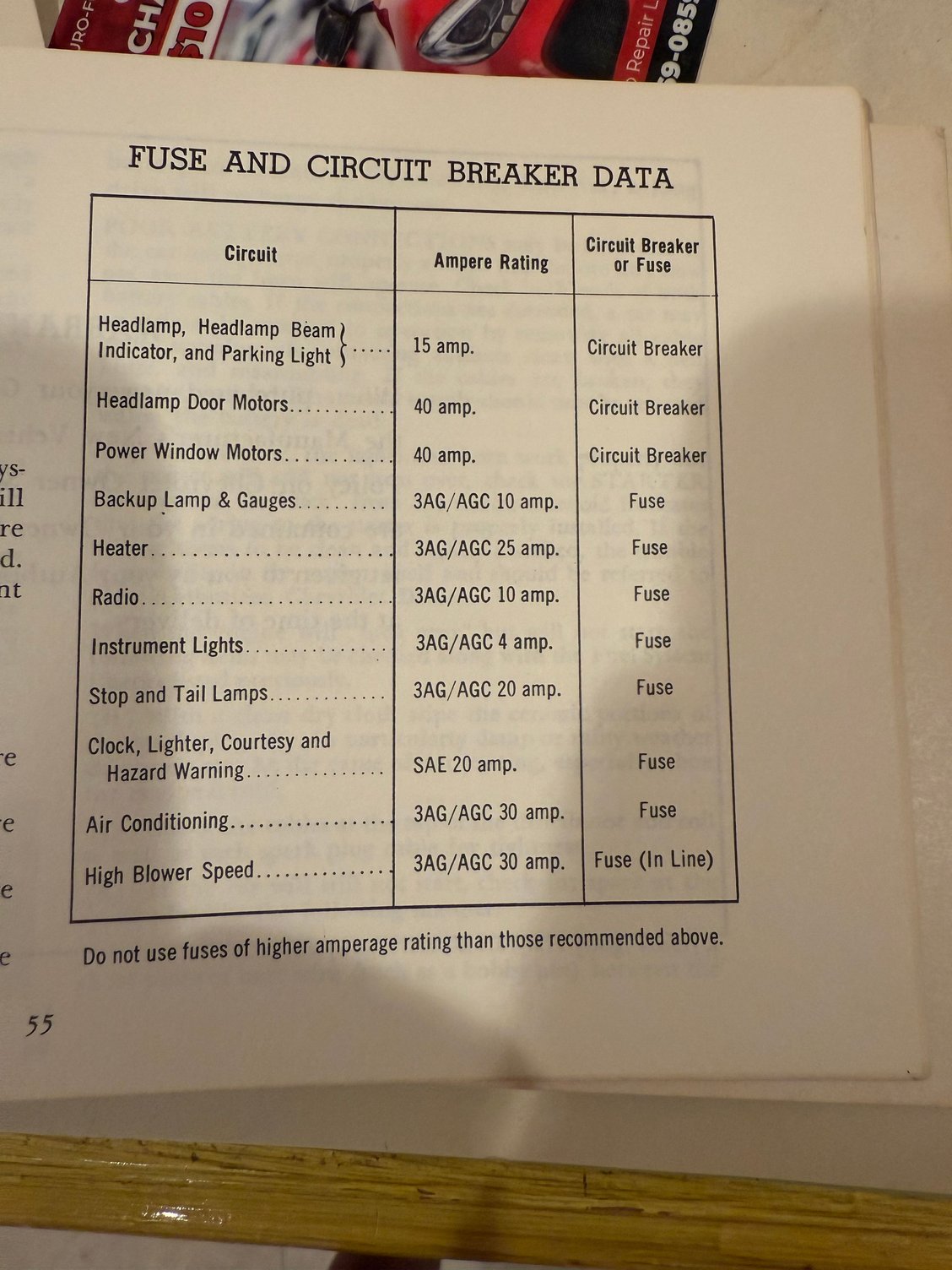

For 1967 Corvettes the correct lamp designations and their locations, as published in the owner’s manual. Also here is the correct fuses, their ratings and circuits.
