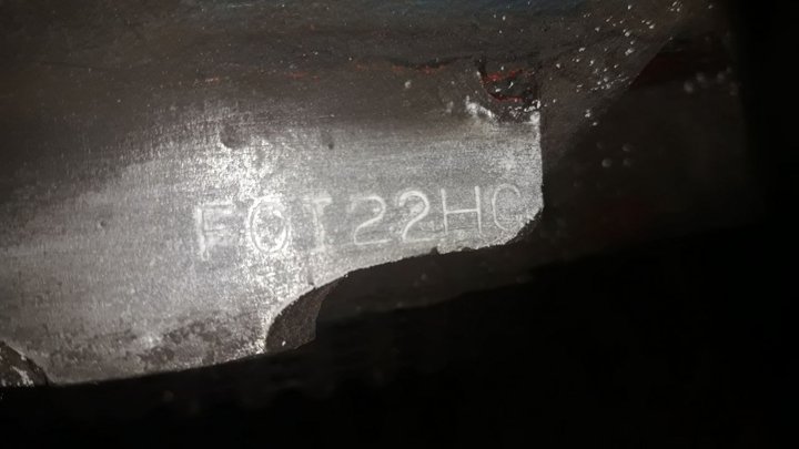

Can anyone help me decipher this number? I think it's F0122HC or FOI22HC. It's supposedly a 327 of unknown origin.
Thanks!

Any chance that suffix is "HG"?

Assembled Jan, 22nd?
HC is not a Corvette according to the Lime book

That might be HG. If so '65 Vette 375hp. Dennis

Show the other number on the pad, then it won't be an unknown origin anymore.

It doesn't look like there is a vin stamp on the other side of the pad. So that makes sense for a HC suffix code
