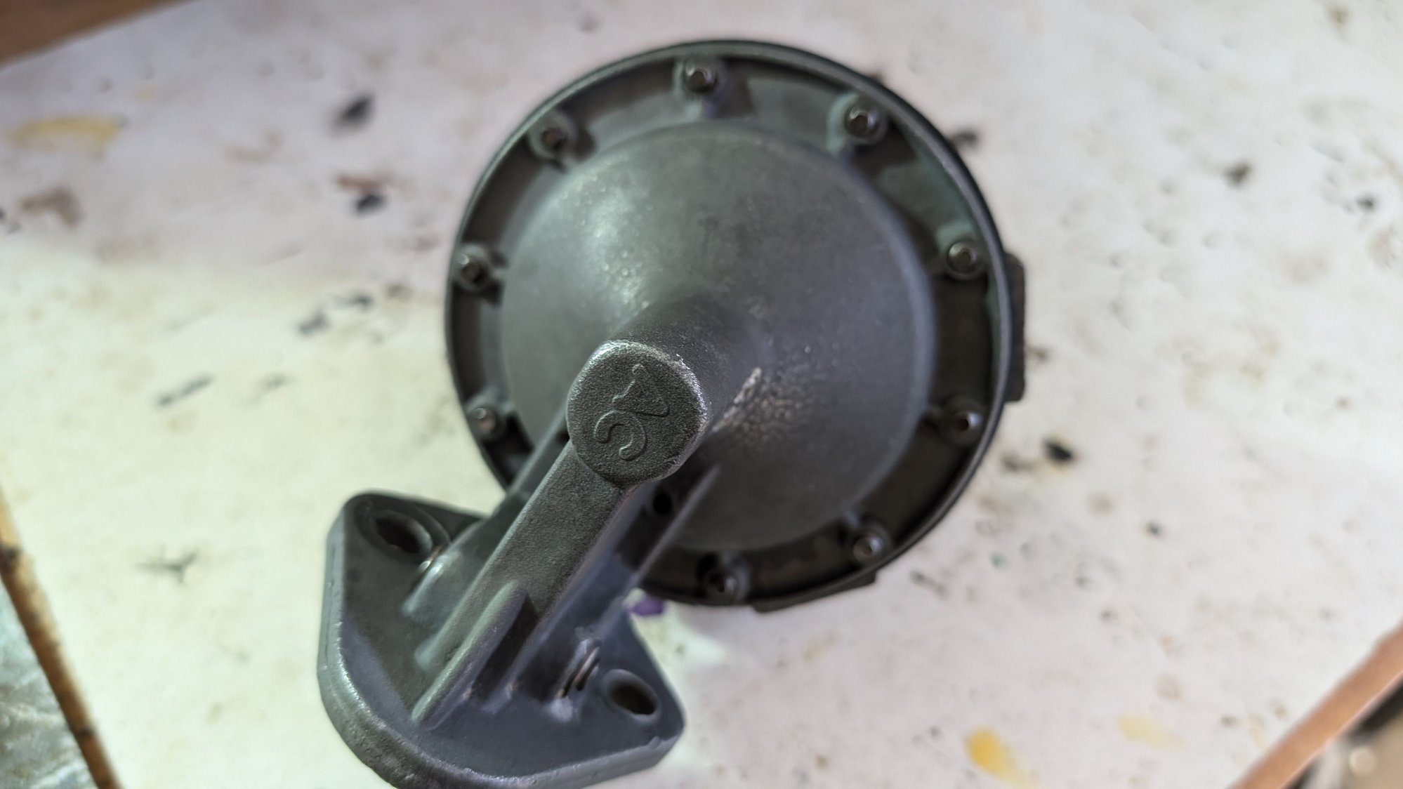

What fuel pump replacement are you using on a c-1?. orig. are obsolete or crazy money

It is a dilemma! The Airtek pumps were available for reasonable money just a few years ago.
I have one on my car now.
When I recently tried to purchase another as a spare, I found (like you) that they are not available.
Luckily, I had my original pump on a shelf.. in rough shape.
I decided to rebuild my original pump... but getting the rebuild kits is getting difficult too (and expensive).

Give these folks a call for a rebuild kit for your original AC fuel pump. They should be able to hook you up.
https://www.then-now-auto.com/

Thanks Leif.. I rebuilt it several months ago.. but good to know. -Fred

I use this one: https://www.holley.com/products/fuel...s/parts/12-834
