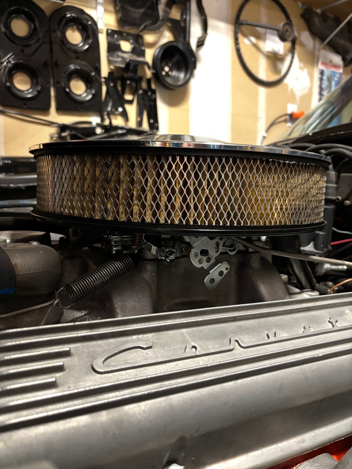

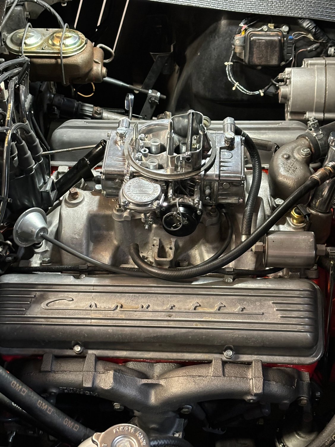

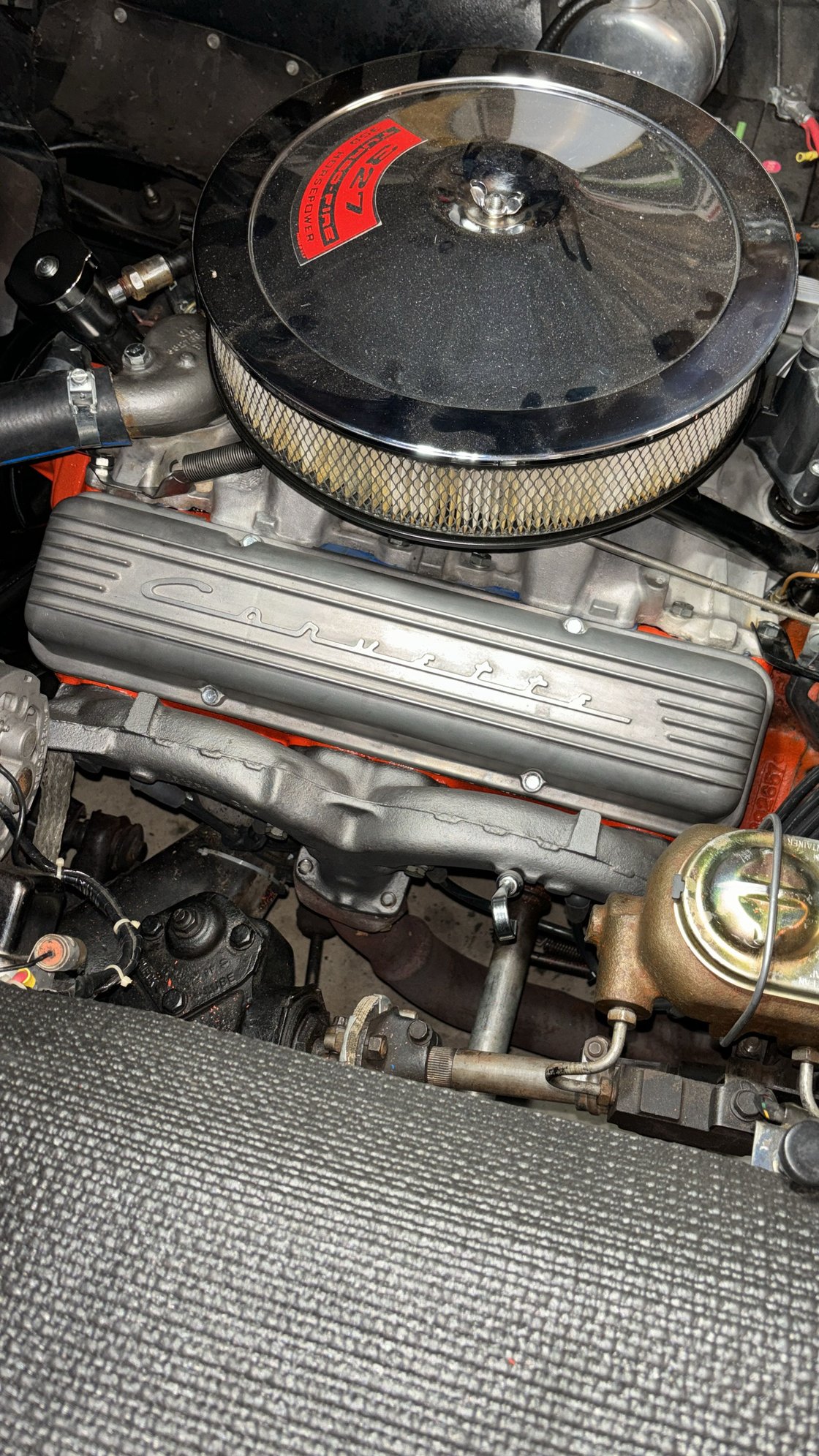

on my ‘67 with the 80457S,
with the stock air cleaner in place, you can’t really see the carb to tell it’s shiny version. I had to lengthen the PCV hose and added a 90-degree elbow.
can’t see much…
