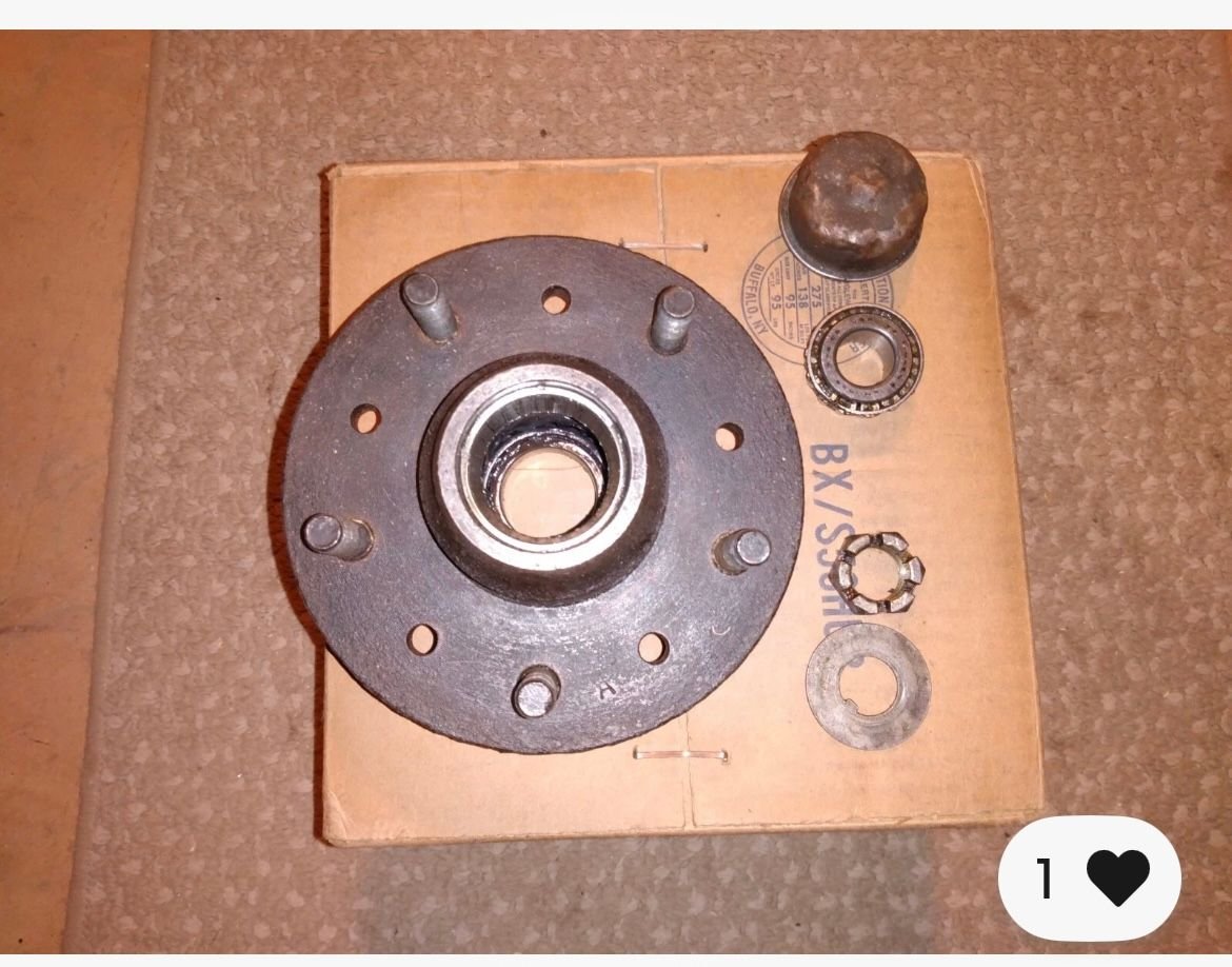

Think I found one, I can’t find my verniers, but it’s supposedly off a 65.
Add says “small journal” so I’m guessing he means small diameter spindle, or pre 69 ?
