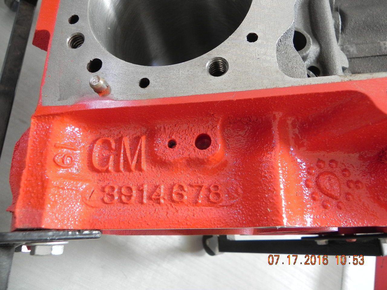

Rear bellhousing casting no. 3914678 I think its a 1968 block but could be a 327, ..Z/28, 302, or 350 from what I have found out so far.

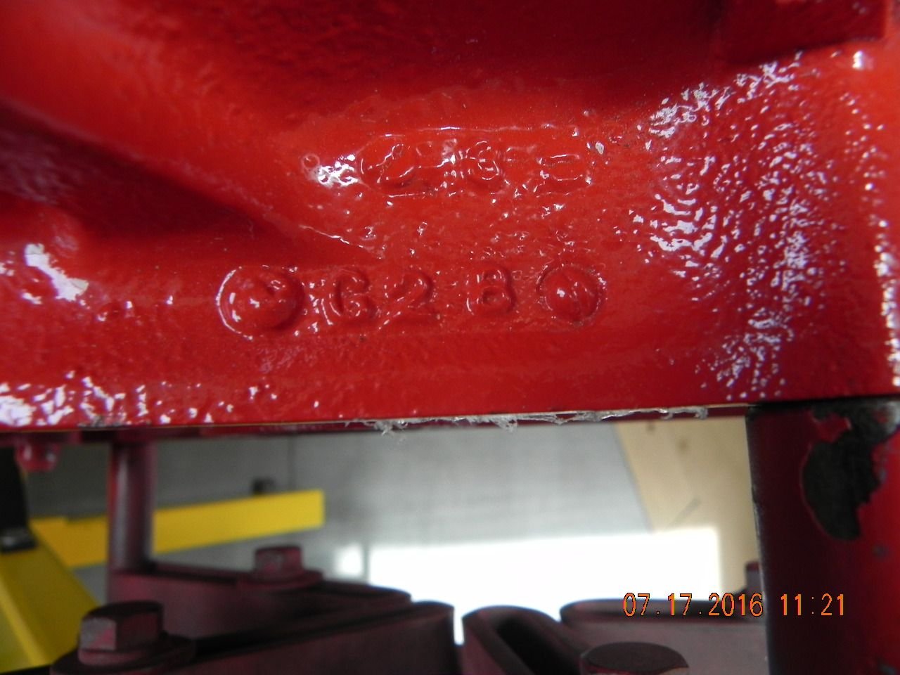

The front passenger side block stamp is V0306YI
That means a Flint assembly---March 6th.
what I have been unable to find out is what the suffix YI represents. What car it may have come out of and what specs...HP etc.

You sure it's not YJ which is a 327 from a 68-69 truck

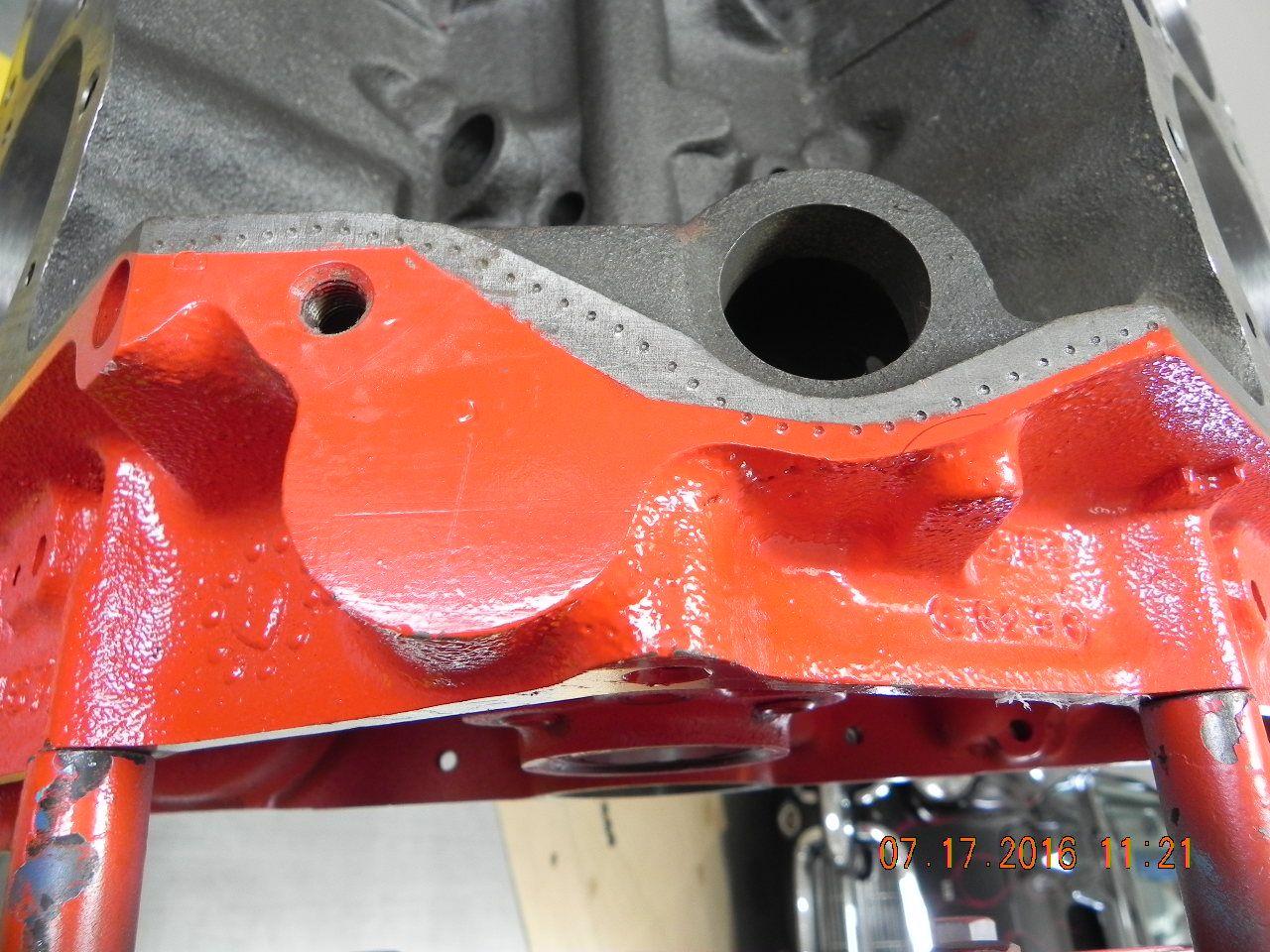

You need to go back and recheck the suffix code on that block, "YI" is a 366 big block truck engine. How about a picture of the pad?

L8 - That casting number is the same as my '68 vintage 327, but can't tell you about the front suffix designation.
My 327 came out of a '68 L79 Chevelle and, before it got decked, had a suffix of EP. No real difference between it and any of the 'other'\
