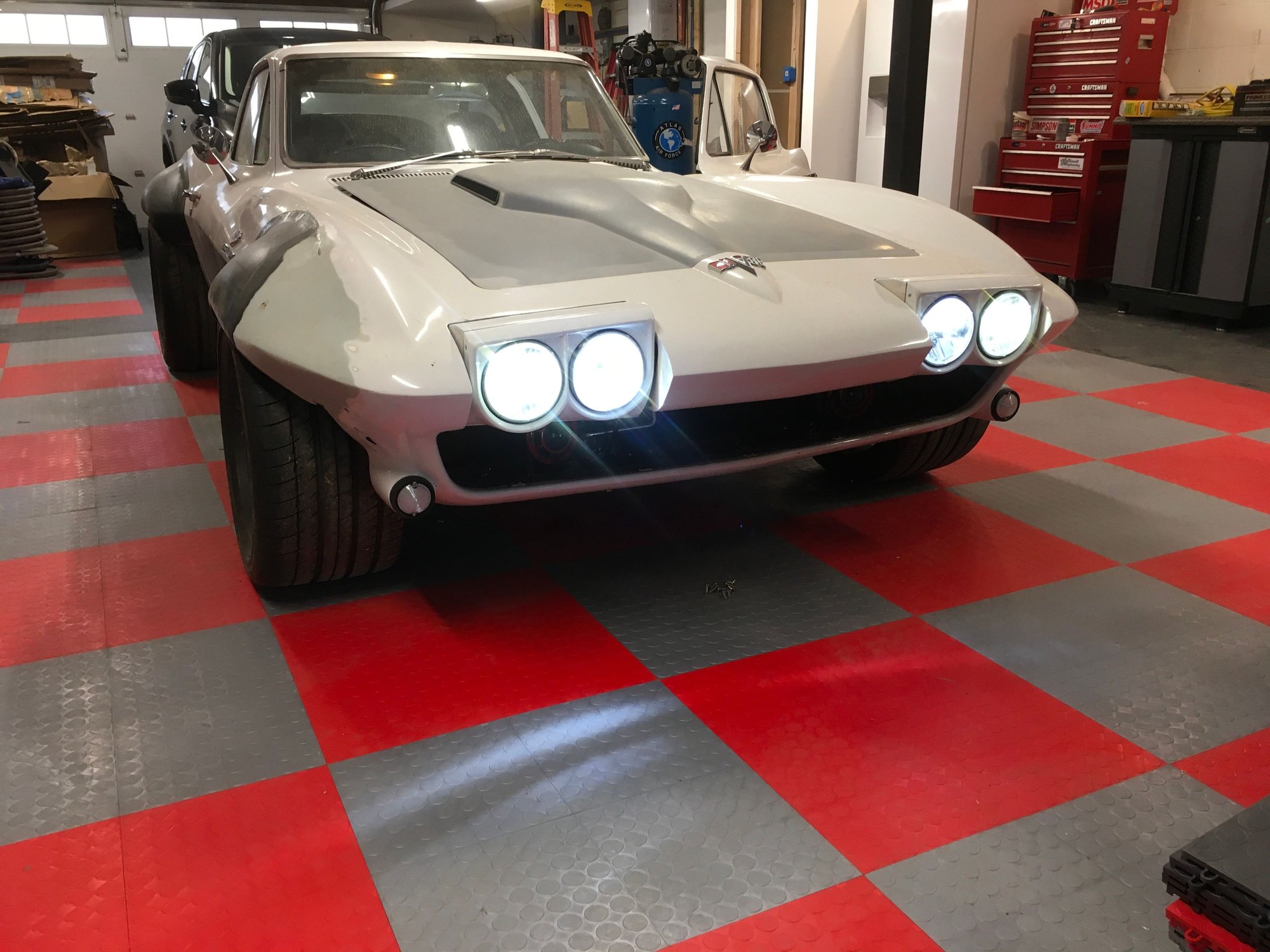

After several failures of new aftermarket T3 headlights, I began looking into the LED world to see if it had caught up to this hobby. Come to find out it has but like so many things in the aftermarket Corvette parts world, LED headlights are a "bend over and hold your ankles" upgrade. $200+/per for the Holly lamps? Will someone please enlighten me: are there are other viable options out there? $900 will buy a lot of incandescent T3's and it may make more sense. As a C2 owner for over 37 years and aware of inflated parts prices just because of the crossed flags logo, this one is at or near the top of Bullsh*t Mountain.

I converted ALL four to LED using Amazon LED lights. Then I got Packard housing, ends, 12 and 14 gauge wires, and Hella relays and it looks like it came from
the factory. I made a new headlight harness and it just rocks. Now I have all four on as low beams and they are very bright. I drive with those on during the day so that distracted driver's have a better chance of seeing me. The brights are really bright but I don't use them hardly ever.
The H4 bulbs that I got are no longer carried by Amazon but the were relatively inexpensive and have worked very well.

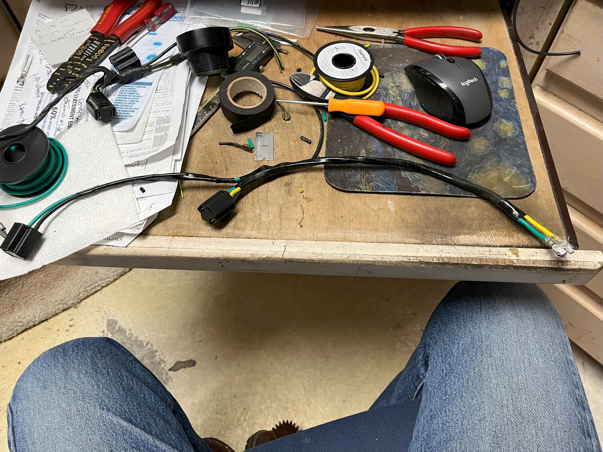

Hi Spike66. Packard is the type of connector and brand GM used for decades, as far as I know. I think that they might be listed as Delphi Packard or something online at Amazon or Mouser Electronics.
Here is a picture of the Packard ends, the relays, and a part of the wiring harness that I made. Hope this helps. Like Factoid mentioned, my headlight housings were about $80 for all four. Don't remember the bulbs price, but it wasn't too much. With LED lights, the relays are probably not totally necessary but they do protect the headlight switch and wiring to it from large voltage due to that wiring and switch becoming low voltage trigger wire when using relays.

Thanks Diablo427. I like the whole set up but I'd need a list of parts to get and maybe a little tutorial to walk me through the fab and assembly process. Automotive electrical is not my strong suit.

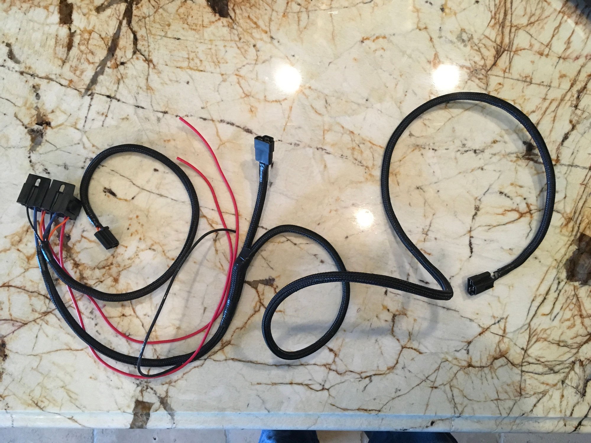

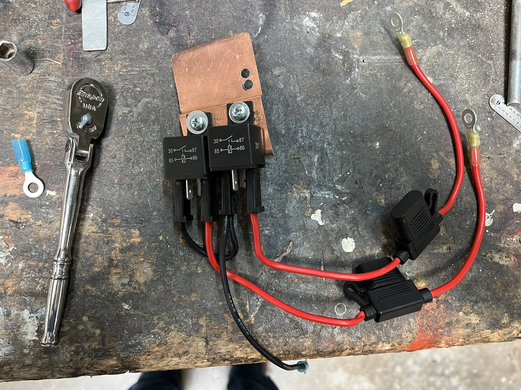

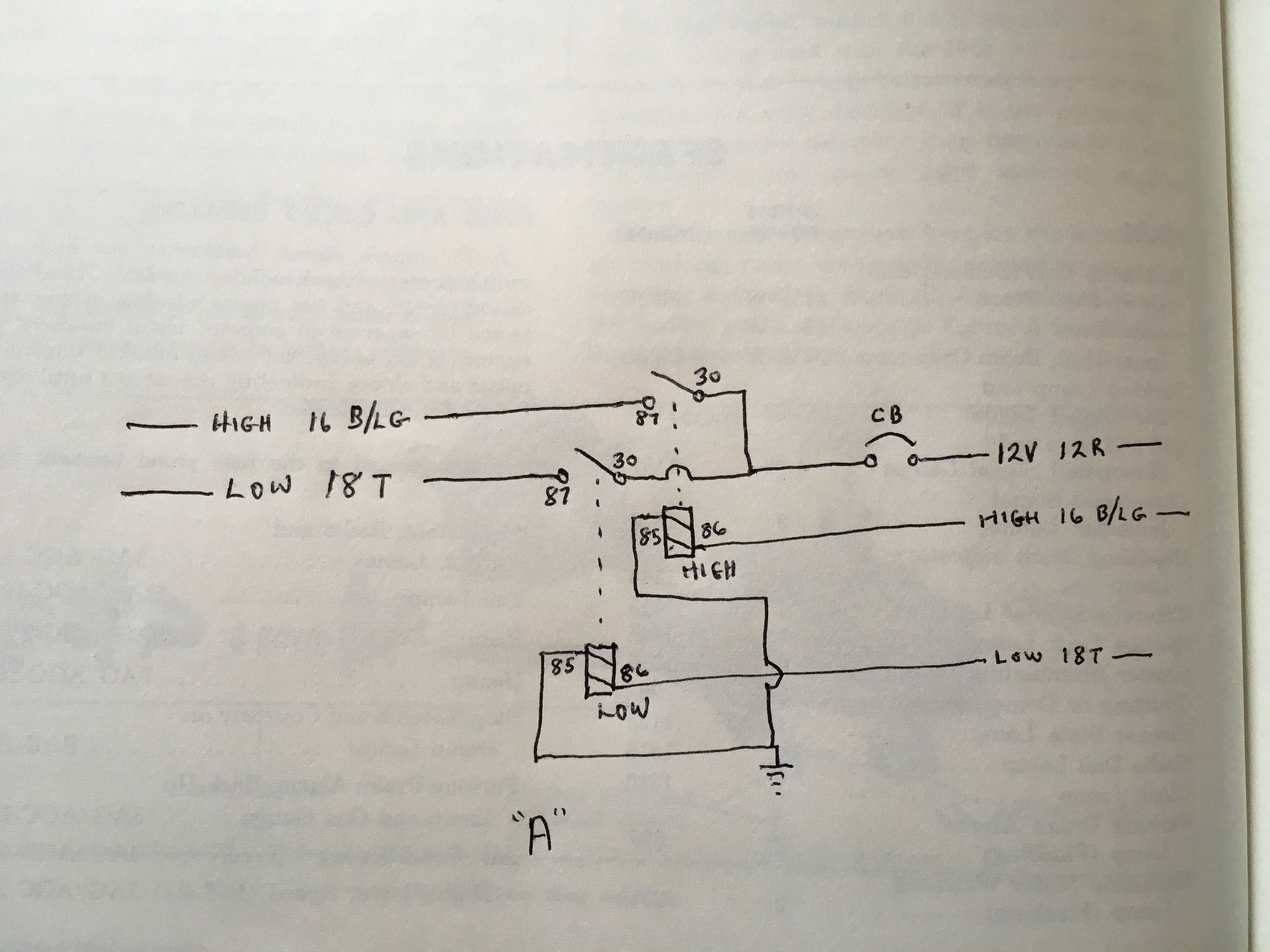

Here is a schematic I made for my ‘64. Using the GM connectors, there is no splicing. Simply plug and play.
Colors and gauges are for a 1964. Other years may have different colors
This is the new harness.
This is the new harness. The two red wires go to the new circuit breaker, the black wire to ground, and the connectors plug into the front light harness and headlight harness.

Factoid- Thanks for taking the time to make the schematic! It really helps. I'll look into where I can source the parts locally. Thanks again.
