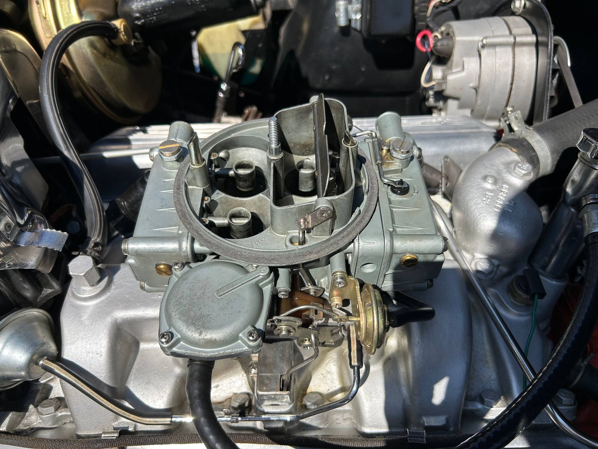

Before collecting all sorts of descriptions about where to attach a vac gauge, please post a couple photos of the top of your engine without the air cleaner installed. Then you'll get advice that applies to your exact engine.

In a 1966 L79 original engine and carb.

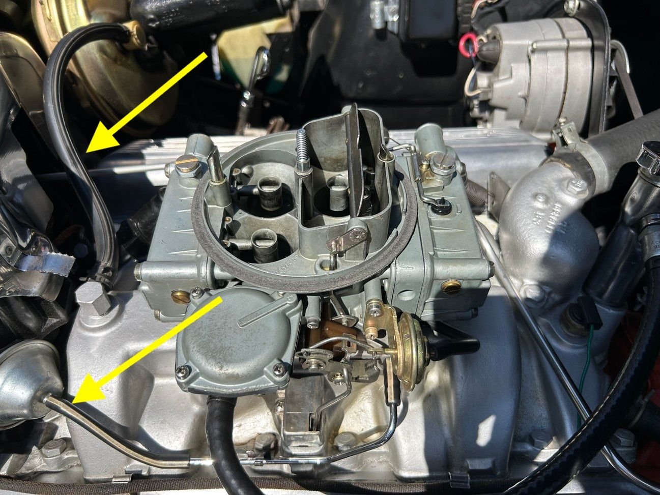

You can TEE into either of these hoses if you need to drive the car with the gauge hooked up. If not driving, just disconnect the left side of the lower hose at the distributor and connect the gauge. If you're wanting a permanent vac gauge connection, you can replace the hex fitting that connects to the brake booster hose with a 2-port fitting.

Thank you. So I connect it by the lower arrow as opposed to the valve by the carburetor?

Yes the lower hose is the distributor vacuum advance. If you are setting the carb mixture screws via vacuum readings there's no problem disconnecting from the advance can. Your idle will probably (should) drop and will need to be temporarily raised to reset idle speed. After setting mix screws to maximize vacuum, reconnect the hose to the distributor, and reset the idle speed.

To check the vacuum, just pull the tubing off the vacuum advance nipple as shown by the yellow arrow and plug your vacuum gauge into the tubing you pulled off.
