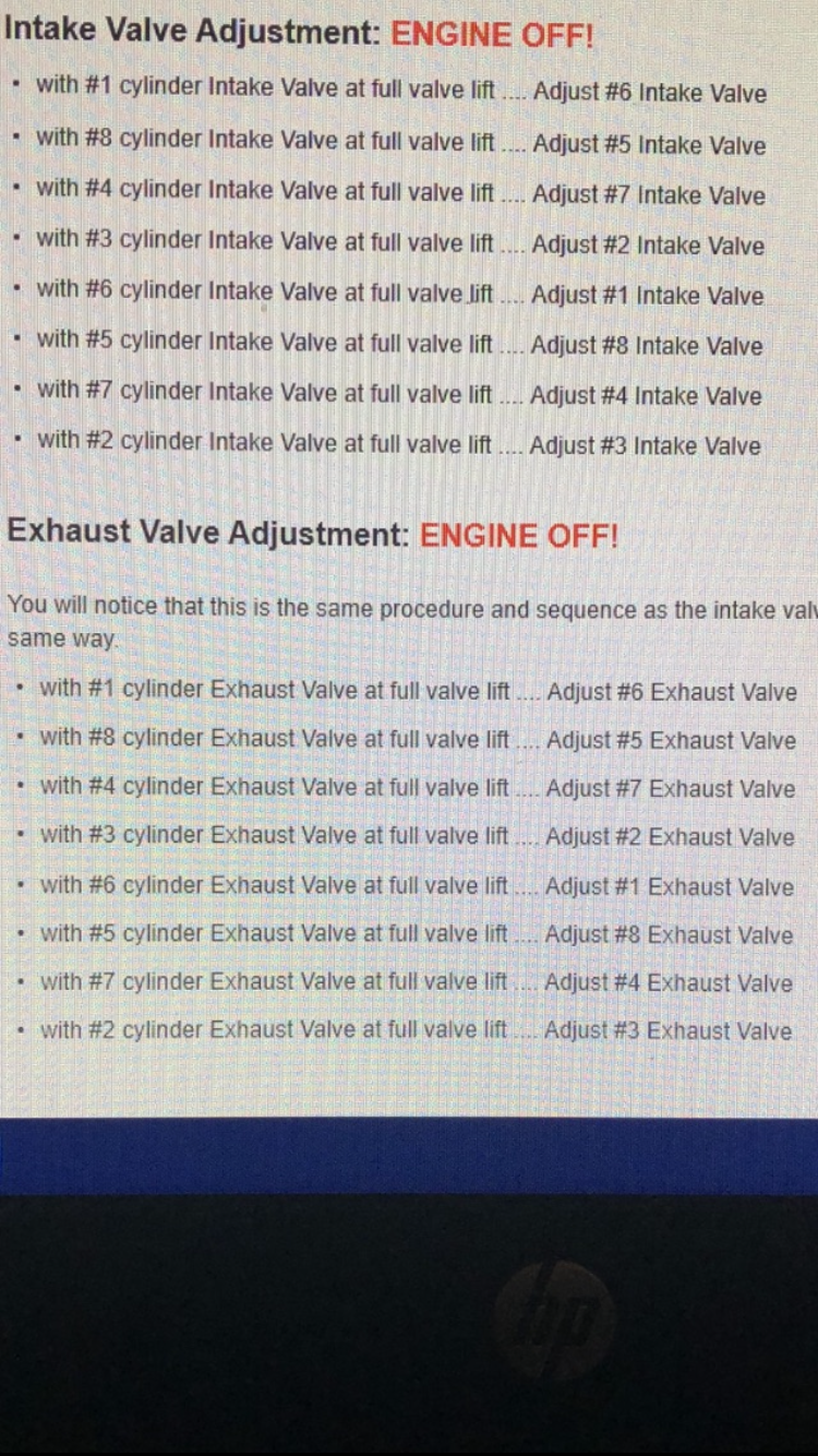

I used this method for about 50 years. TDC #1 compression stroke adjust exhaust #1,3, 4, 8 intake 1,2, 5, 7 bring it around to #6TDC adjust exhaust 2, 5, 6, 7 intake #3, 4, 6, 8. I adjust them between 1/2 and 3/4 turn after finding zero lash.

C2 of Year Finalist (appearance mods) 2019
Because all cams are not the same I was told to use this method

I've got a list like that but I get confused which ones I have done so I do one cylinder at a time.
