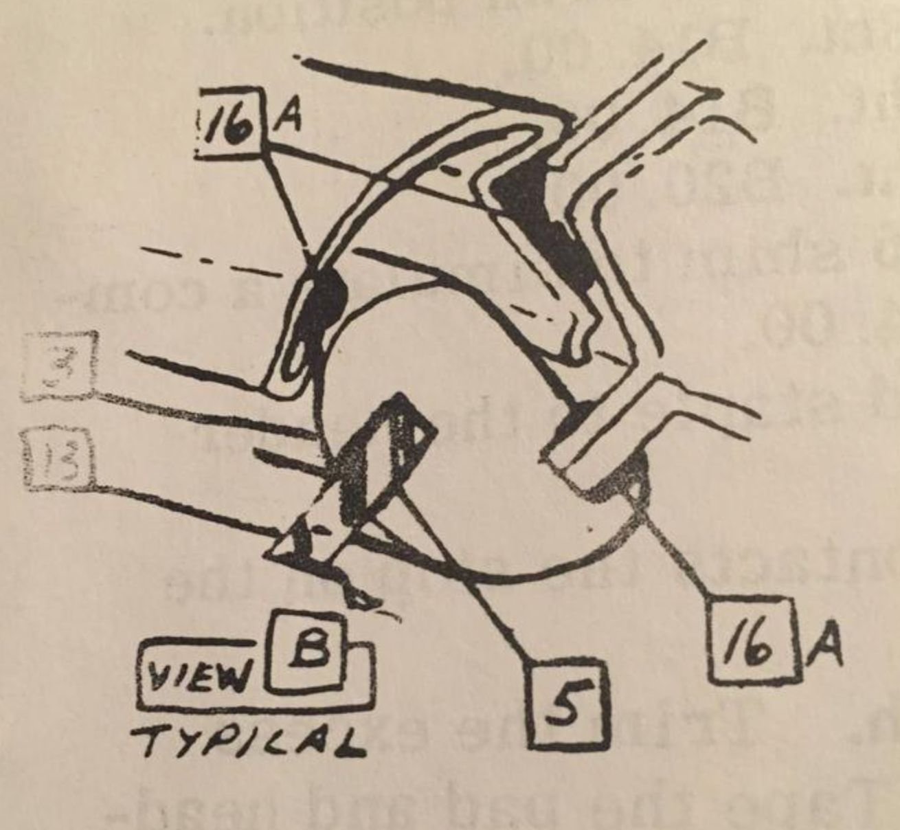

I don’t believe that is possible, although in full transparency I’ve never tried it.
The windshield is 5 and the pinch weld is 16. You would have to pull the string from the outside which would be difficult. Also, the there should be sealant in the gasket where the windshield sits. I suppose you could add the sealant later once installed, but that might also be difficult.
The windshield is 5 and the pinch weld is 16. You would have to pull the string from the outside which would be difficult. Also, there should be sealant in the gasket where the windshield sits. I suppose you could add the sealant later once installed, but that might also be difficult. Another question is where do you start the string? On other classics, I’ve always started at the bottom but some C2 Corvette restorers say starting at the top is easier.
