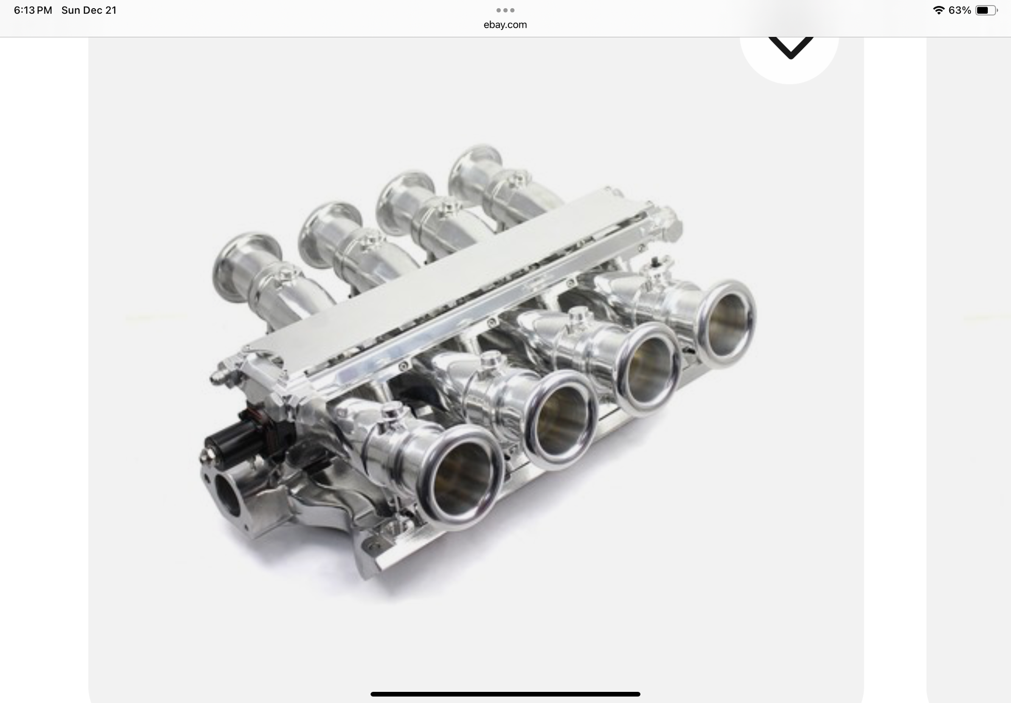

Does anyone make a side draft 8-stack, EFI unit like this ( Ford unit shown ) for a small block Chevy? I didn’t find one on a quick Google search.
