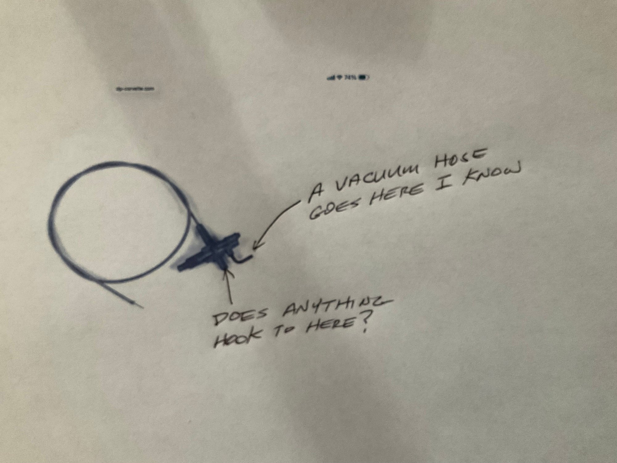

Maybe a stupid question but can’t seem to find the answer to. Can’t find the hose routing from the windshield wiper switch to the various components. Can’t find it in the assembly manual.
Can someone tell me what goes where from the switch?

This video may help with the hose routing:
Since the washer was an option, you'll find the hose routing in the AIM under FOA sheet 2.
You can download an AIM here:
https://www.carols62.com/60AIM.pdf
Tom

I apologize, I didn’t explain my problem very well. I don’t have anything hooked up to vacuum but didn’t think I had to, but maybe I do. When I twist the ****, the wipers come on. But when I twist it back the **** won’t move and so I can’t shut it off. Does vacuum need to be connected? Is the switch bad?
