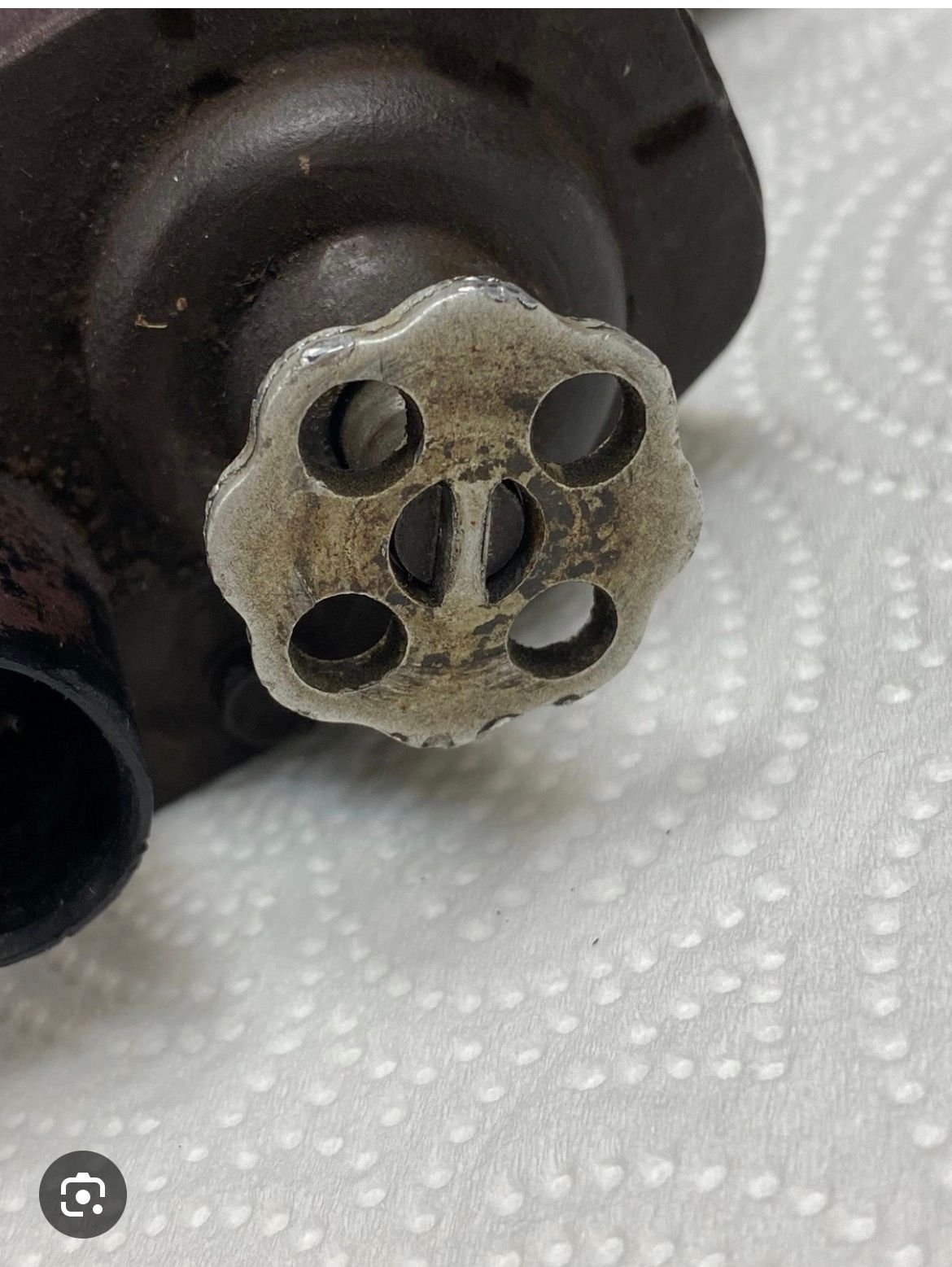

Thanks for all the input. She is a 67 convertible and I live in New Orleans. Big problem is I can't find the wheels to manually open the lamps. The end of the shaft (that I can feel and see with a camera) seems to end in a 3/8 nut with no wheel. Worried if I remove the hood might have trouble getting it aligned.

It could be missing

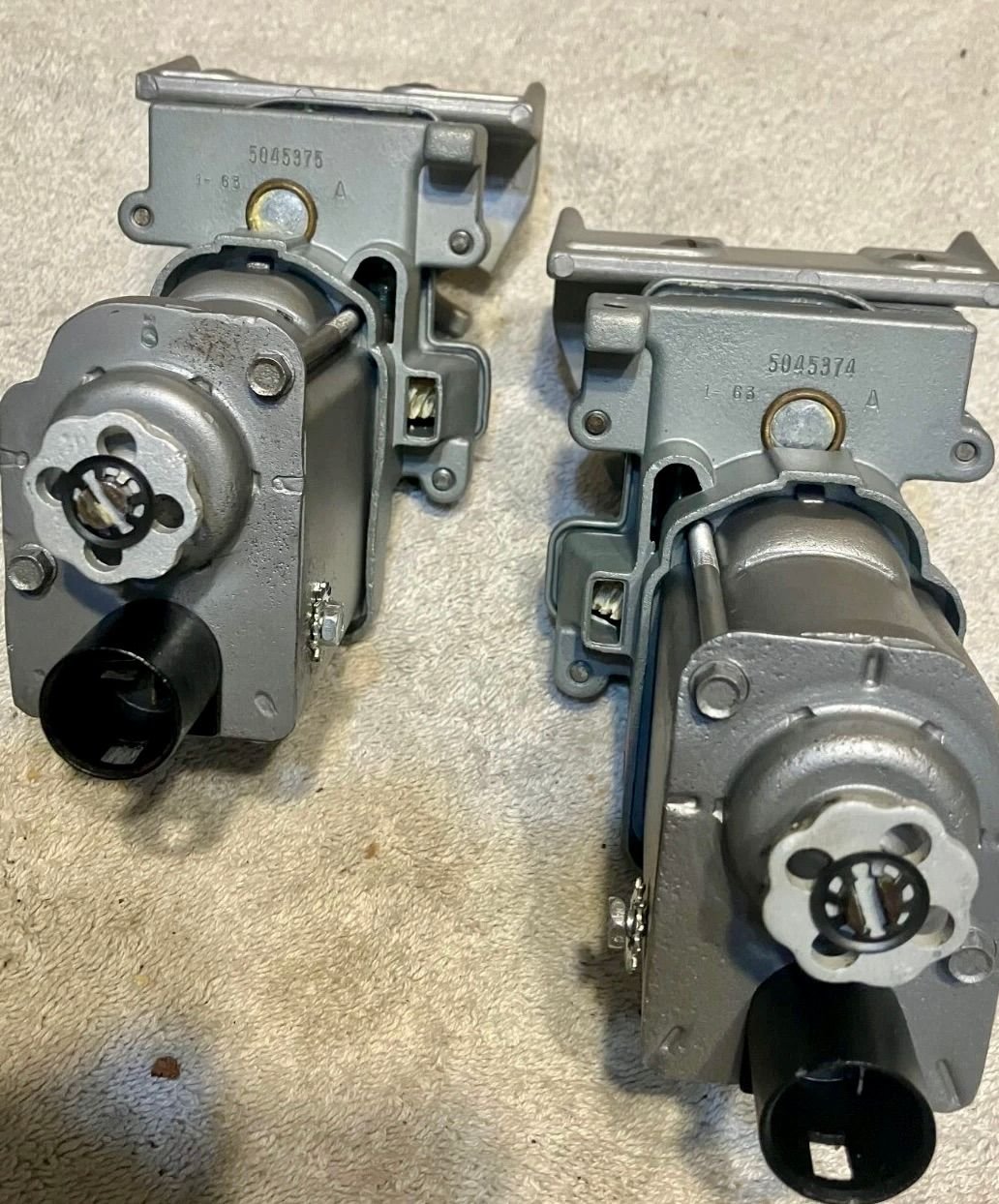

here's a little bigger photo of the wheels on the motors.. And the hood does not need to be removed to remove the motors.. It can be done in the space between front of hood and back of upper nose with hood up, though it is tight.. If you unbolt the hood support assembly from hood, you can raise hood vertical and tie to garage rafter to give yourself a bit more space.
