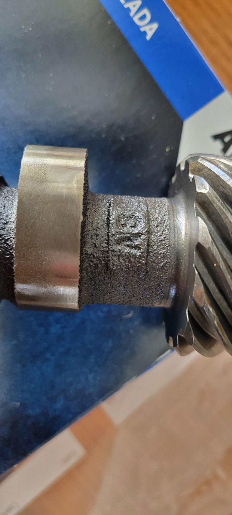

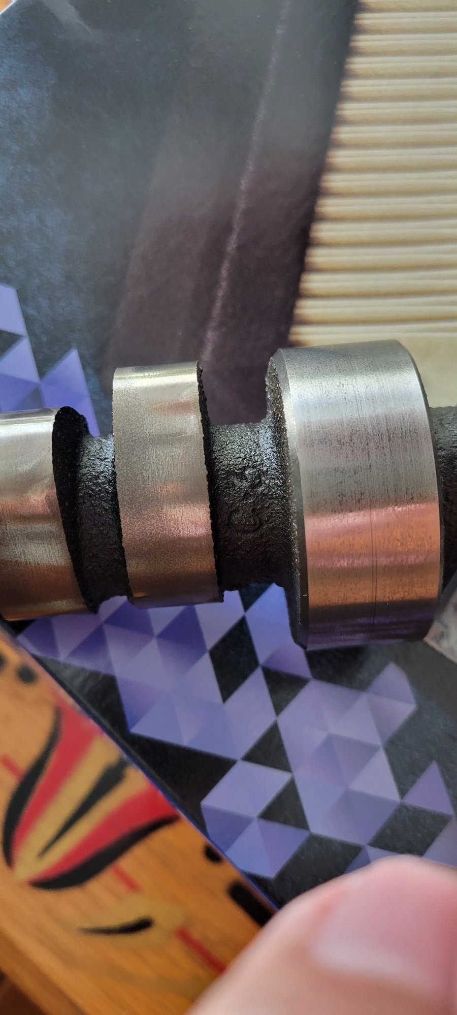

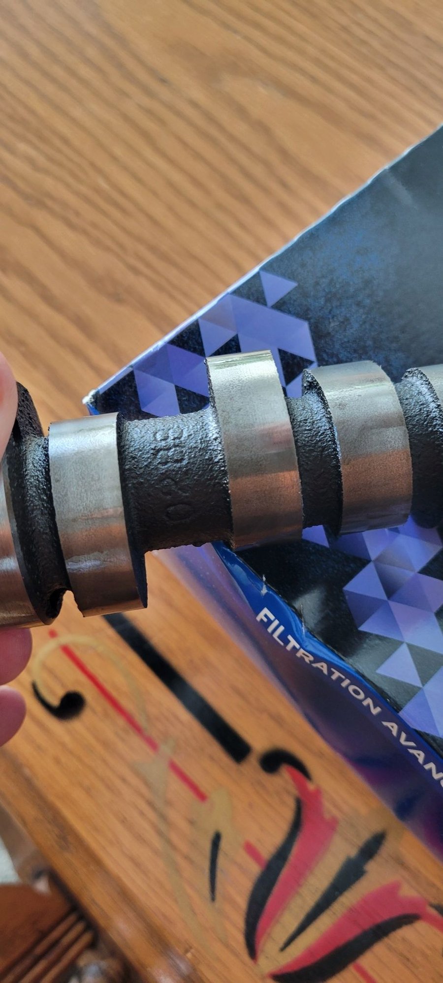

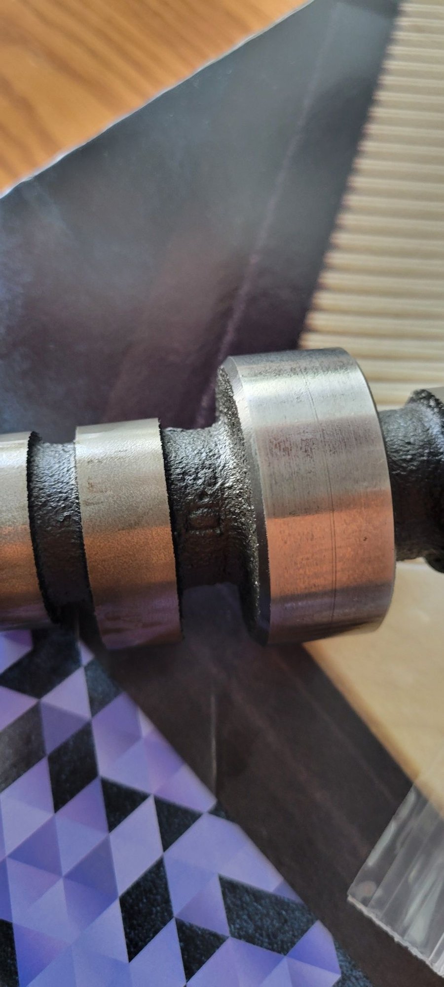

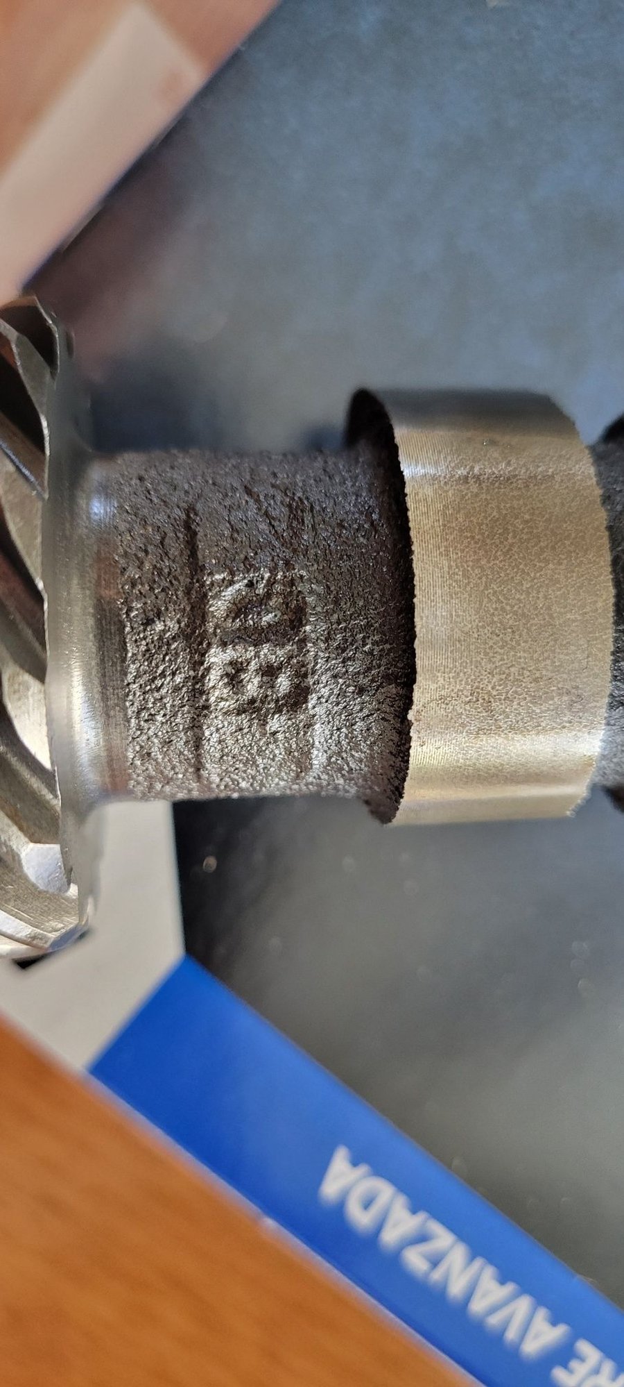

Removed from my non-original "L76". It certainly has all the running characteristics of a 30/30, I just cannot figure out the manufactuer.

This is a WAG. If the letters one it are RB, my guess is old school Racer Brown. Dennis

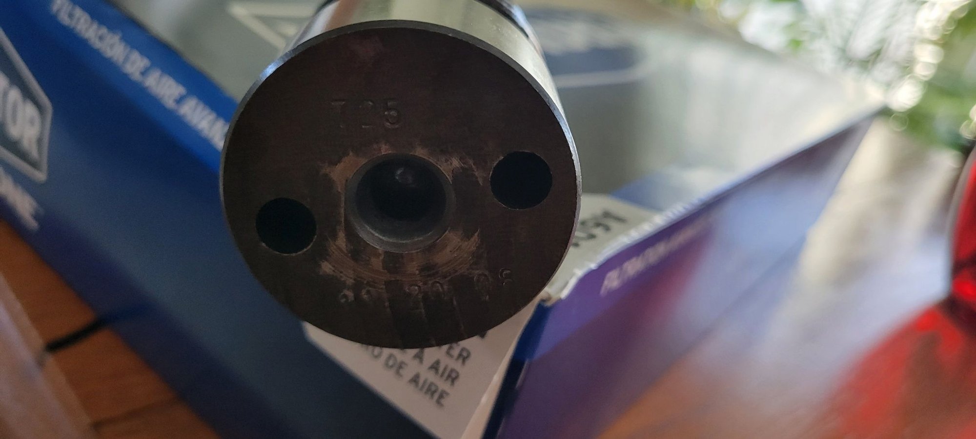

I have seen Racer Brown cams before....but they were stamped at the end of the cam. Mine just has 725.....and what I am assuming is a date.

With the cam out of the engine , a competent machine shop should be able to determine the lobe profile and give you a clue to ID it .

Looks like it’s in good shape. No idea on whose it is.
No doubt, but I have no use for it...so I'm not paying a shop to measure it just so I can sell it. I reckon I'll just seal it up and put it on the "don't throw away" shelf.

You can determine the cam profile with a dial indicator and degree wheel. Not rocket science, put it in a block and put a lifter on the lobe and turn the cam. Record the lift and duration of each lobe to determine if it has any wear. You could always put it in a lathe and check it also. Might be worth saving, might be junk.

Figured it out. My uncle wasn't the most organized guy...but he kept docs...despite being buried.

Look at the valve spring spec. No wonder so many engines with aftermarket cam kits wipe the cams quickly or during break in. The Chevy springs used for the same 30-30 cam (and LT-1 cam) had a closed spec of 80# and open spec of 200# and ran at 6500 rpm without an issue. The Crane springs have more than 50% greater spring force than required for the same cam as GM 30-30.

Yes, and 254/254 degrees duration at .050” lift in a SB. Thats a pretty rowdy cam for the street I suspect.
