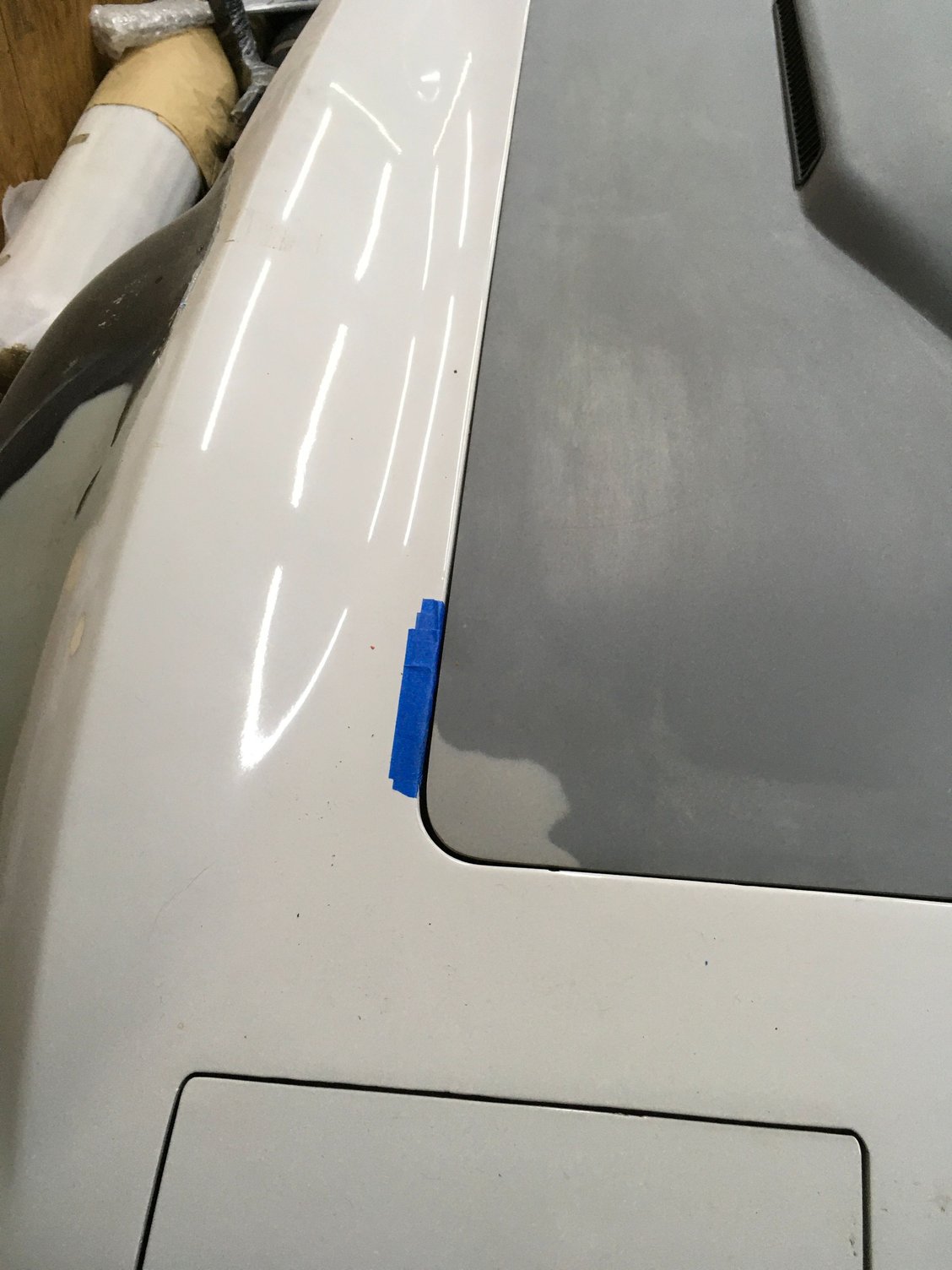

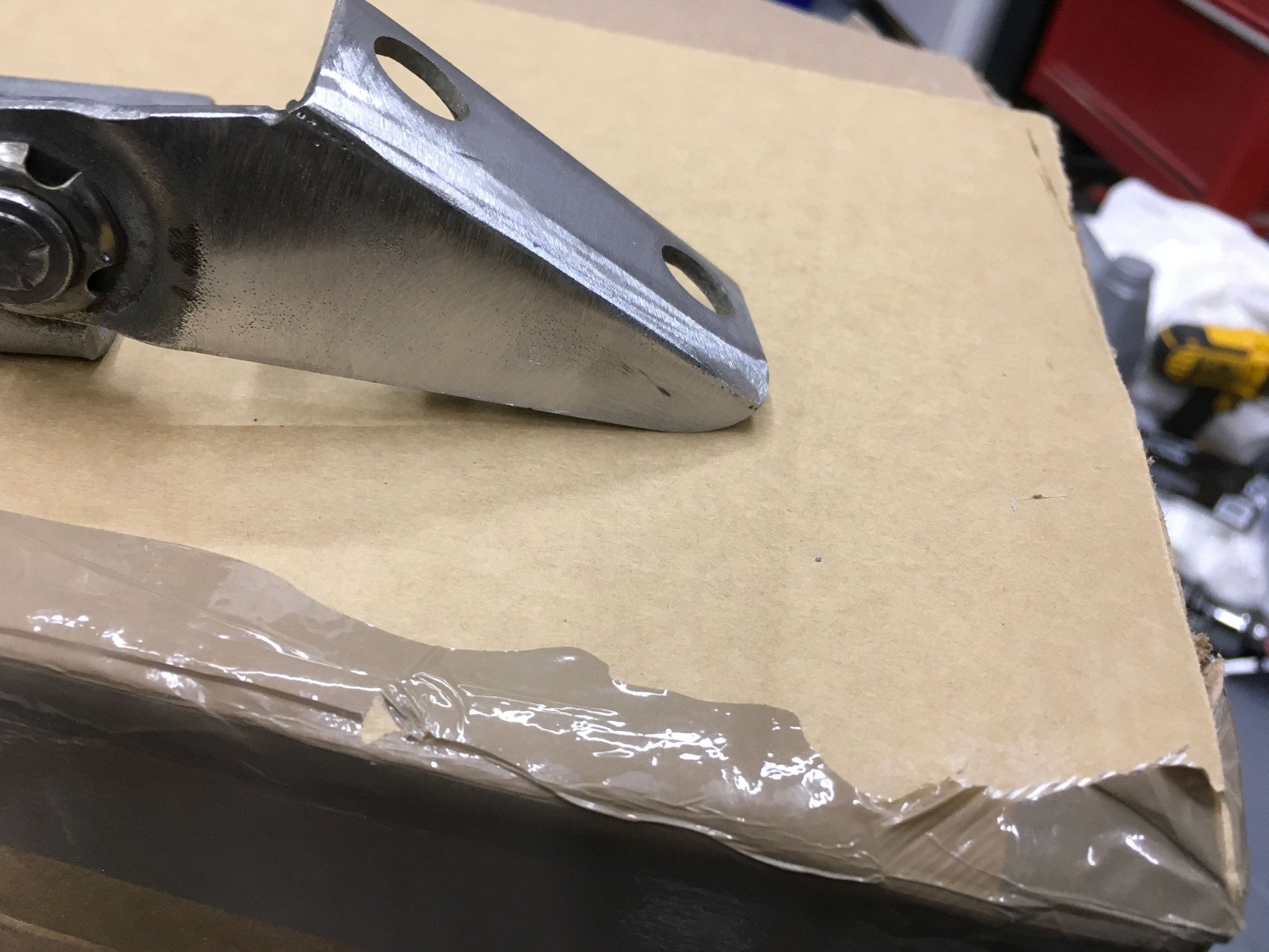

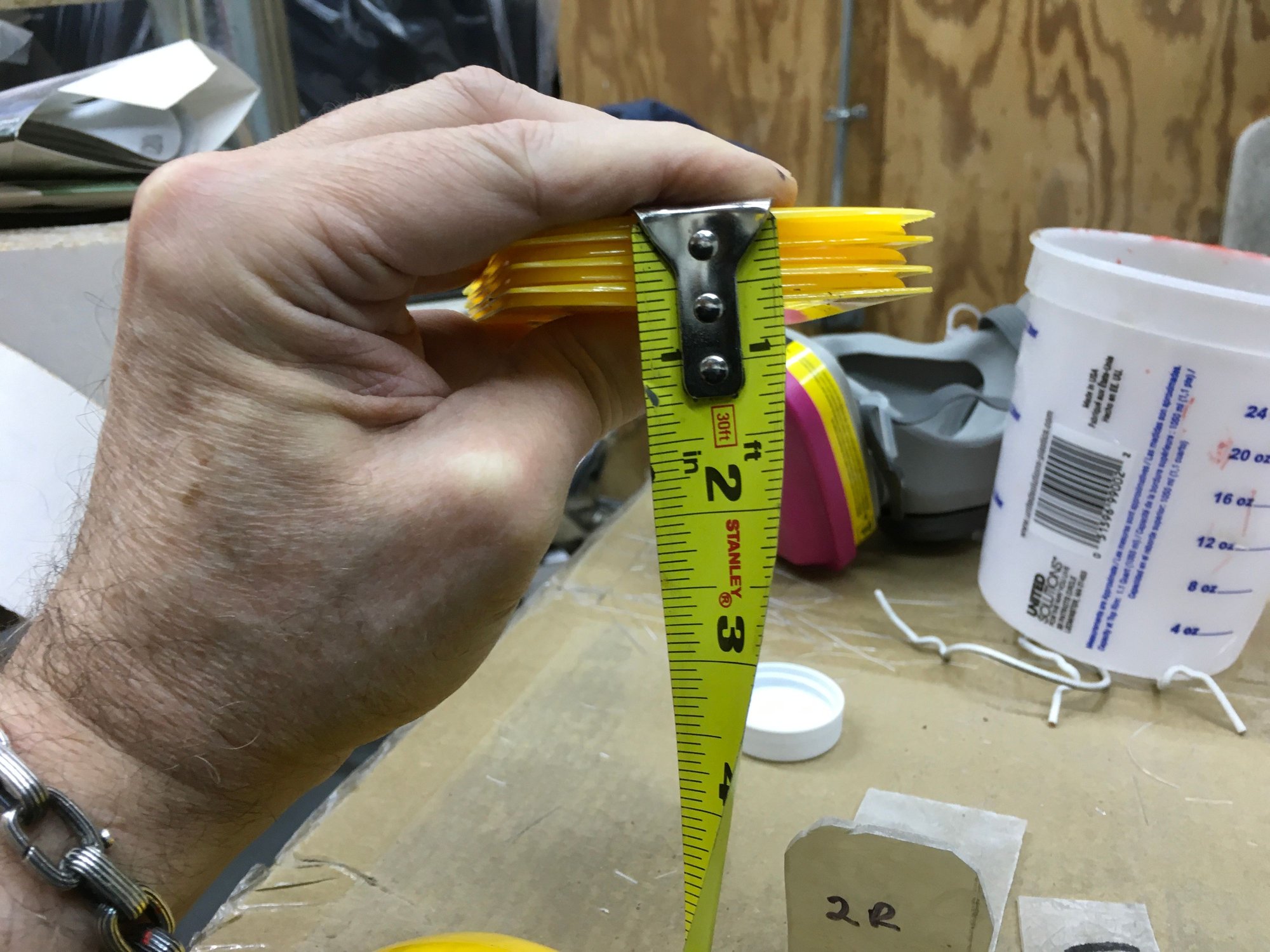

Common problem. I finally just sectioned a hinge by 3/16”
Sat what turned out to be 3/16” too high
I used a stack of body filler spreaders to determine the proper height
How much I had to section

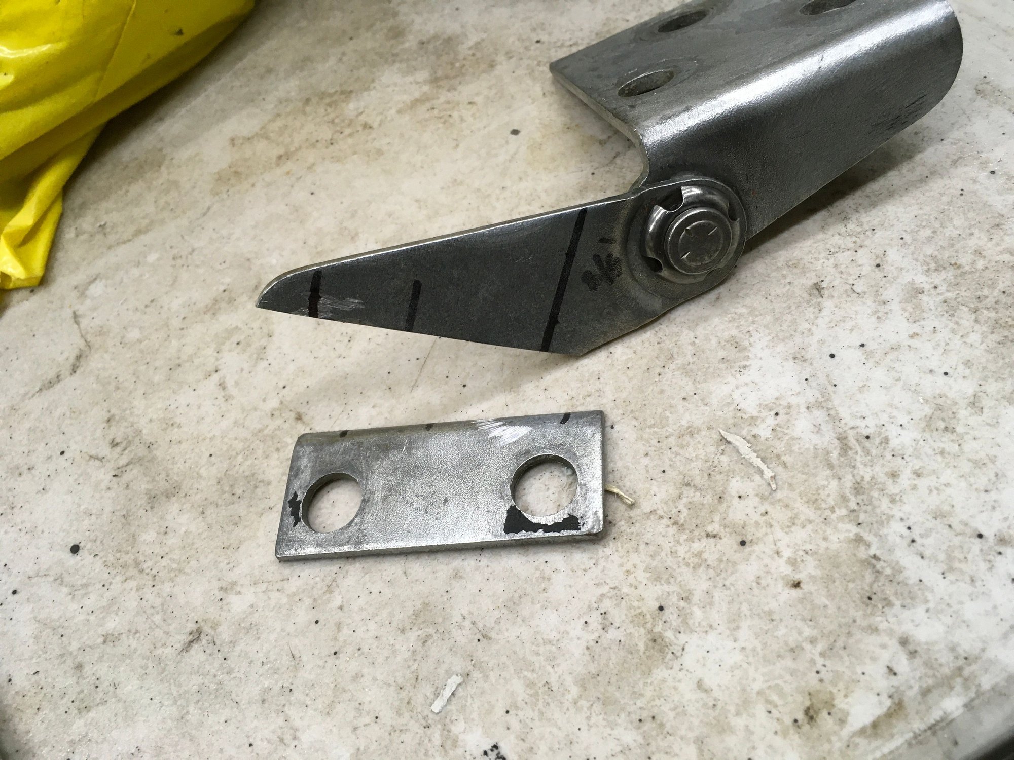

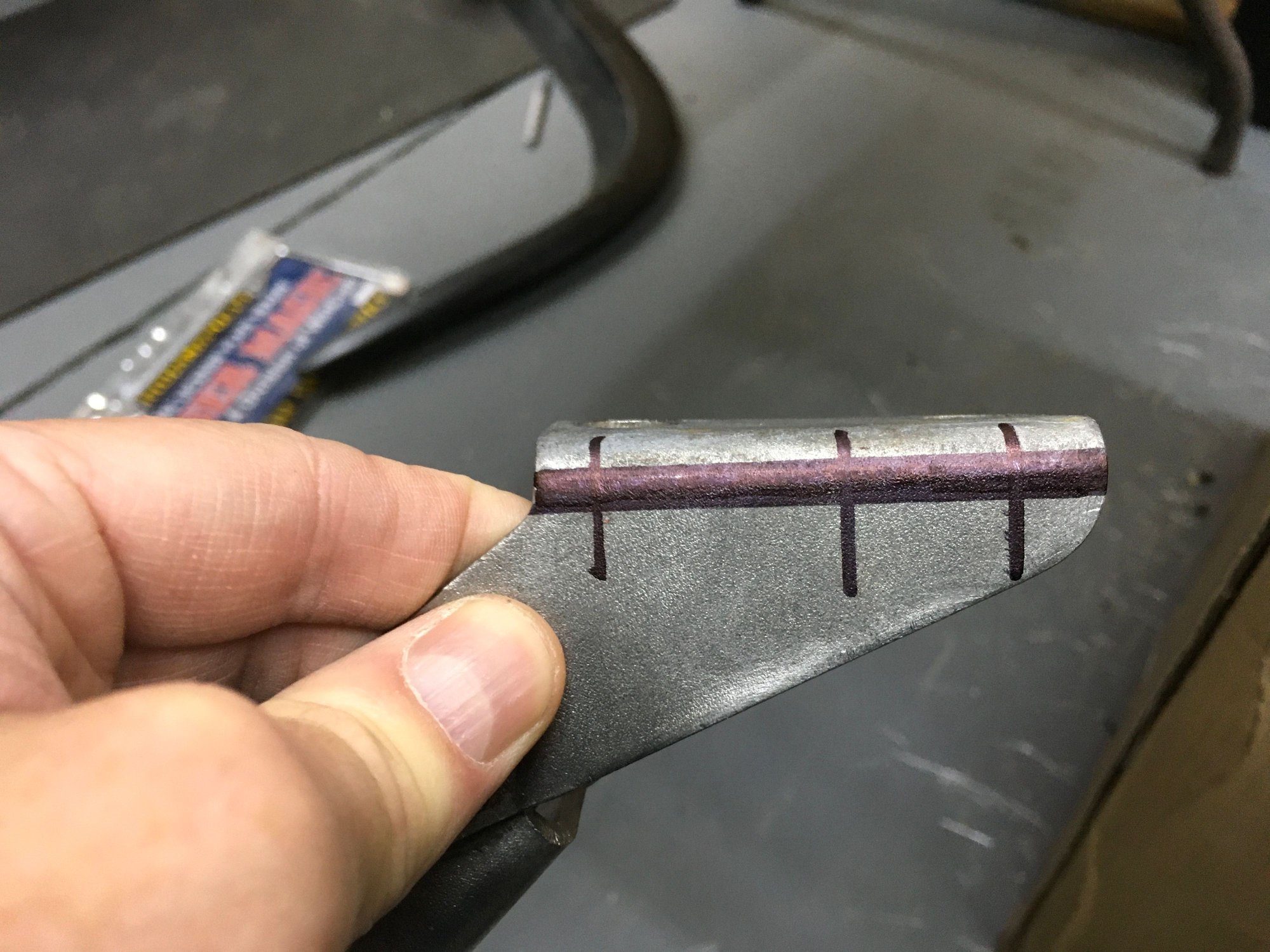

Marked with index lines
Sectioned…
Sectioned…

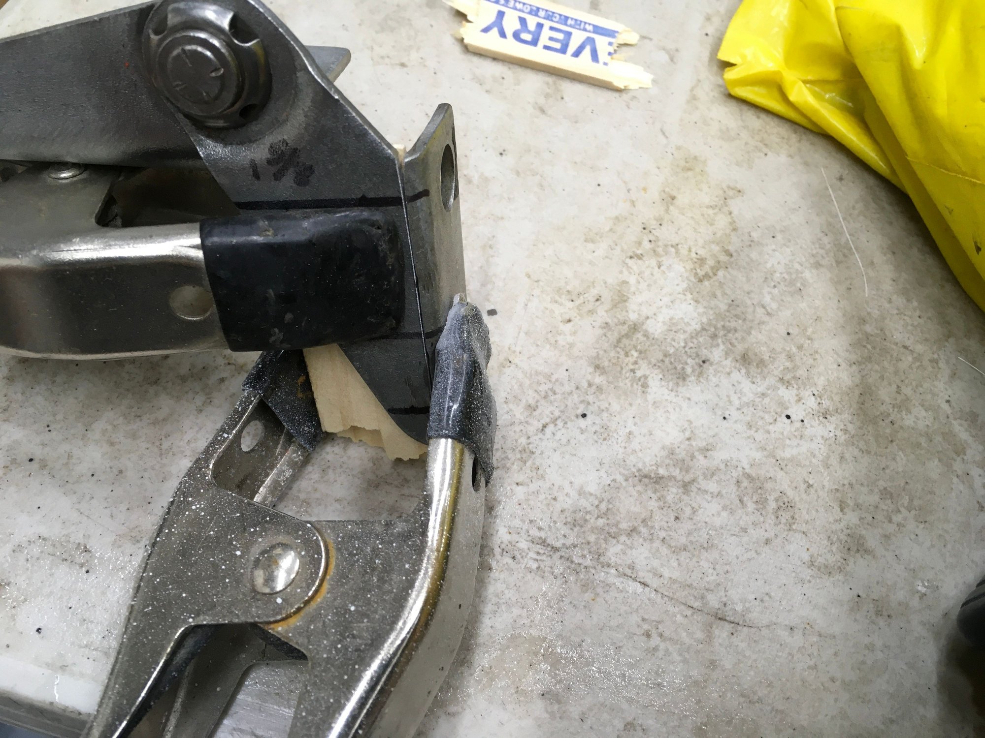

…clamped…
…clamped…
…welded and ground
…welded and ground

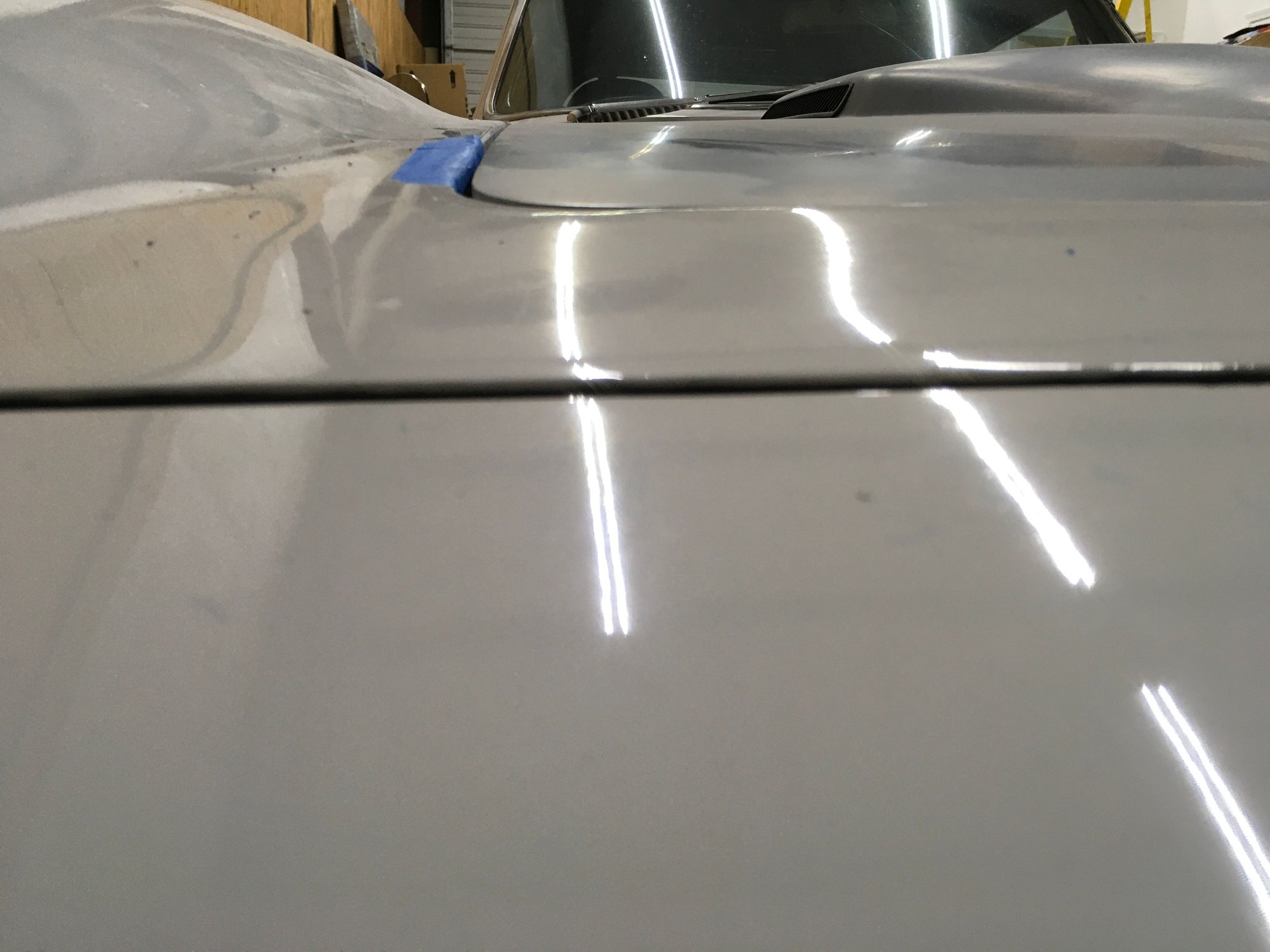

It’s now perfect
It’s now perfect
