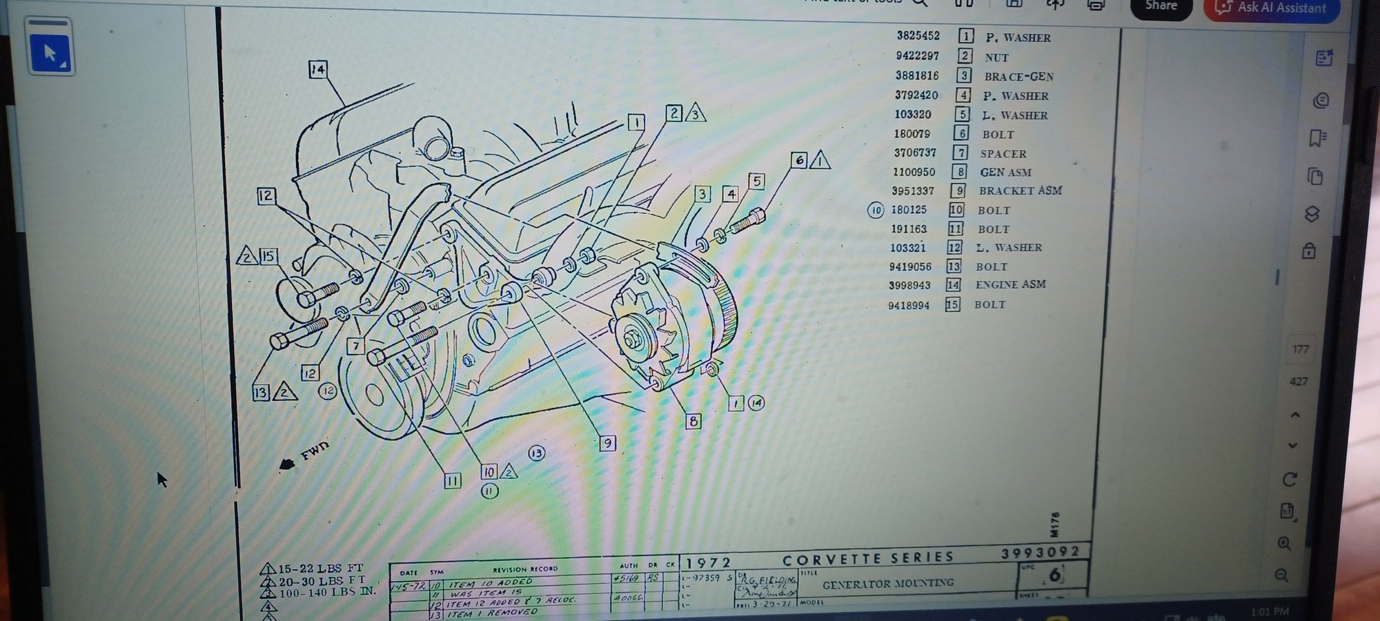

All,
I'm hoping someone can confirm the torque spec for the bolt that holds the alternator brace (bracket) to the block (water pump). The AIM calls for 20-30 IN PNDS. That doesn't sound right. The 66 shop manual calls for 30 FT PNDS for water pump bolts. Is that a typo in the AIM? Can someone confirm please.
Thanks in advance

Rob, It's got to be a typo, a 3/8 course bolt has a torque spec of 30-35 ft lbs.

My 72 shows foot pounds. I'm sure it's the same for your 66.

Thank you all. The 72 AIM looks almost exactly the same as my 66 ... other than the typo.
