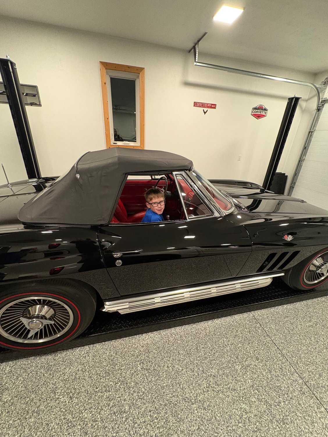

I just took delivery of a 66. Red leaking fluid passenger side front between wheel and oil pan. Anyone else that has had this please provide advice on what the fluid could be and possibly where it is leaking from. It is driving me nuts because I just got the car delivered yesterday. No power steering car and manual transmission. Picture for attention

If the coolant is Dexcool, it may be overflow out of the Expansion tank if it was overfilled. It appears to be a smallblock based on the side emblem and no BB hood.
BTW. do NOT open your garage door when it's up on the lift. Looks like it'll hit your roof.

Beautiful new toy, to go along with your other toy. My suggestion (no guesses) is to put move your other car out of the way and when the "new" car starts dropping red fluid, use a plumb bob from the drop on the floor up to the car and you'll know exactly where it's coming from...you should find it fairly quickly. Having a life will make this a fairly simple task. Enjoy your new classic...which, by the way, they all leak a little
