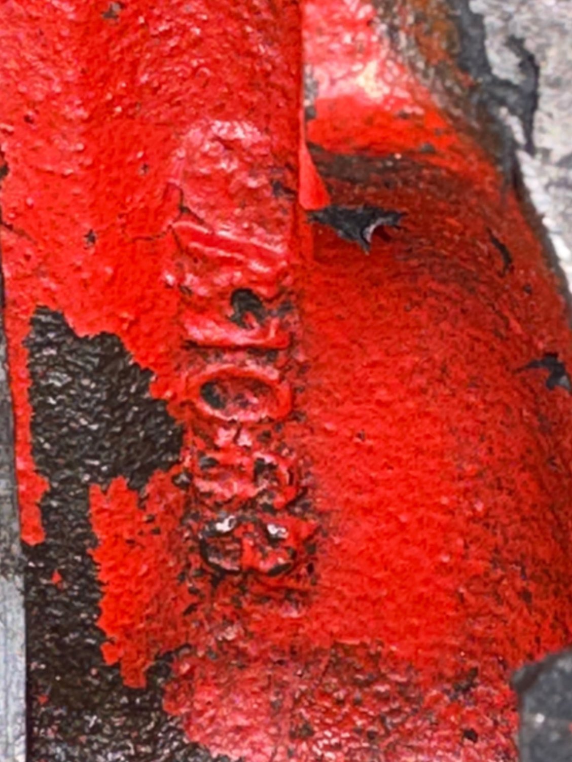

I have a 63 convertible with a replacement block. The block is the correct casting number for a 63. Below is a picture of the date code. Can someone help me with the date. Thanks.

Jan 10 1963?
year hard to make out.
Assembly stamp and suffix?

Looks like A 10 3 to me, also.

Probably not a Flint corvette block. Tonawanda blocks used a different date format. Does it have the 1/4 inch plug above the timing chain cover?

It looks like A1063 which be a Tonawanda not Flint block.

yes I believe it is a Tonawanda block. Like I said it is not the original engine. I twas replaced sometime in 2000.

if it's a Tonawanda block the block casting numbers will be smaller in height also.
