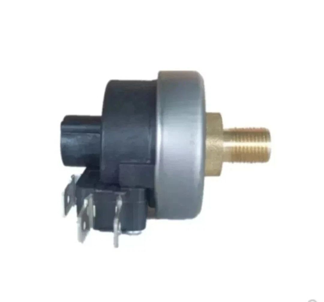

I have none of the parts for the windshield washer system for my 61 except the nozzles and the wiper switch. I do, however, have a universal electric washer pump and reservoir kit that I could install but it can't use the existing wiper/washer switch. I'd have to install the supplied operating button on the dash.
Does anyone know of a vacuum type switch or relay that would activate the washer pump using the existing wiper/washer switch?
Alternatively, is there a replacement washer system kit made for my 1961?

No replacement kit I know of. I like your idea though.
Maybe this vacuum operated switch. Here
You would plumb the output of the dash button valve tubing to this switch. It's a SPDT switch so you'd bring fused power in and run the output to your washer pump.
The switch specs are in the eBay listing. It might be a option.
If you're washer coordinator up at the motor is still good you could have that Tee'd in the vacuum plumbing to turn on the wipers when the washer pump runs, similar to original operation.

Thanks, I just ordered a vacuum operated electrical switch like @rich5962 mentioned. I'll test and see if it's functional.
