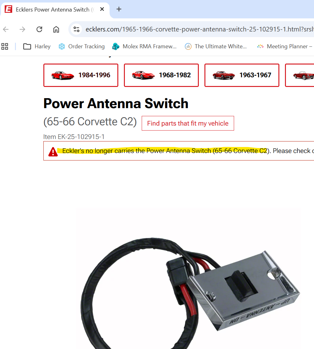

That must have been the last one at Eckler's.....I don't see any vendor that has the switch. They all show discontinued or out of stock.
No one sells these new any more. I tracked down the actual manufacturer of these and they said they stoped making them about 12 years ago.

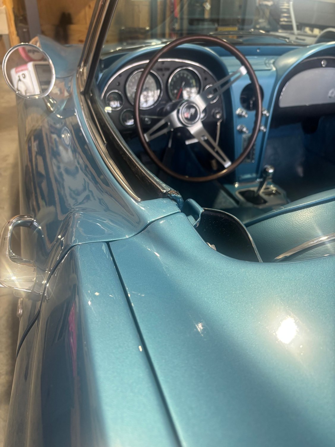

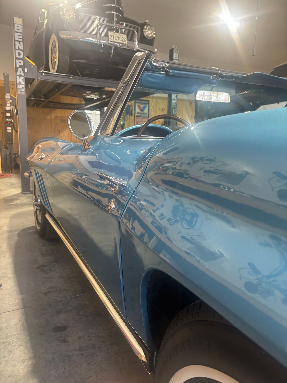

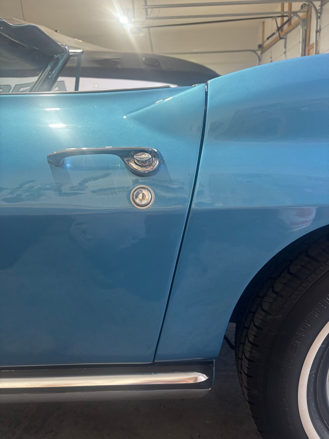

Originally Posted by jim lockwood
I hope you are right. Taking a second look at your pic, it still looks like sumpthin is very wrong.
Since the hardtop has been in storage for 9 years, I strongly suggest you make no adjustments to anything until the top has been on the car for a cuppla weeks. If it has warped from storage, it will return to its correct shape if you give it time. (That's first hand experience talking.)
Once the hardtop has recovered as much as it's gonna do, then you can start investigating adjustments.
Door gap pictures as requested.

Man...I wish my door gaps looked that good. Very nice.
