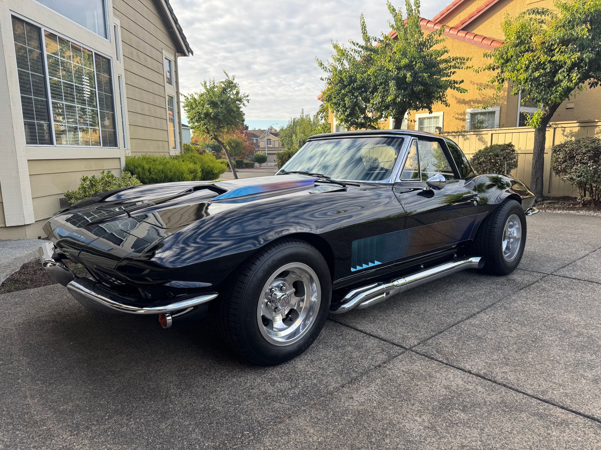

I have a 1966 Corvette Convertible with the hardtop installed. The problem is that the passenger side window glass is not aligned correctly,
(see picture) I’m looking for information on how to properly adjust it. Thanks all!
Hopefully you can see that it’s opened on the bottom. Fits well on top

On to the window, once you have the door panel off, the various attachments were originally sealed up with body-putty but good chance that's gone now.
There is a short stainless channel on the inside of the door, about where the armrest is located and the two 1/4-inch machine screws pass through slots on the inner door skin.
I've done two of my midyears in the last year or so and I wish I could tell you...'move this screw in the up/high position or down at the bottom of the vertical slot' but memory fades with time.
Suffice to say, it might take a little playing around to get it right but all the adjustments are on the inner door skin. Good luck and Great looking Bigblock.
