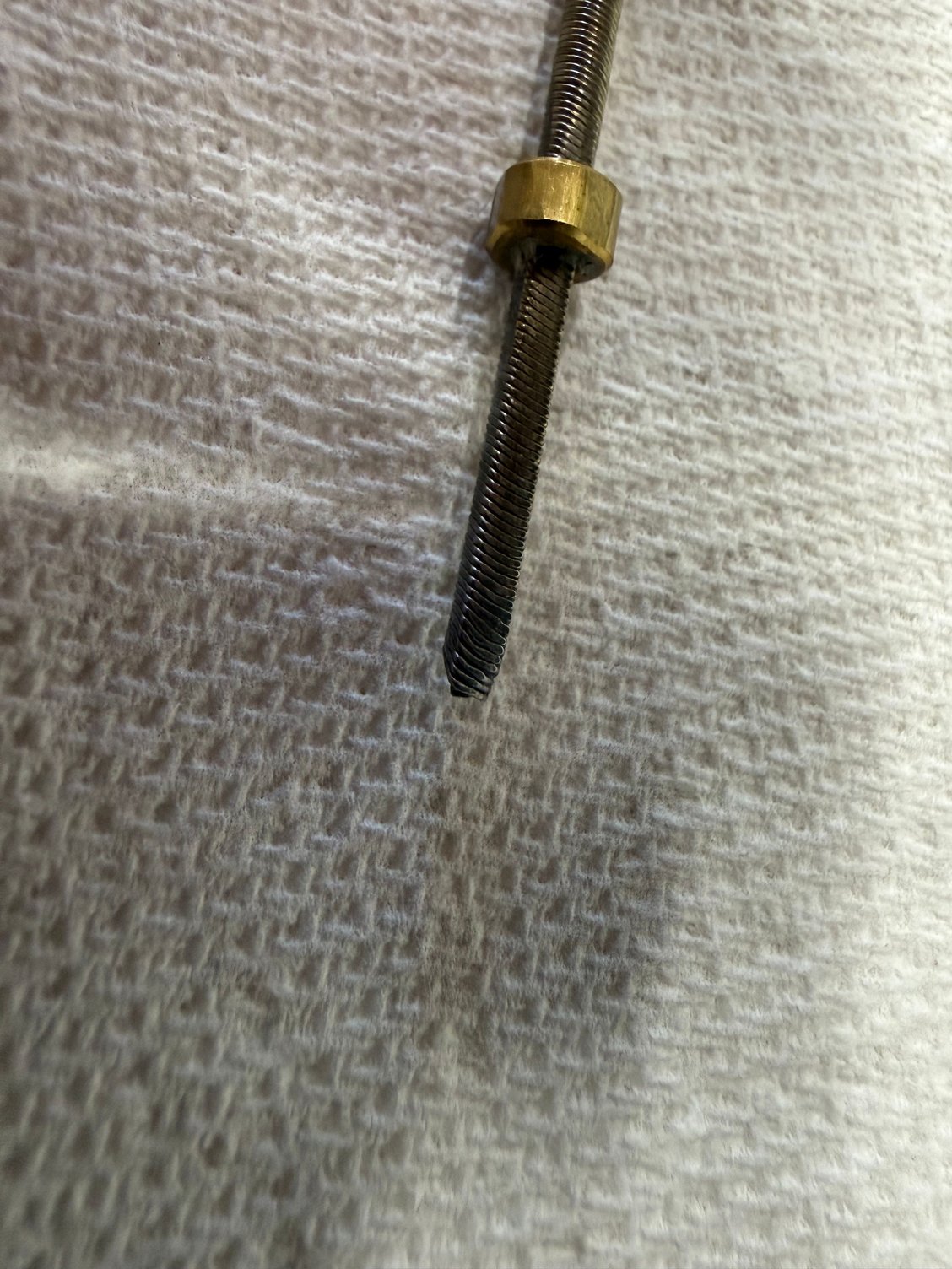

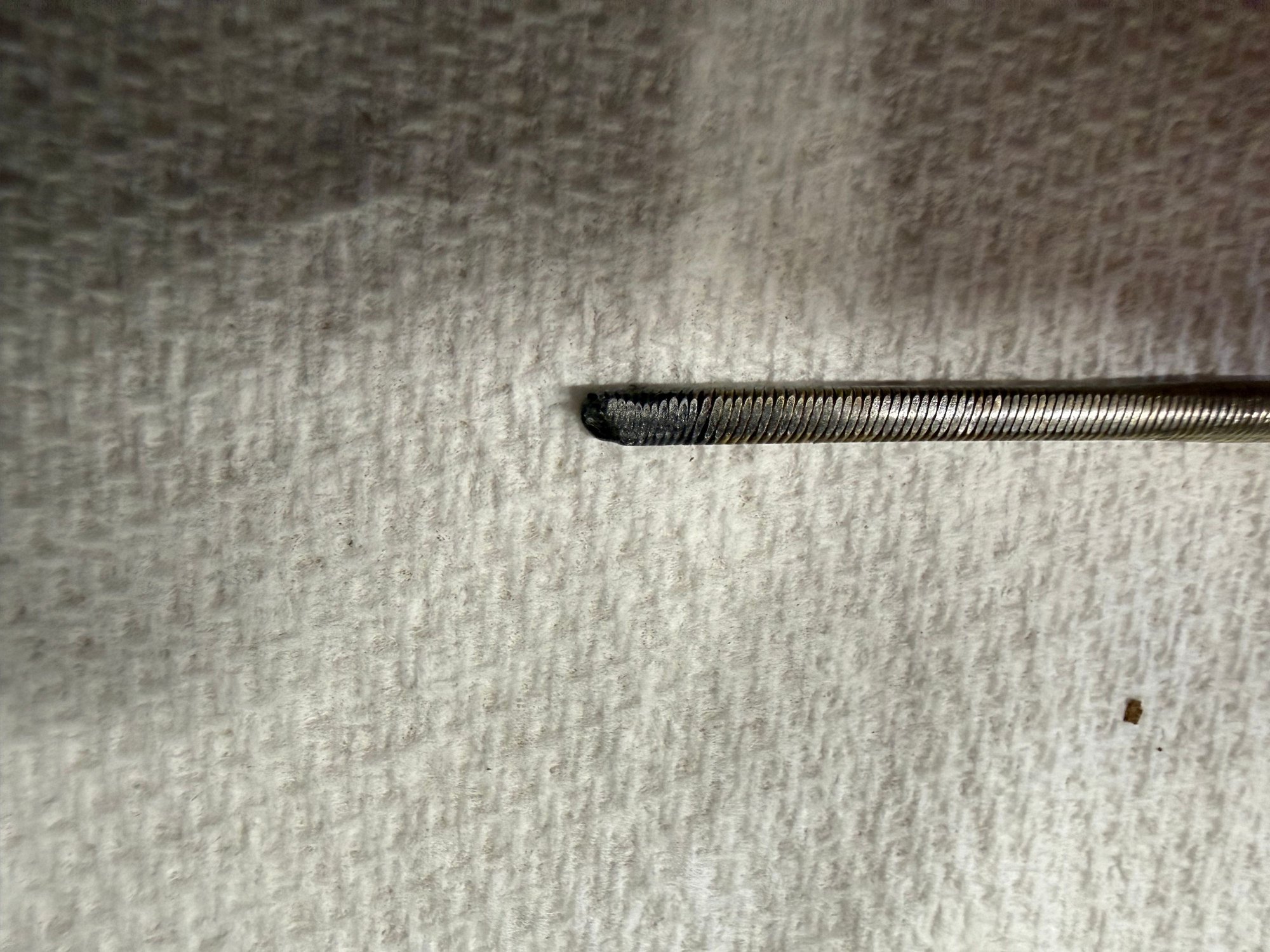

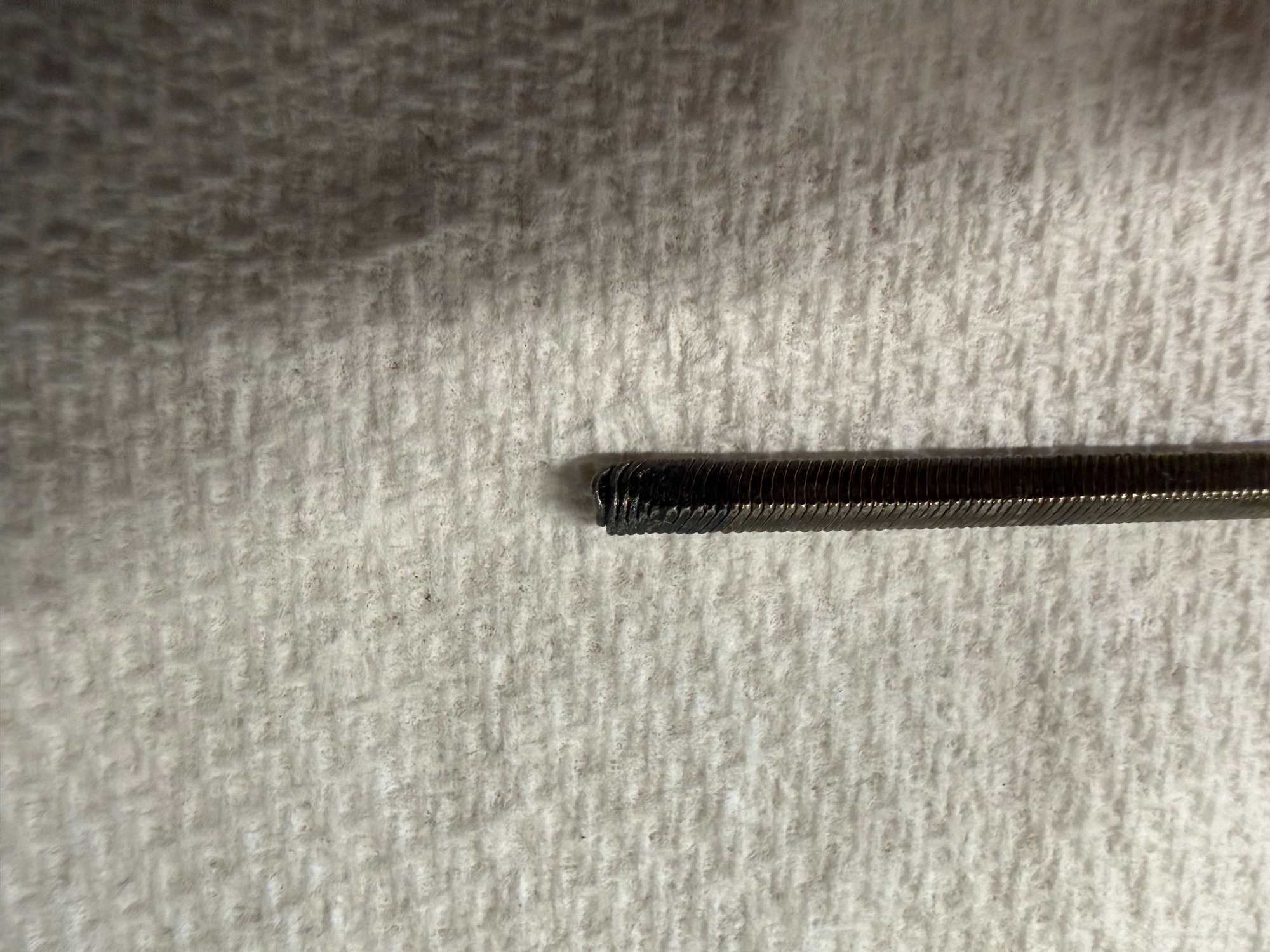

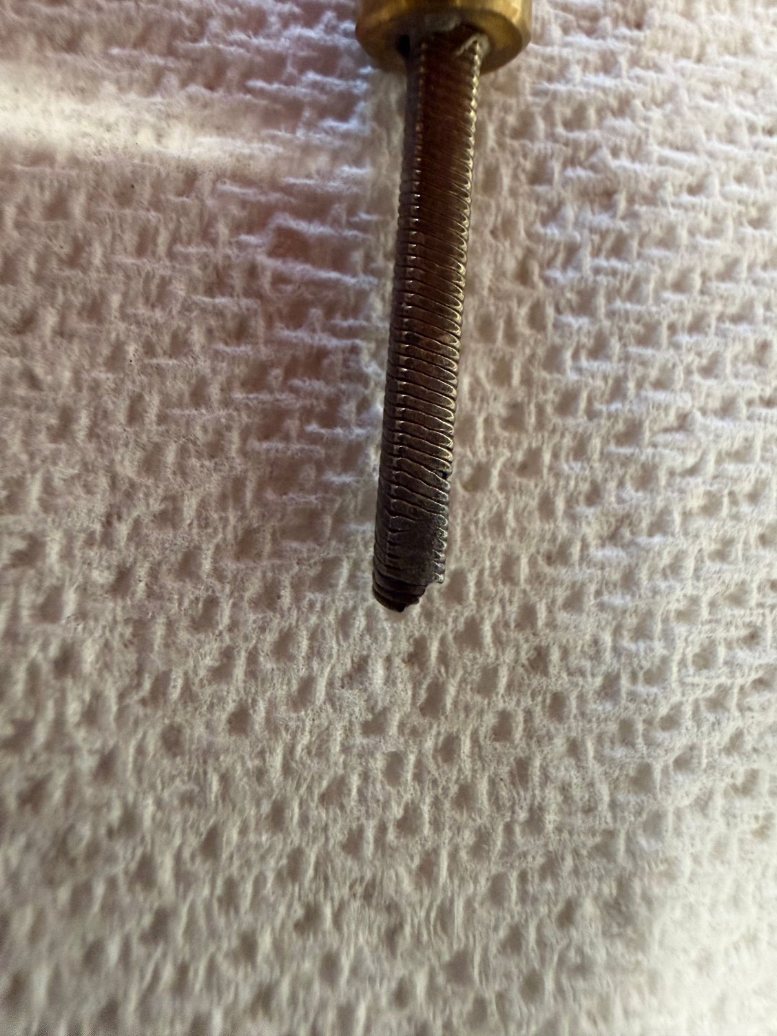

Thanks for quick response! Here is my current situation. My cluster is out and getting restored. I pulled the inner speedometer cable to clean and lube, but cable is not square at either end and looks worn. In addition I have a 70” cable which is not correct so I figured to be on the safe side I would just replace the entire cable and go with the correct 56” from Speedometer Cables USA. Just took a look under the car and saw how tight it was. I guess I could always install new cable into cluster and take car to shop to handle the swap at the transmission? See pics below. I’m overthinking the condition of the current cable?

That cable does seem to be square at the ends. The cables are pressed to a square shape to fit the female connection at the speedometer and the transmission. The problem is when you reinsert it into the sheath at the speedometer without the transmission end disconnected you may push the driven gear into the tail shaft and have to install a new driven gear.
