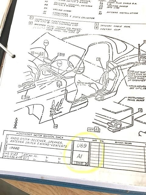

Nowhere man. When you say AIM manual are you talking the same as the Corvette America Assembly manual. It has a break down of all the parts number but I do not see any pages reading RPO U69.Please explain.TY
Assembly Manual pagination labeling uses the UPC ('uniform parts classification'), not RPO ('regular production option').
Copy that. Thank you....
The AIM is the Assembly Instruction Manual. What you say you have sounds like you have one. U69 is the option code for the AM/FM radio. All options are addressed in the rear of the AIM...in alphabetical order. U69 is at the very end of the manual.
