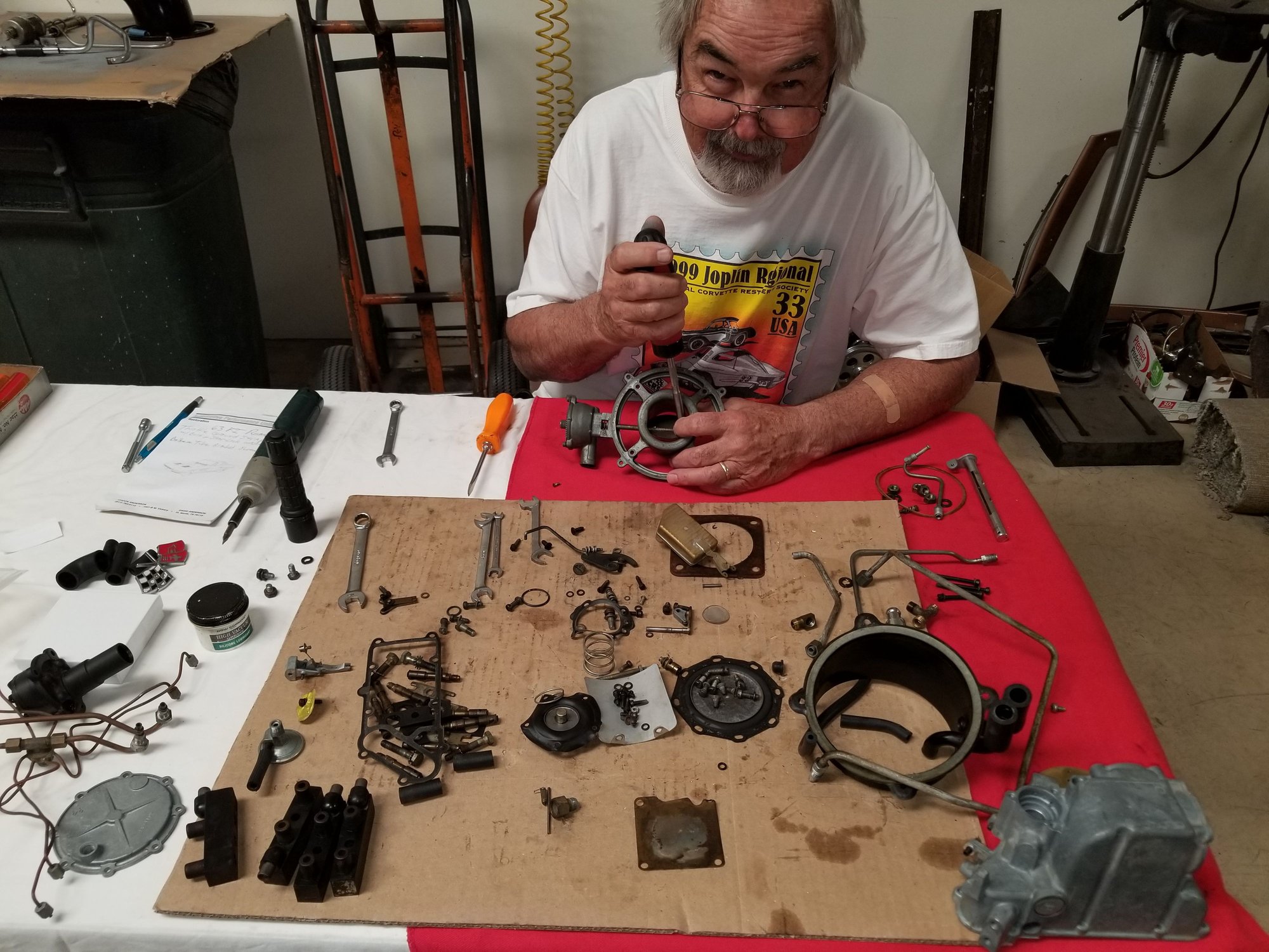

Good work Chuck! They are very complicated and delicate instruments, with lots of small, fragile, moving parts. Here is my FI guru, Bill Wilhelm, doing one of mine a while back.....
