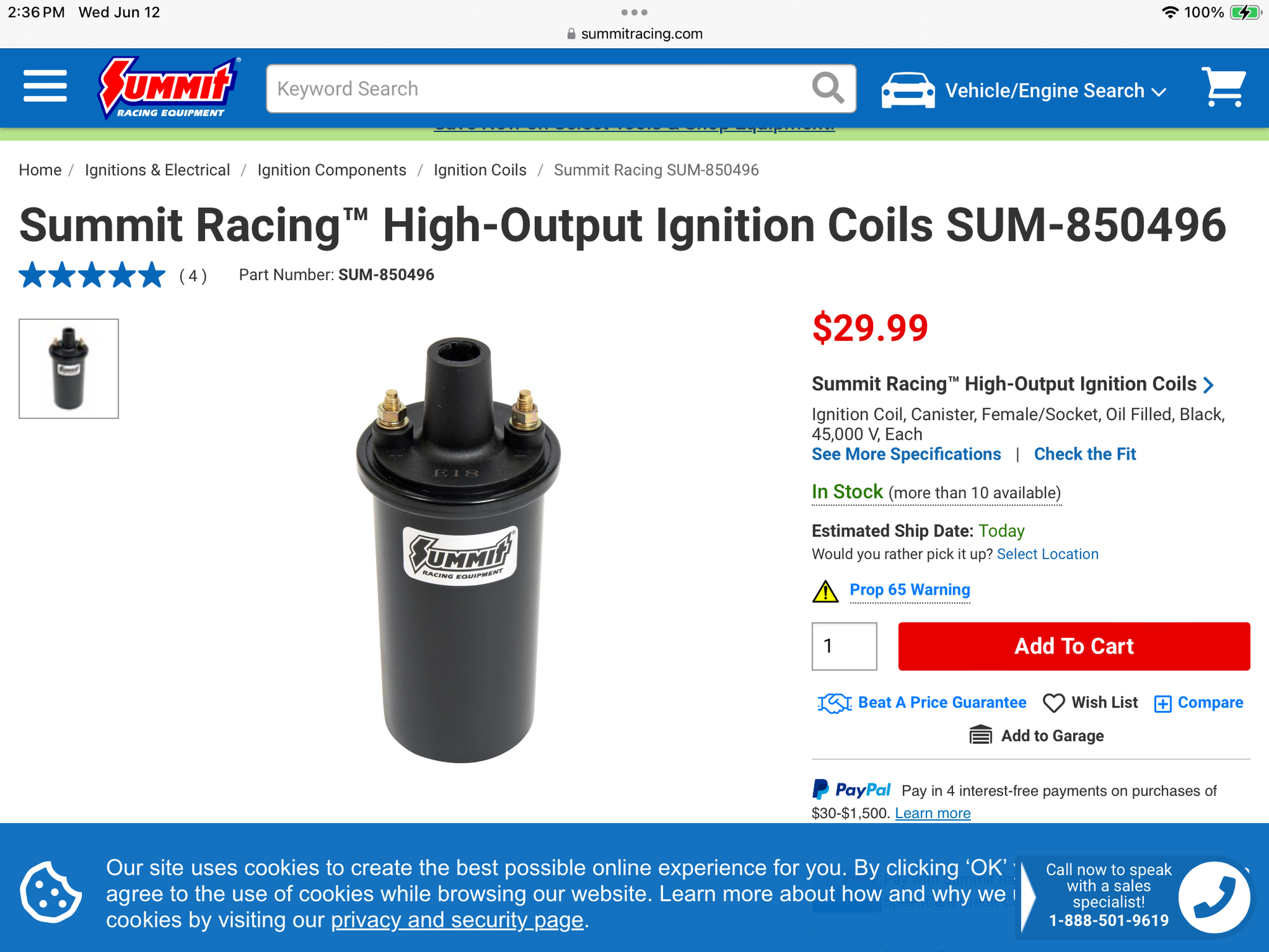

Question….owners of TI big block cars…..what replacement ignition coils are you using. I’ve upgraded the TI box guts to the newer solid state components if that makes any difference. Distributor and plug wires are OEM L71 components.

I’ve been using a cheap Summit coil that meets the TI coil resistance specs.

Guessing no issues on yours huh? I’m using an original Echlin IC12 and the upgrade is in the TI amplifier box on the radiator support. Having an issue with the car shutting down and I’m suspicious of the coil overheating. I do have an original 207 coil but I suspect that gets cooked to. Gonna try running the car with the lid off of the coil box ignition shield.

Runs good. Several others on here use it too, or carry it as a spare. My car has the upgraded amplifier board in its box too. If your car restarts after the coil cools down (might try putting a damp cloth on it when it happens) then it’s a good chance it’s the coil. I’ve had issues in the past with internal board grounding (I believe) but since working on that it’s been fine. My car would start on the key but die as soon as I released it.
